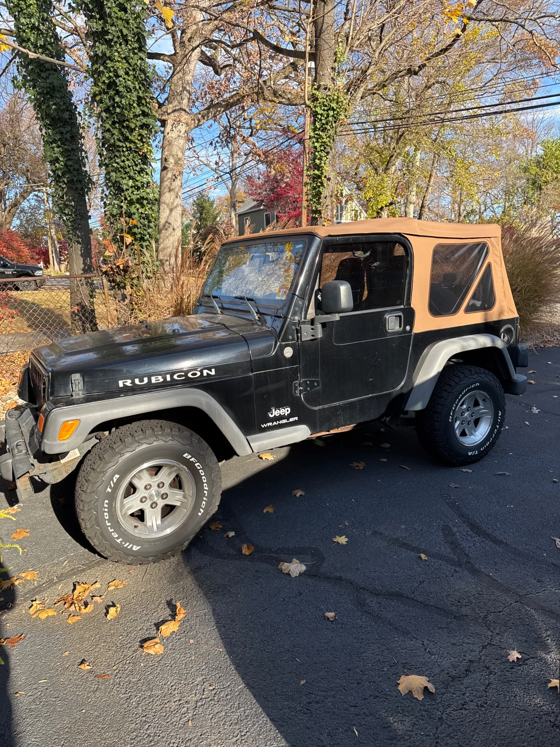

Are you sure that rig is actually a Rubicon? No factory rocker guards indicates you bought a TJ that only has a Rubicon sticker.
Good catch, OP was this sold to you as a Rubicon because it definitely doesn't look like one. Hopefully you didn't get to pay the Rubicon premium for a non Rubicon Jeep?

Nice TJ and welcome to the forum. I hate to break it to you, but your TJ doesn’t appear to be a Rubicon. It has been upbadged. Still a good looking TJ though. You can find the original build sheet for your Jeep here:

It would have Moab wheels and the wider black fender extensions also, correct?
The telltale signs are the absence of Rubicon rocker panel guards, as well as no mounting holes left behind to tell us they were removed, as well as the narrower flares and small flare extension pieces that do not belong on Rubicons. Another sign is the Ravine wheels, which are not enough evidence on their own as wheels are easily and commonly swapped, but with the rest of the items above, is the nail in the coffin.

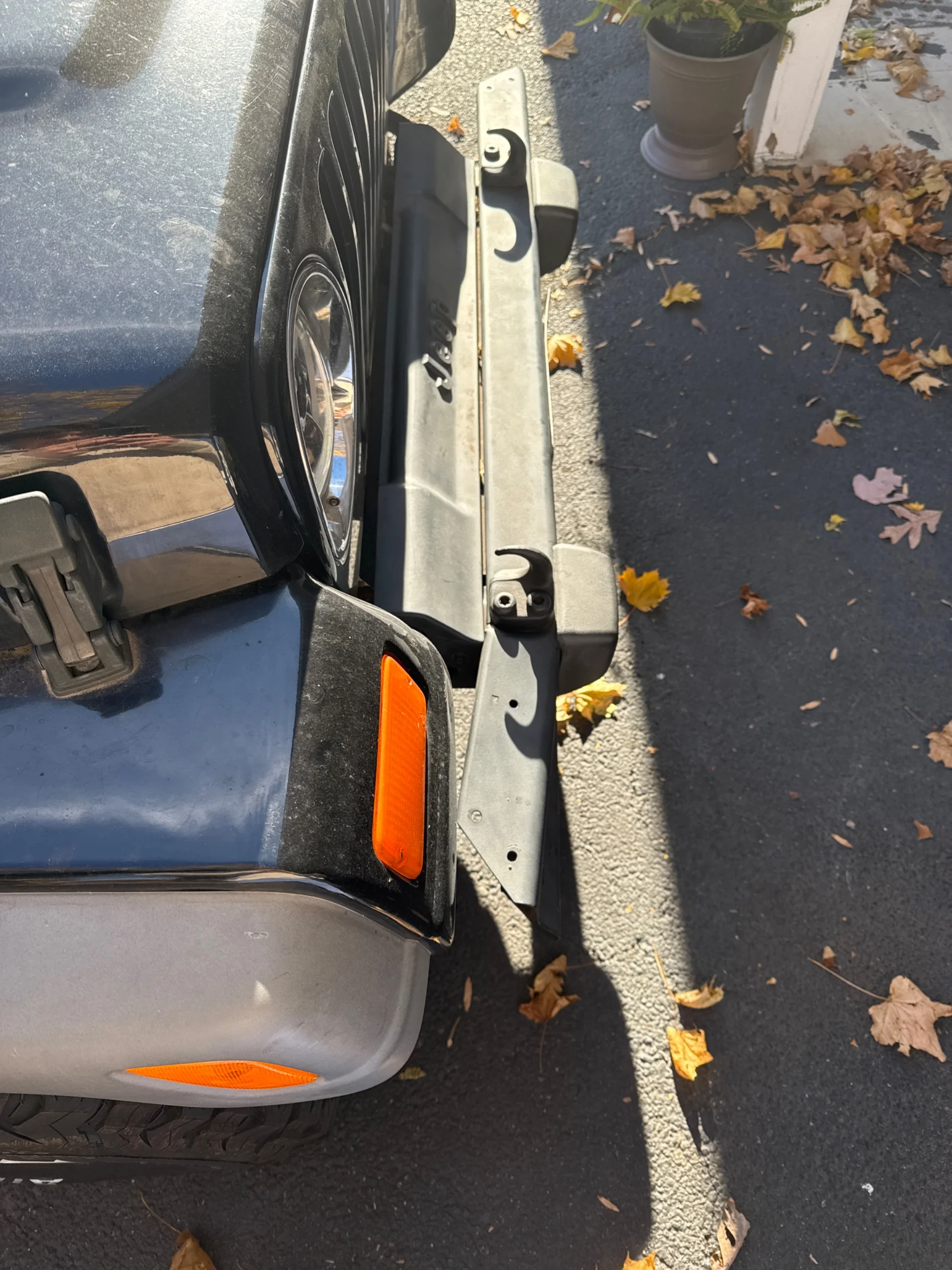

If you're on a budget, that bumper could be straightened.
Also, it's common to cut it shorter making it look more like a stubby/crawler bumper.
