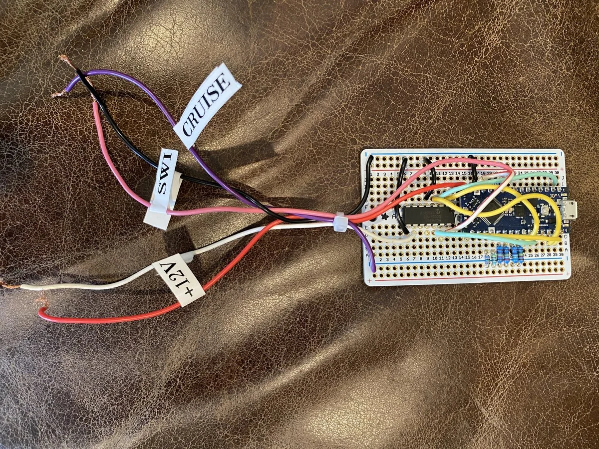

Another update.
I couldn't get the TJ PCM to properly detect the voltage drop using PWM so I ended up just replicating the resistor ladder that is in the steering wheel buttons themselves. It works great to capture the cruise controls signals and pass it along. I have a Clarion M508 for my stereo head unit and can't find the steering wheel control protocol anywhere (it isn't resistance based) so I bought a PAC SWI-RC to interface to it. I'm going to try and sniff the signal to decode it so I can just program it into the Arduino. If that doesn't work, i'll wire it in permanently using either PWM, the DigiPot, or another resistor ladder.
Here's the prototype board so far with some if it soldered in.

All done. It may not be pretty but it works fantastic. I'll write up a parts list and a how-to later for anyone that wants to try this.
Well done, and doesn't look that bad. I look forward to the how-to. I assume you'll have the schematic and code?
I've been thinking of trying some custom etched PCB using the MSLA 3dprinter - this may be a good candidate.

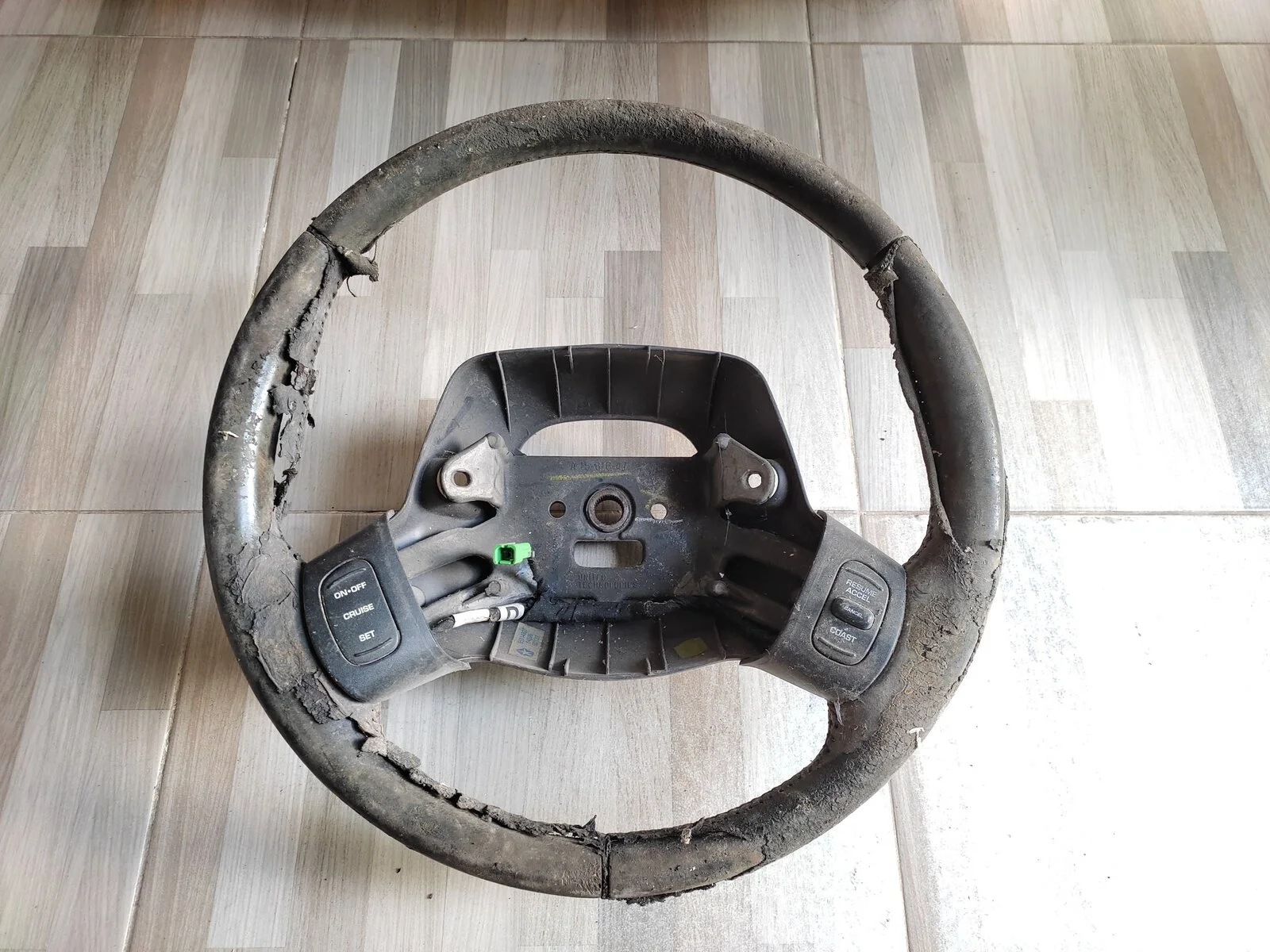

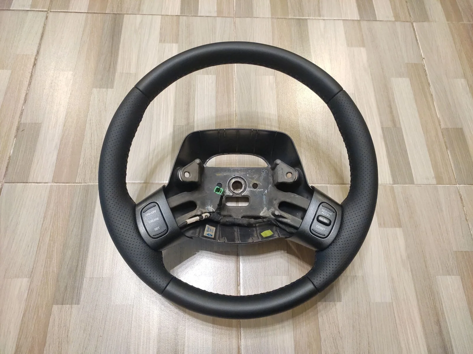

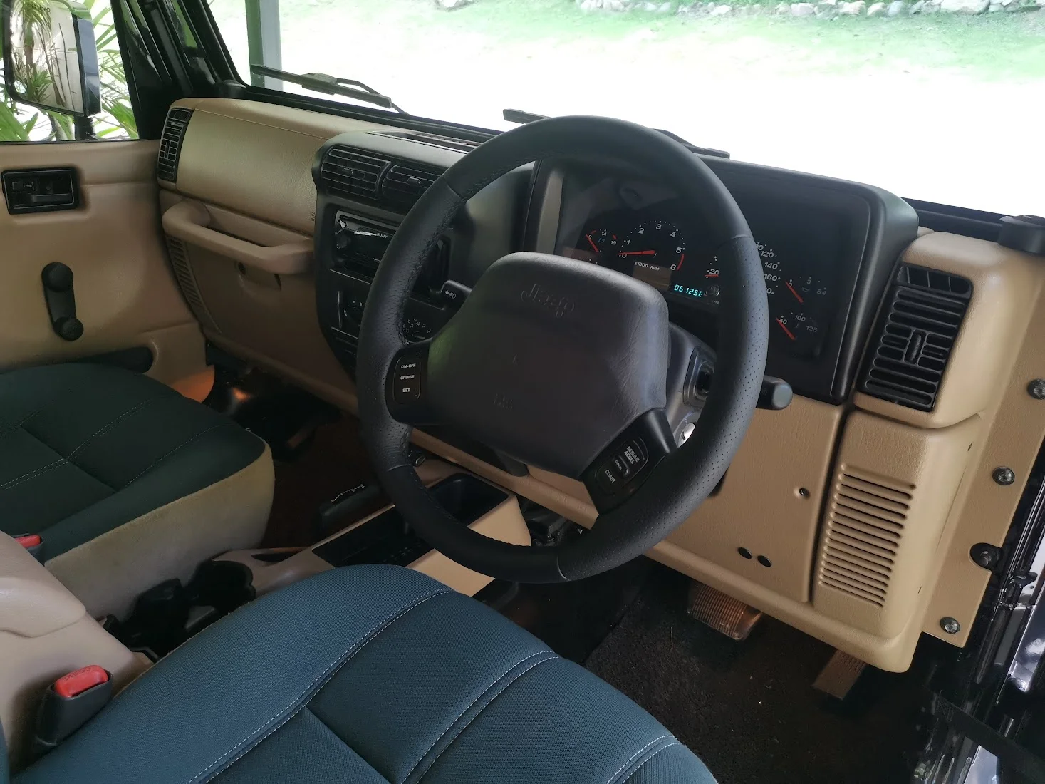

bought one from a junkyard here in Thailand and had it shipped to a leather specialist in Bangkok.. I showed him the picture of the Poland dude.. paid $40 for the old wheel and $60 for the leather job..
love it.. it's like driving a new car..

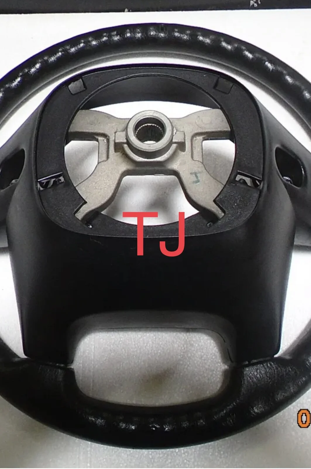

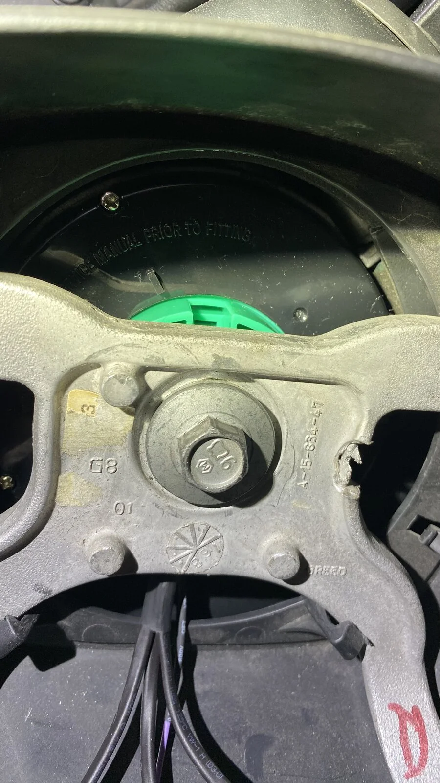

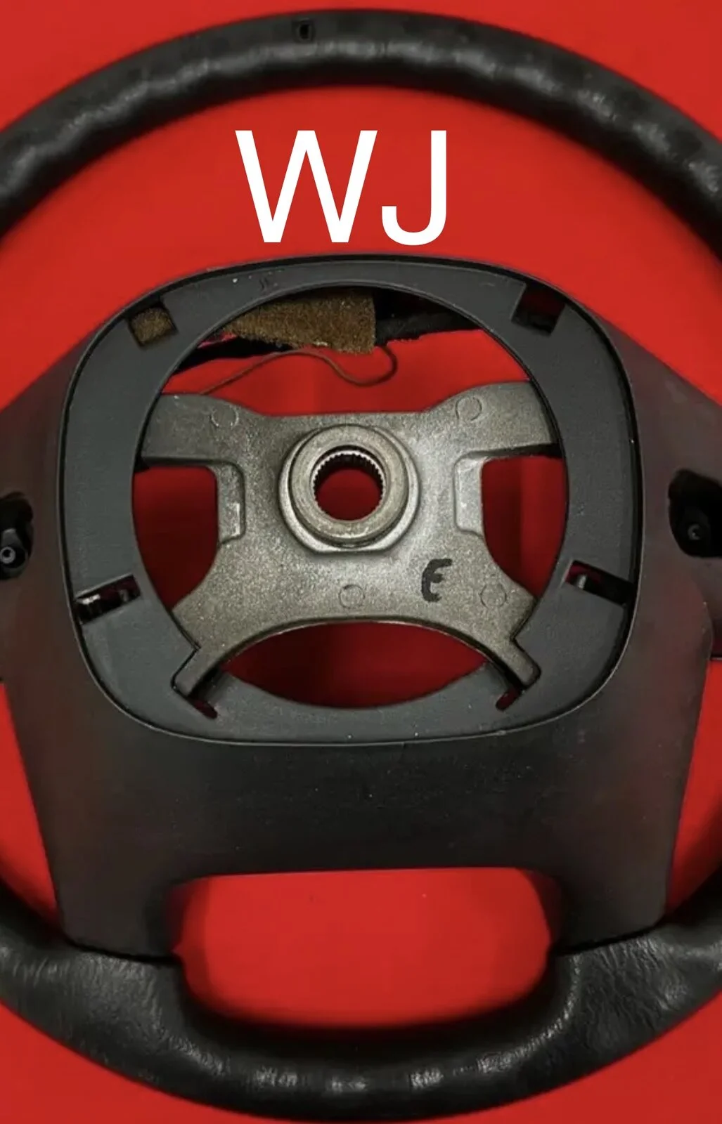

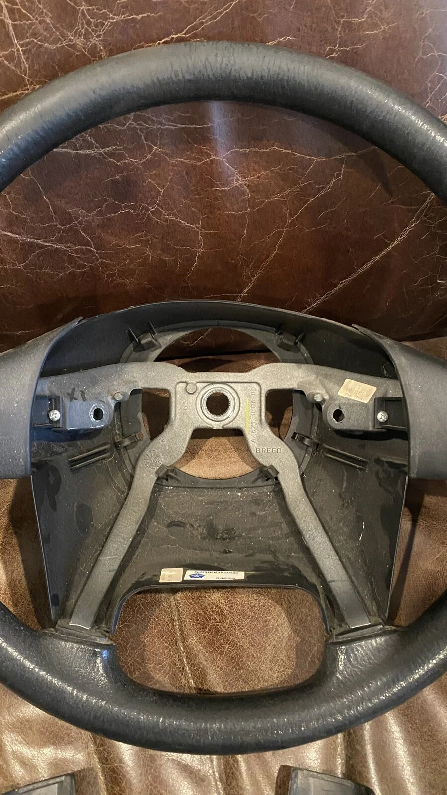

Hey LJGreg, that steering wheel looks awesome. I found one on eBay and bought one (not with the new leather, just the WJ wheel). How does your WJ Steering Wheel match up with the Clock Spring? And do the WJ airbag connectors work work? Im assuming you have a TJ Clock Spring, WJ Wheel, and TJ Airbag? Because I don't think a WJ Airbag has the same connectors as a TJ Clock Spring. I have a WJ Wheel, WJ Airbag, and TJ Clock Spring and they don't work together.
My questions stem from my issue where; my TJ Clock Spring does not match up with the WJ Steering Wheel, so theres a gap between the two. And the plastic posts on the Clock Spring don't have anything to butt up against because there are no matching protrusions on the back of the WJ Steering Wheel, like there are on the TJ Steering Wheel. There are two different types of TJ Steering wheels, one is older with 2 spoke design and one is newer with 4 spoke design like yours and like the WJ. However, ALL TJ steering wheels have the same protrusions on the back side for fitment with the Clock Spring. But the WJ Steering Wheel does not. So I installed the WJ on my TJ and broke the Clock Spring when turning the vehicle. So now Im a little stuck with a lot of components. I'll attach a pic of the back of the wheels.

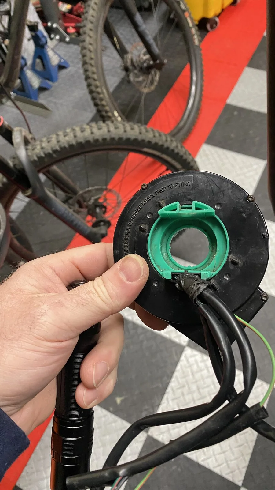

My original TJ wheel looks more like the WJ wheel than the TJ pic you posted above. I have an 05 so this could be early model vs late model.
Here is my original wheel.
And here is my clockspring.
And here you can see how the wheel sits on the clockspring. It fits perfectly.

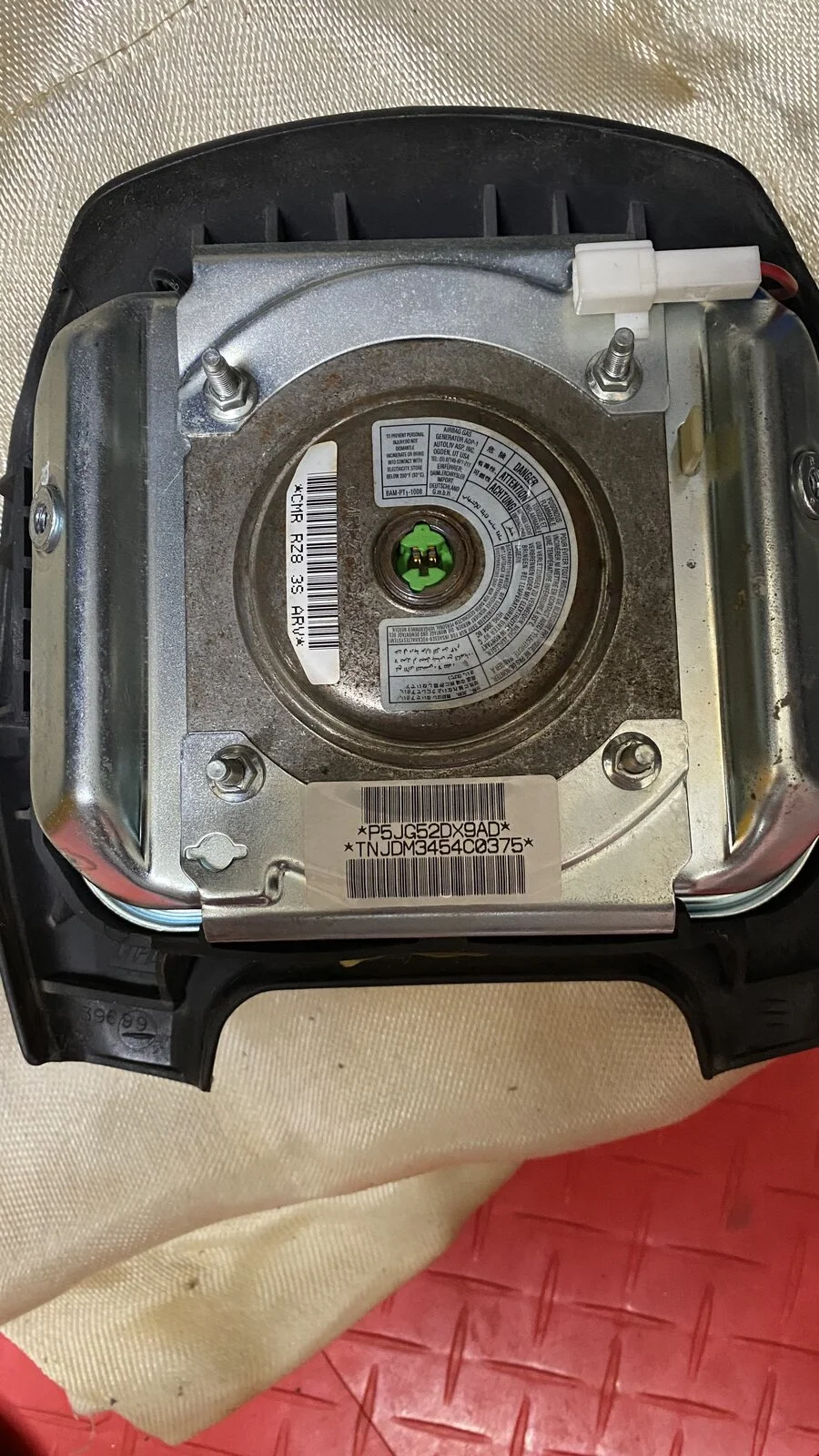

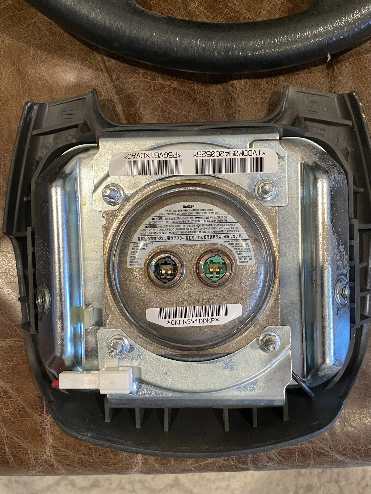

the WJ airbag is a dual staged so it has two connectors but they are the same type as the TJ. I'm not too sure if it would work properly if you only connected the green connector but since the TJ airbag bolts in just fine to the WJ wheel I am just running that one.
TJ airbag
WJ airbag

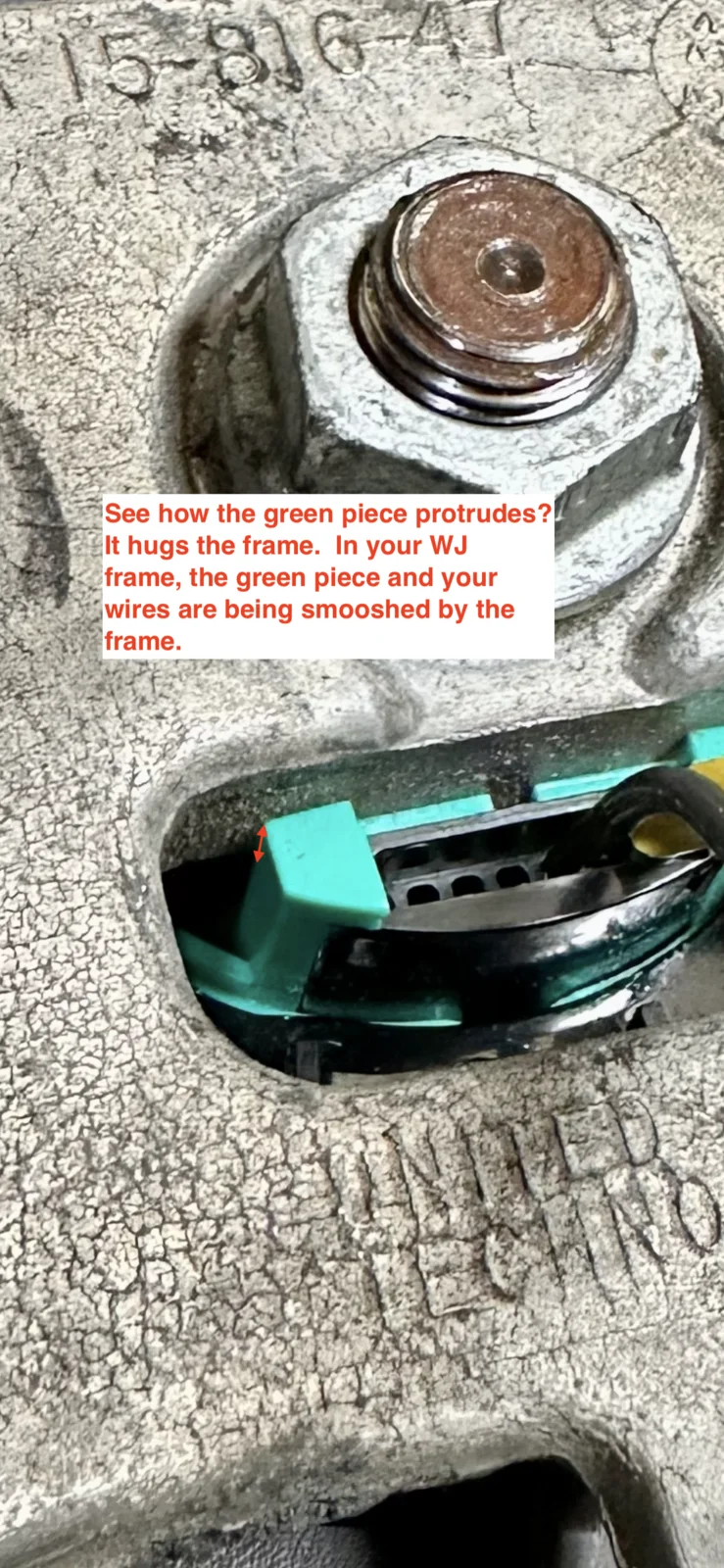

Thanks for the reply! There's a pretty big difference between the WJ and TJ wheel frame you just posted. In the TJ frame, the green clock spring post with the airbag wire protruding sits under the metal frame of the TJ wheel frame and hugs it. The top of green plastic for the clock spring actually sits flush against th bottom of the metal of the wheel frame and the wires come straight out without being blocked in any way. So those two green protrusions from the clock spring actually hug the frame of the TJ wheel. But I can see in your pic of the WJ wheel, those two green protrusions are butting up against the back of the frame and the airbag wire is being smooshed instead of coming through the frame hole. Thats the issue I had. When you tighten down the wheel nut, it crunches the wires and the green protrusion. I did it too tight and when I turned the steering wheel it shredded the clock spring housing into prieces bc the metal frame was pushing on the green clock spring protrusions. I can see you would have the same issue but you must not have tightened the nut as much as I did and so the wires are not pushing too hard against the green protrusions. But for all intents, the WJ steering frame does not fit any of the TJ clock springs because those green protrusions are supposed to be unblocked by the frame, and should hug the frame not be smooshed behind the frame.
All that to say, I think it would still technically work for me I just have to make sure I don't overnighted that nut. But it might not be accurate to say it's a straight swap. It just happens to work even though it doesn't actually fit correctly. And I'd warn people that over tightening will break the clock spring. In the original set up, you can't really over tighten because the wires come through.
Im also wondering, in your setup, what is making the steering wheel frame move along with the clock spring? If the wheel frame is sitting on top of your clock spring, then there is no fitment hugging the two items together to make them move in tandem unless its just the friction between the wires and plastic protrusion smooshing against the back of the frame. you may have just gotten lucky that your clock spring is moving in tandem with he wheel frame?
