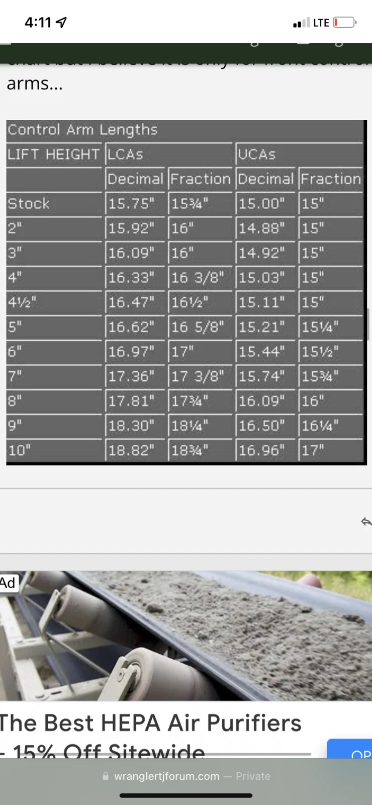

Hey guys, apologies if this is a stupid question. Ordered some new lower control arms. They just came in and when measured they are .25 in longer than what is currently on my TJ. I’m running a 4 in lift and the new control arms are fixed. Website stated they were for 4 in lifted TJ but couldn’t find measurements anywhere so took a leap of faith. The Jeep drives great now, straight line no vibrations or death wobble from 0-75mph. Would hate to screw that up although I feel this shouldn’t make a difference. Would just hate to put them on only to have to remove them again. Upper control arms are all stock and freshly replaced.
Current lower arms are 16 in from eye to eye
New ones are 16.25 in from eye to eye
Thanks!
