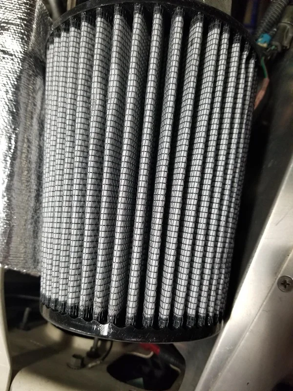

Some here will advise removing the K&N system because the oiled cotton gauze filters are famous for letting dirt past the filter and into the engine. I'd recommend just getting a synthetic dry element filter to replace the oiled cotton gauze filter.
Is the Kyostar Universal Dry Air Filter the kind of filter you are talking about?
I would pass on that one. The product info is contradictory to the product name:
washable, oiled synthetic media
Look for a filter like that specifically says oil-free. The one I'm using is an AFE dry filter product:
You can use this filter finder to input your measurements and find an AFE product or maybe cross reference it to another brand: https://afepower.com/build-your-own-filter
