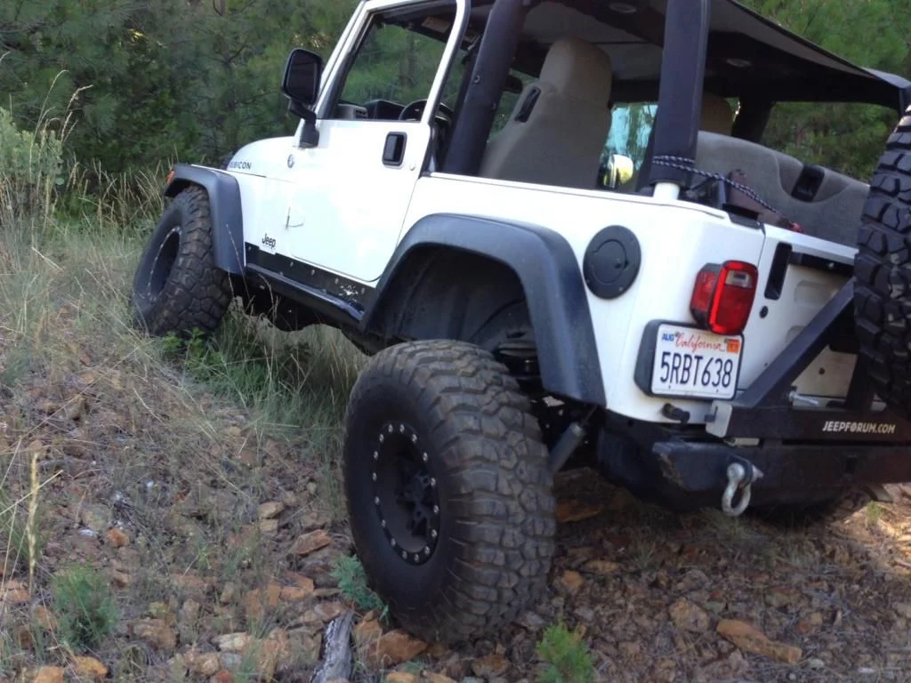

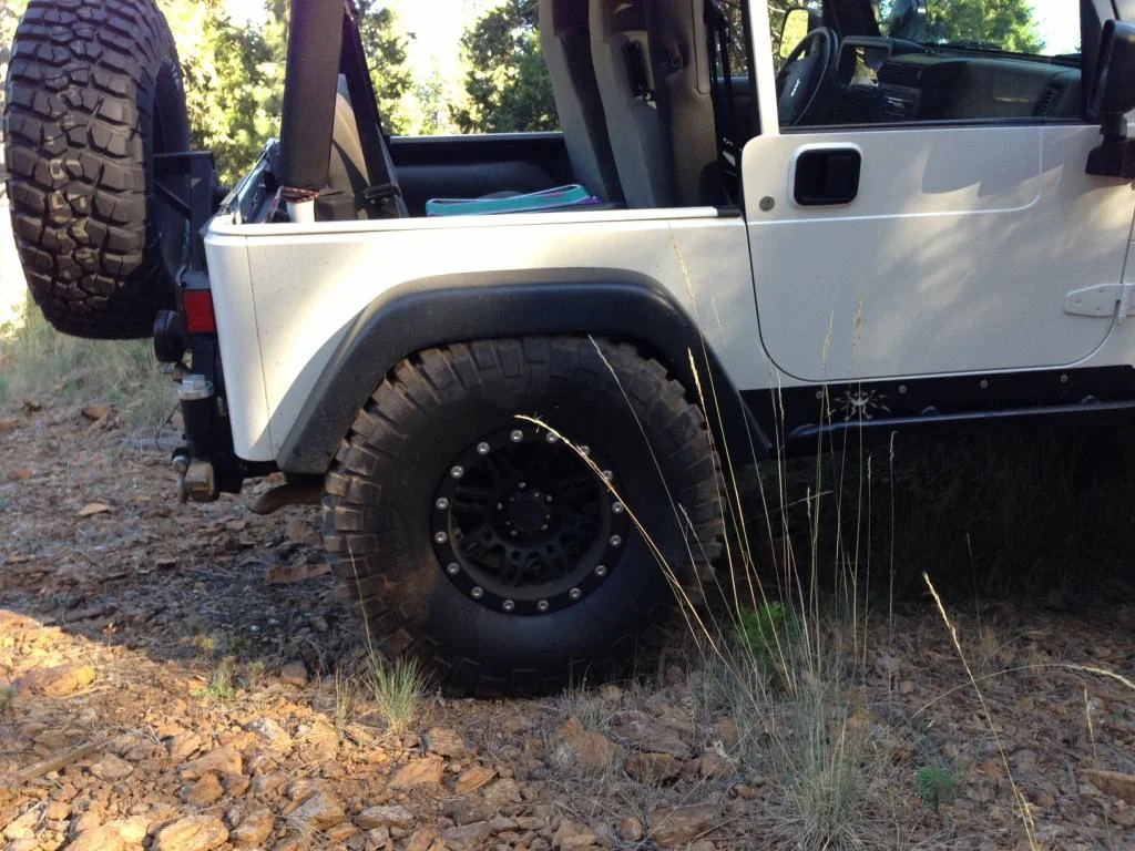

Well I am not a suspension guru or a math major but I can tell you 4" of lift is not enough for 35's alone. This is my 05 Rubicon w/ a 4" lift flexing the rear only before I added a 1" BL
