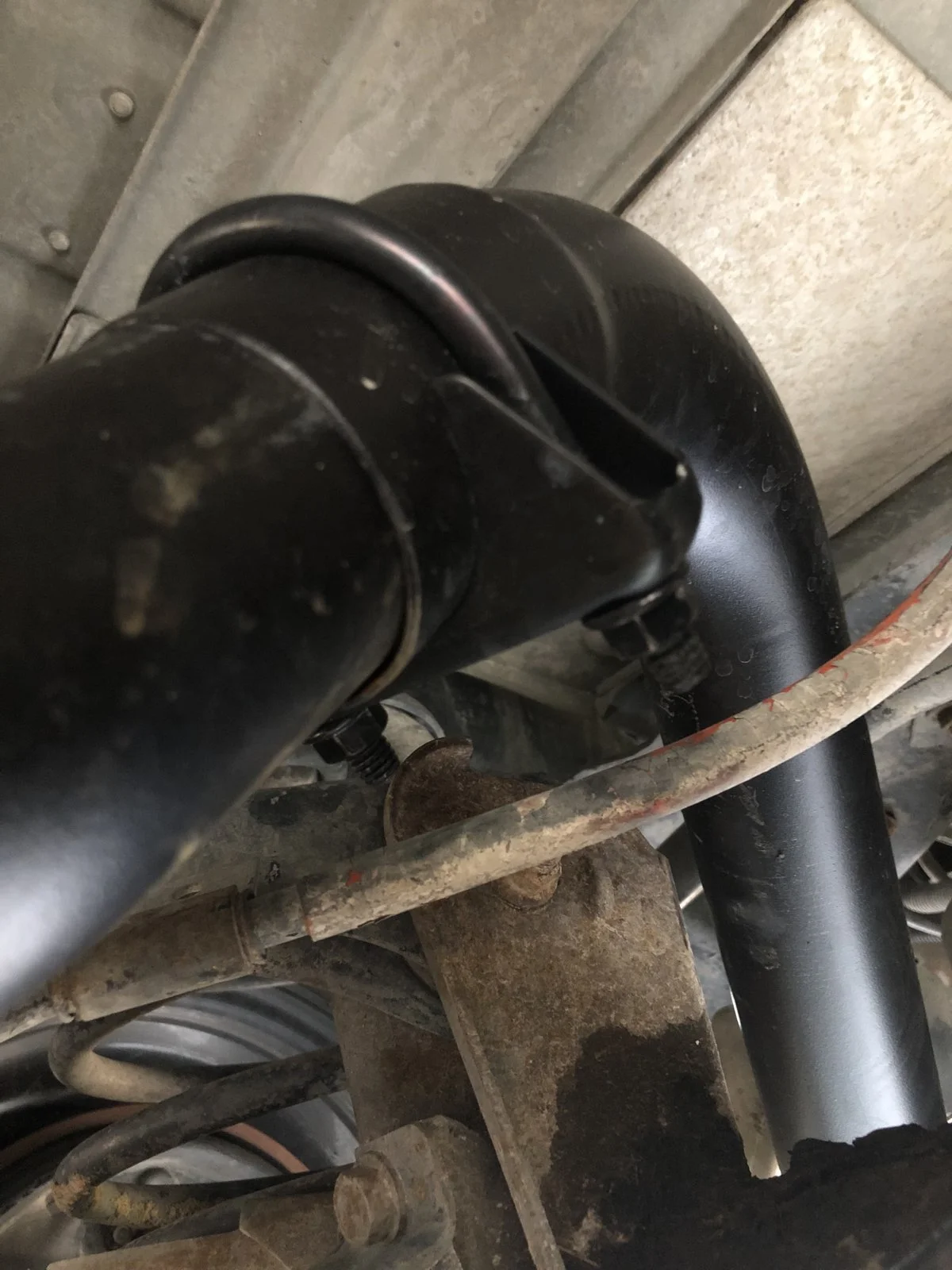

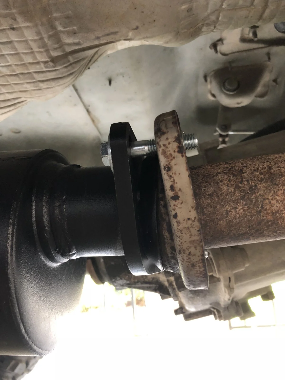

Tires are clear of any debris. And there is no tick at low speed unless I give a fair amount of pedal. The clamp (first photo) is also tight and clear of hitting anything. The muffler is not centered exactly to the cat (2nd pic) but is nice and tight. Will try and get it lined up better. Should there be any play/wiggle in the exhaust? Mine is super tight with no movement whatsoever. The tick sounds more like metal hitting a thinner metal.
Looking at your last photo, it makes me wonder if you don't have just the slightest exhaust leak going on, there. The alignment between old and new is such that the gasket area gives the appearance of having the potential to leak. Not knowing for certain what your "ticking" noise sounds like, all I'm doing is guessing. I'd look into it, though. The exhaust is the only thing you've changed, so it's a possibility.
Looking at your last photo, it makes e wonder if you don't have just the slightest exhaust leak going on, there. The alignment between old and new is such that the gasket area gives the appearance of having the potential to leak. Not knowing for certain what your "ticking" noise sounds like, all I'm doing is guessing. I'd look into it, though. The exhaust is the only thing you've changed, so it's a possibility.
Thanks for the response. This will be the next thing I pull apart and attempt to get lined up better. The muffler was much higher on the hangers than the cat and so I had to gently jack the cat up before tightening the bolt down and lowering. Really hoping that this is the issue. It's hard to describe a sound to someone via text. I'll jump under there this evening and see what I can do. Texas heat is keeping me from doing much outside today. The shop fan feels like a hairdryer!

Just an FYI @Squatch, there is no gasket between the muffler and cat pipe. Its a tapered fit. Looking at the picture, I'd guess exhaust leak too.
Yeah, I know there isn't a gasket, actually. I was just in a hurry to get out the door, and couldn't for the life of me remember the technical term for the bell/flare (obviously still can't remember it!). I just wanted to get the idea across that it could very well be an exhaust leak based on what I was seeing in the pic. My referencing the "gasket area" is actually a little embarrassing, in hindsight. Appreciate you having my back, though, and keeping me on the straight and narrow! :)
