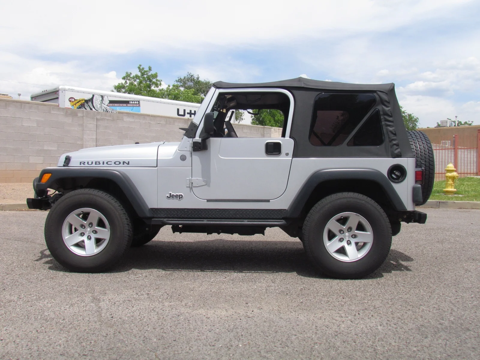

So looking at your earlier post you are are at 7.5 from your tire to your flare and you have a body lift?
I am at 7 3/4 at the same place and I have not body lift. I wonder if I got some miss marked rears that are actually 4inch spring but were missmarked as 2 inch heavies?
Either way @bobthetj03 I ordered some 941's yesterday. I figured for 160 bucks it was worth the gamble, and it is what ARB recommended. If it doesn't work out I can ask ARB "Now What?" and see what they have to say, but I am starting to think I just got some bad rear springs one way or the other.

I do have a 1.25" BL. Yours doesn't look that bad. I would just throw a 1" spacer up front and call it a day and see how that looks
My point was my rear end is taller than yours and I don't have a BL. That is weird to me with a supposed 2 inch lift.
I did buy heavy duties all of the way around. But the rear end is super tall and even with a transfer case drop it vibrates at take off. Also the rear swaybar ends don't really fit anymore. I have them in but it was pretty pissed about it. This all doesn't seem to match what others are saying about the OME 2 inch lift.
Anyhow, I did order the light duties for the rear, and we will see if that brings it down, so I don't look like Starsky and Hutch anymore.

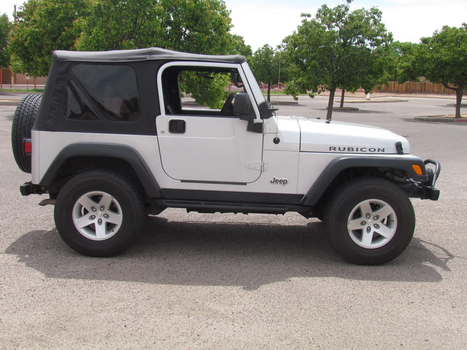

If you want something to compare, this is my TJR with OME LD springs front and rear & 265/75-16 tires. In the photo, it has the Dirtworx front and rear bumpers, but no extra weight other than that. Since this photo, I have added 3/4" spacers front and rear, and I am also using the oem spring isolaters.

OOOOOhhhh I thought you were running the 3/4 spacers up front only. So you really didn't do anything to level it out. You basically have the same lift front and rear, but it is pretty level.
Like you I have no weight in the rear, I don't plan on any weight other than a light trailer towing a quad or sport bike every once in a while. Rarely really, as I have a full sized pickup. I do have a dirtworx rear bumper, but it is only holding a hilift jack and a 31. I don't plan on going any taller tire, so really I have no extra weight in the rear. Even to add to that, I am getting rid of my top, and am going to run a super NX which will eliminate my bows also.
So now when my springs come in, I may just leave all of the spacers as is, and only change the rear springs, and see what that nets me. I have a full set of 3/4 Daystars standing by also in case I need them in the front or the rear. (I won't stack them). Talking to ARB after the fact, I probably should have ordered the 941's in the first place based on my set up.
My whole point of this lift was just a little 2 incher to get the flares off of the front tire. I really don't want to use the 3/4's if I don't have to. I am not looking for more height, just the 2 inches, and then level it for the most part. I don't mind a little factory rake, but I do thing 2 inches of rake on the rear on a 2 inch lift is more than I like. Especially if there is something I can do about it.
I would be super happy with that. That looks great! thanks for sharing.

It is all starting to make sense now. I am starting to really get excited about the new rear springs. I still don't understand why I have so much more rake than everybody else running the same spring, but I am beginning to suspect there is some kind of voodoo magic in play here.
Here is one of my theories. Your part number is 942, but in actuality my part number is 2942. You, Chris, and others got yours many years ago, so I am thinking that now the added 2 might mean that mine are a second gen 942, which may have a slightly different formula. Or maybe they are just defective springs. Weirdly ARB says that my picture is normal, and they have seen that a million times, and that their resalers don't really do a good job marketing heavy vs light duty springs, but when I see all of your pictures, you all have heavies front and rear and are more level, and you have all shown me pictures, so really I am deducing either I have a bad set of rear springs, or since the number has changed, they are different now than they used to be.
I am hoping the 2941's will tell me the whole story when I get them in.
I also hope that if ARB is right, and this is happening a lot, that if someone that Googles this, will have a finished resolve.
