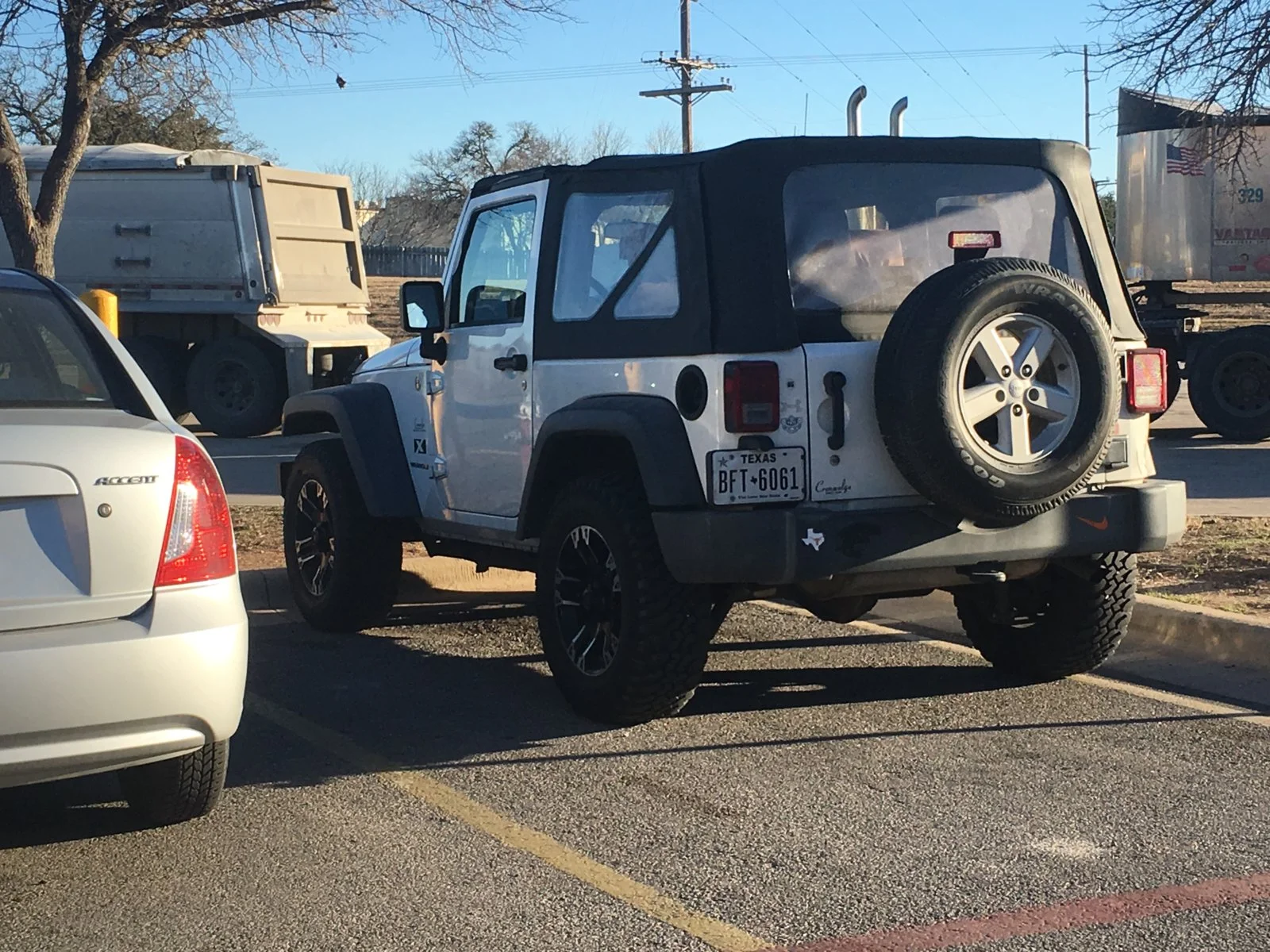

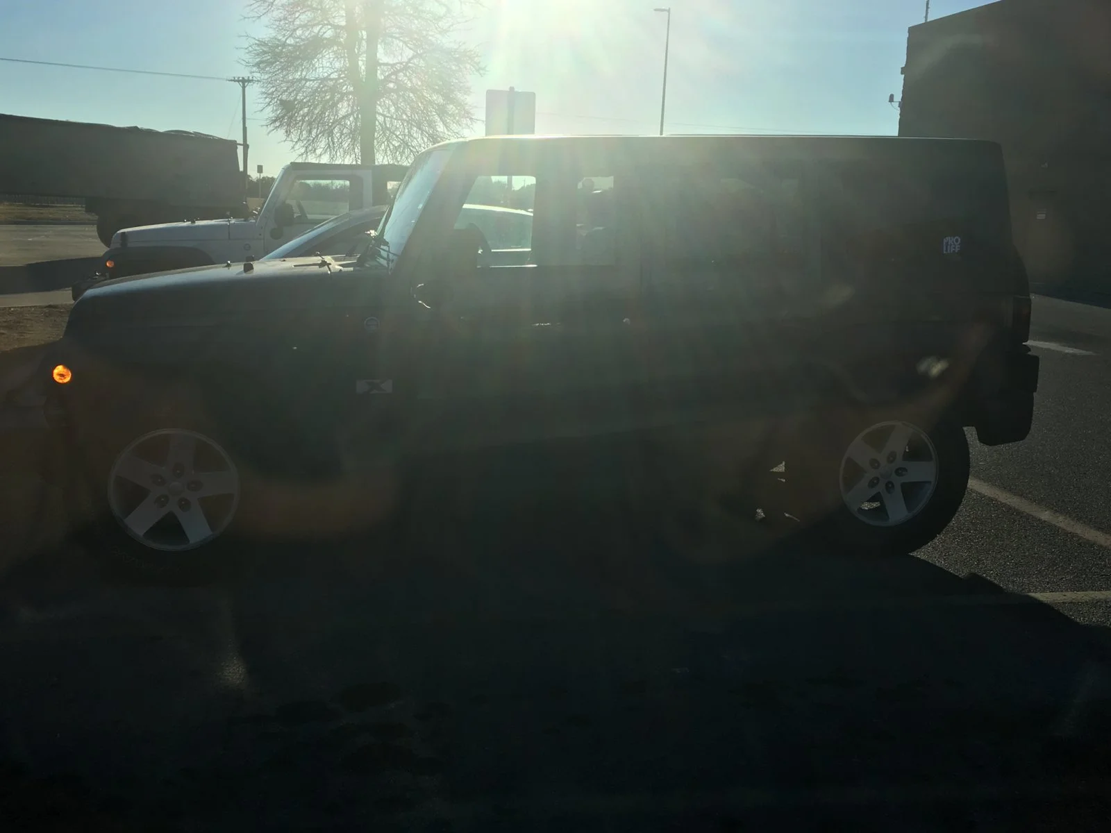

Look at the rake on this JK and JKU. I saw both of these today almost side by side. Both look stock but rake is severe. Sorry the first pic is so bad!

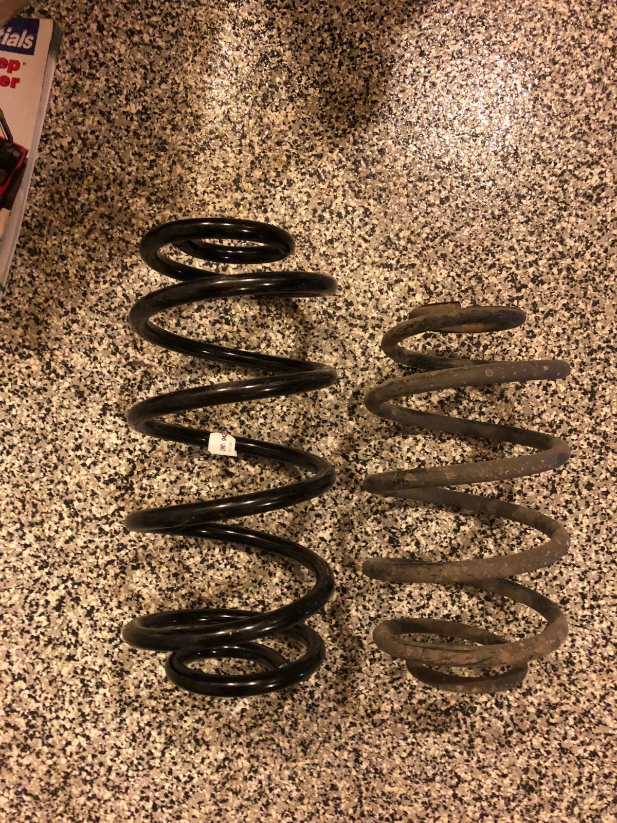

I have understeer after my lift so I need to do it anyway. I will correct the alignment and the steering after I get mine to sit right. <= or the way I want it to sit. I am still waiting for my springs. Hopefully will be here by Friday so I can get them on this Saturday. By the way here is a picture of my stock rear spring in relation to the 2 inch rear heavy spring @bobthetj03.
