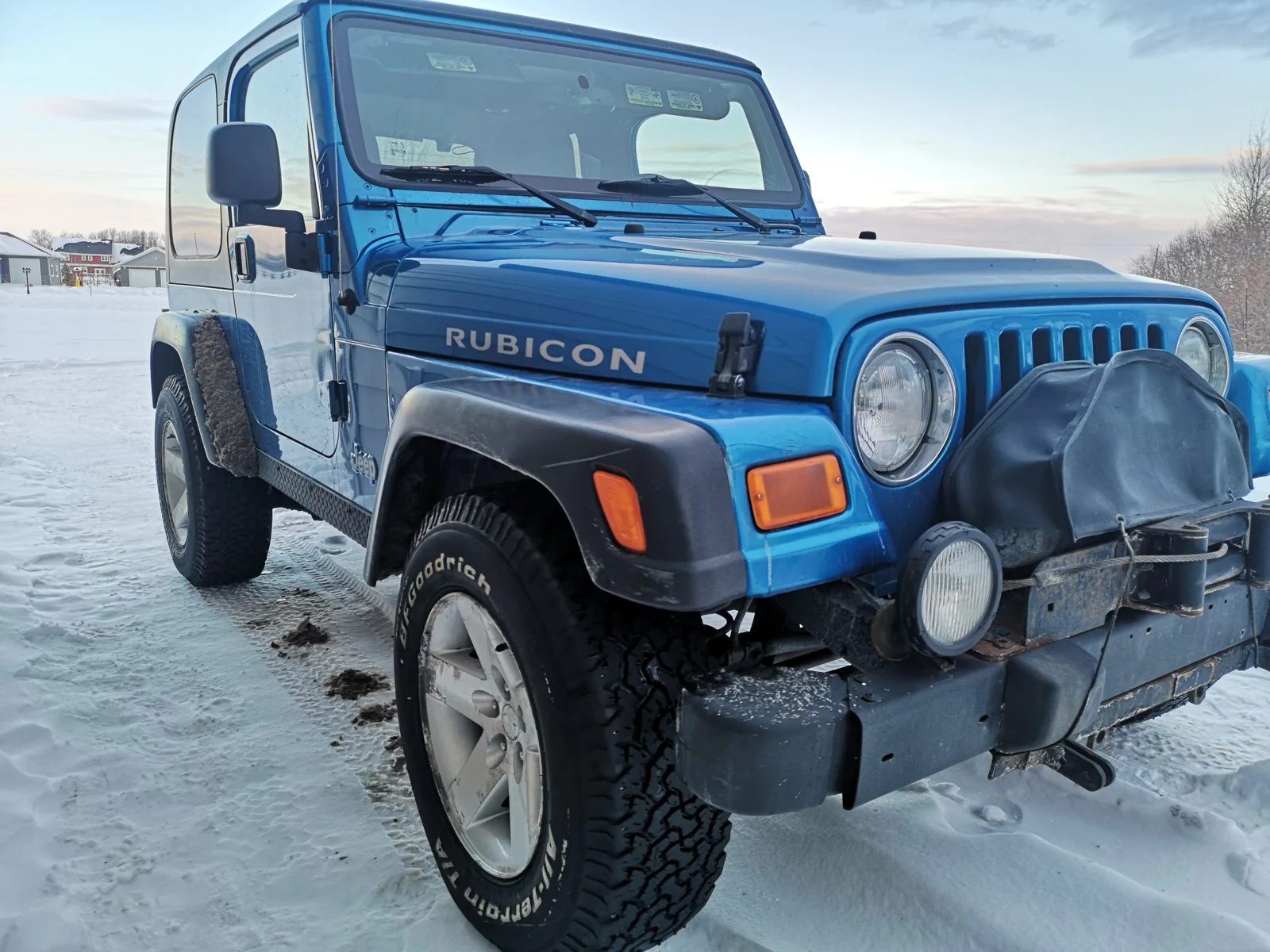

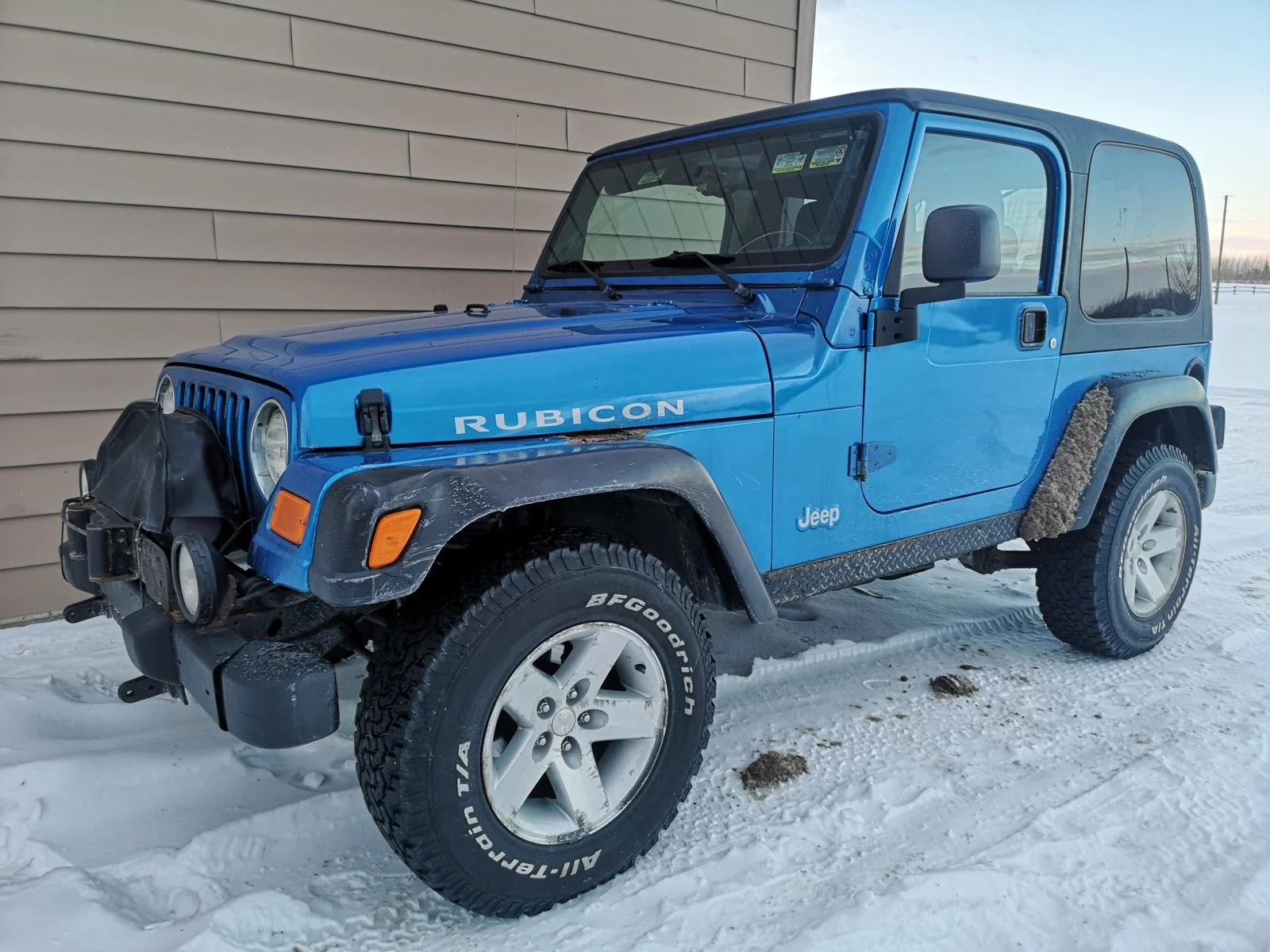

So I just purchased this 03 5speed Rubicon (145,000kms) and am new to TJs. I'd like to turn it into a more capable camping and wheeling rig.
Is there any preventive maintenance or replacement parts specific to my TJ that I should know of?
So far I've ordered a replacement o2 sensor that's bad and some redline mt90 for the transmission.
Any info or advice on my jeep will be appreciated!

Awesome color, welcome to the forum. I'd get it out on the trails in stock form and see what you need. Stock Rubicons are extremely capable on their own. If you don't know the service history I'd change all the fluids. Quick and free mod is to get rid of those milk jugs on the front bumper!
Is that even a factory color on the Rubicon? If so, it's got to be the most rare color ever, because I've never seen it on a Rubicon once. @Starrs?
If that were my rig I would put 31s on it (a good tire like the Duratracs), a 2.5" lift, a winch, and maybe a few other minor things. It doesn't need too much to be a capable rig, even in stock form it already is!

I think that might be intense blue. I’ve never seen that one.
same here I have never seen that color on a Rubicon but from the looks of the fender flares and everything else it looks like the real deal... And it looks pretty well cared for.

As far as the color goes I believe it's a factory color but parts have been resprayed. I think it's intense blue, whatever it is I love it!
It's not the patriot blue which is what my 03 tjr is.

First thing I would do is replace the front fender and check over the rest of the Jeep for rust. That Jeep has seen some salt. Rust is a real killer on these Jeeps.
Besides that, 32's, 2 inch lift, 1.25 body lift, and a tummy tuck will get you pretty much anywhere.
