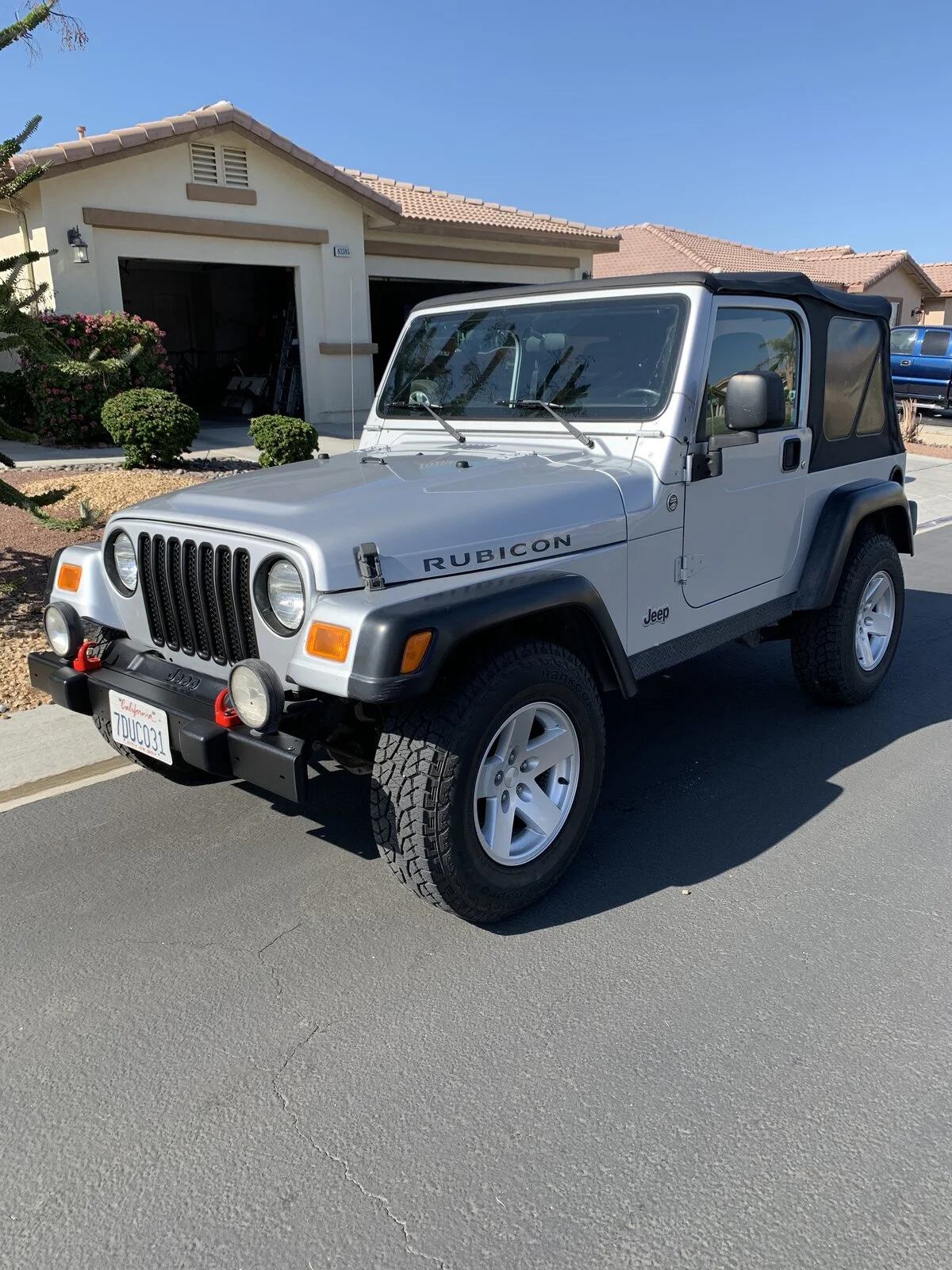

Hello fellow Jeepers. Recently picked up a 2006 TJ Rubicon and looking forward to starting in on the mods. I already own a 2013 JK, so spent the last 2-3 weeks trying to do my research and figure out all the differences between the two models before I start spending too much money. Have done a couple little "housekeeping" things on the TJ so far, and just ordered a modest 2" lift for it. The long term plan is to stretch the TJ, but that won't be for a couple years. Going to make some modest and simple mods to it in the meantime and enjoy it for for the time being. Attached a pic of it after I brought it and spent a full day cleaning it up.
