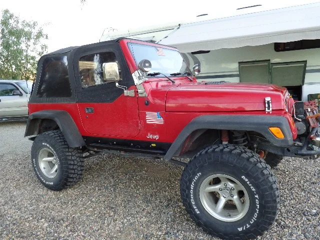

Well when we got it we heard a hight pitch scream it was the idler bearing sprayed lubrication it quit then after replacing carrier bearing or the adjuster bearing screamed replaced it then the alternator screamed well we fixed them all now the ac compressor. But it stops, Then the first trip out the gas line breaks at the tank and strands us, I have fixed most all of this and now no problems xcept ac. Got the oil changed greased and cleaned its happy we are happy
The prior owner had put shock extensions in the rear so when driving the back end was allways bouncing . I think that is what pinched the fuel line into plus he had a complete skid plate around the tank and it was full of fuel loads of fun.
