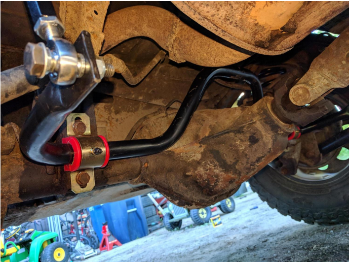

do you have a rear anti-sway bar?
black bar in photo, note the links in this pic arent stock.
