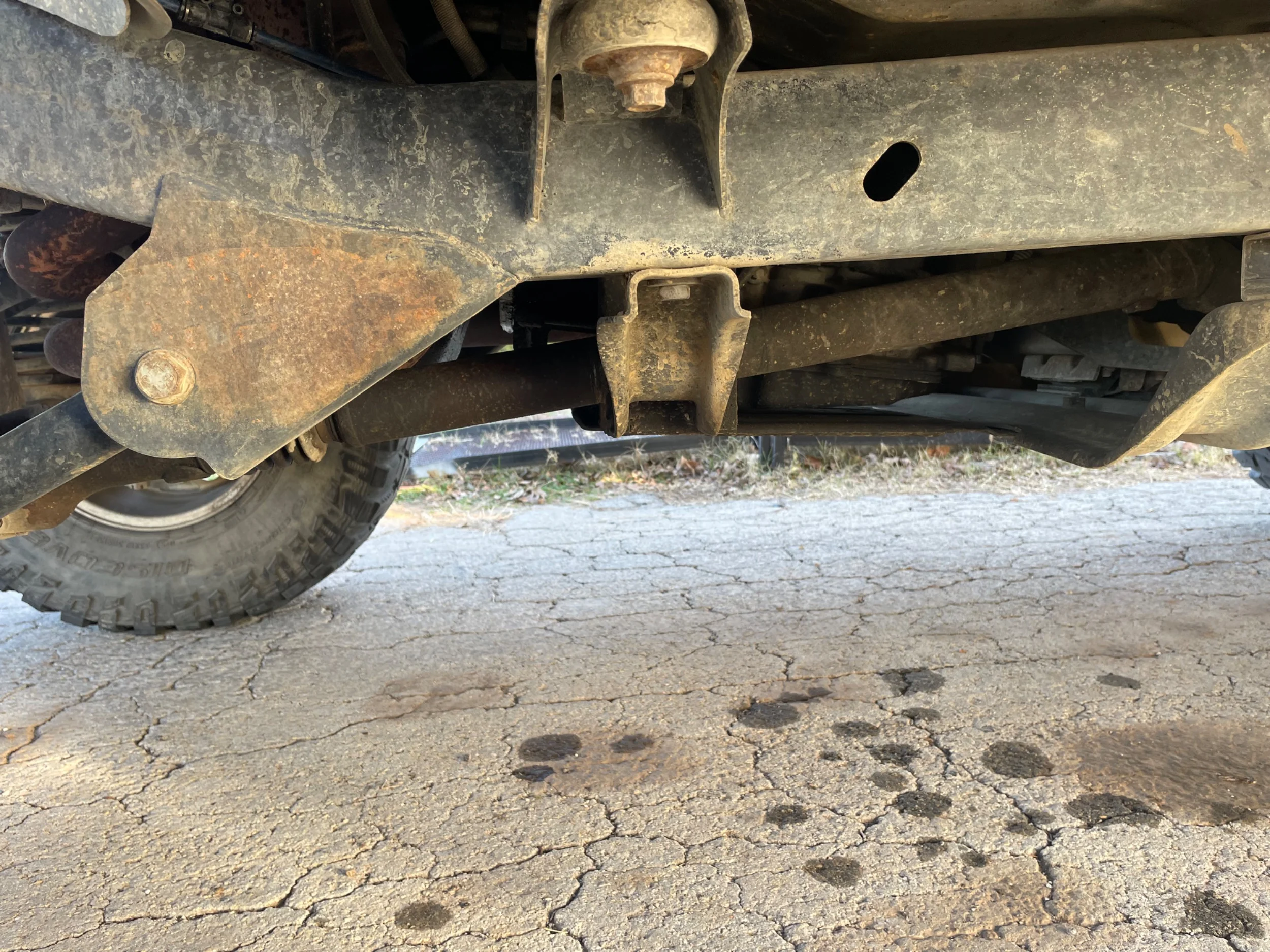

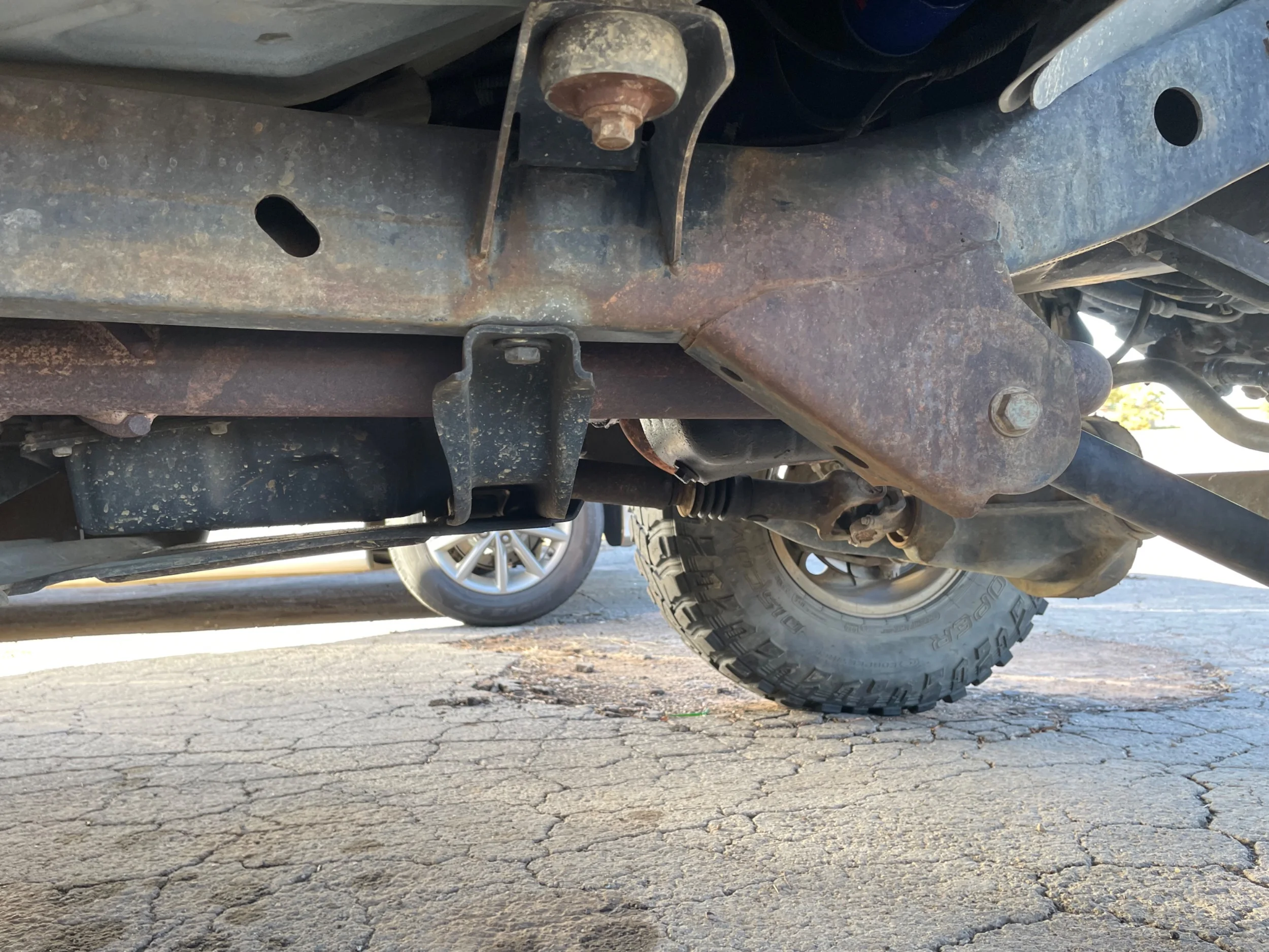

Check frame for rust

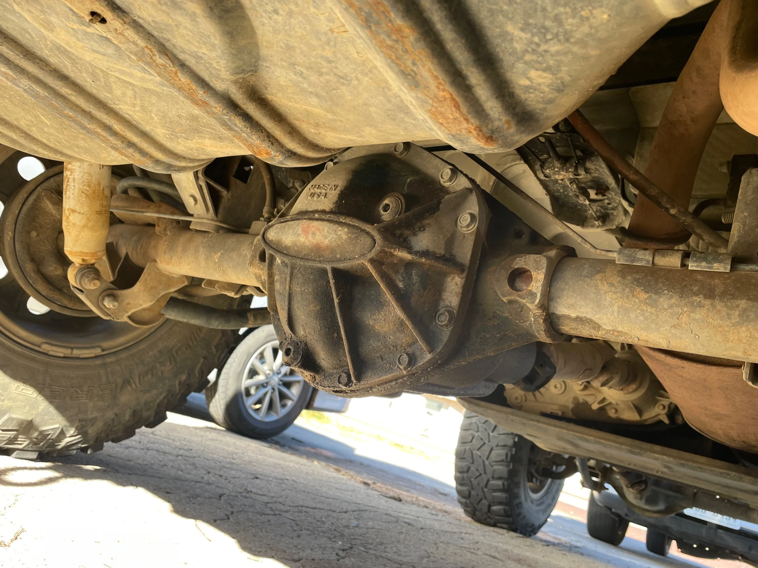

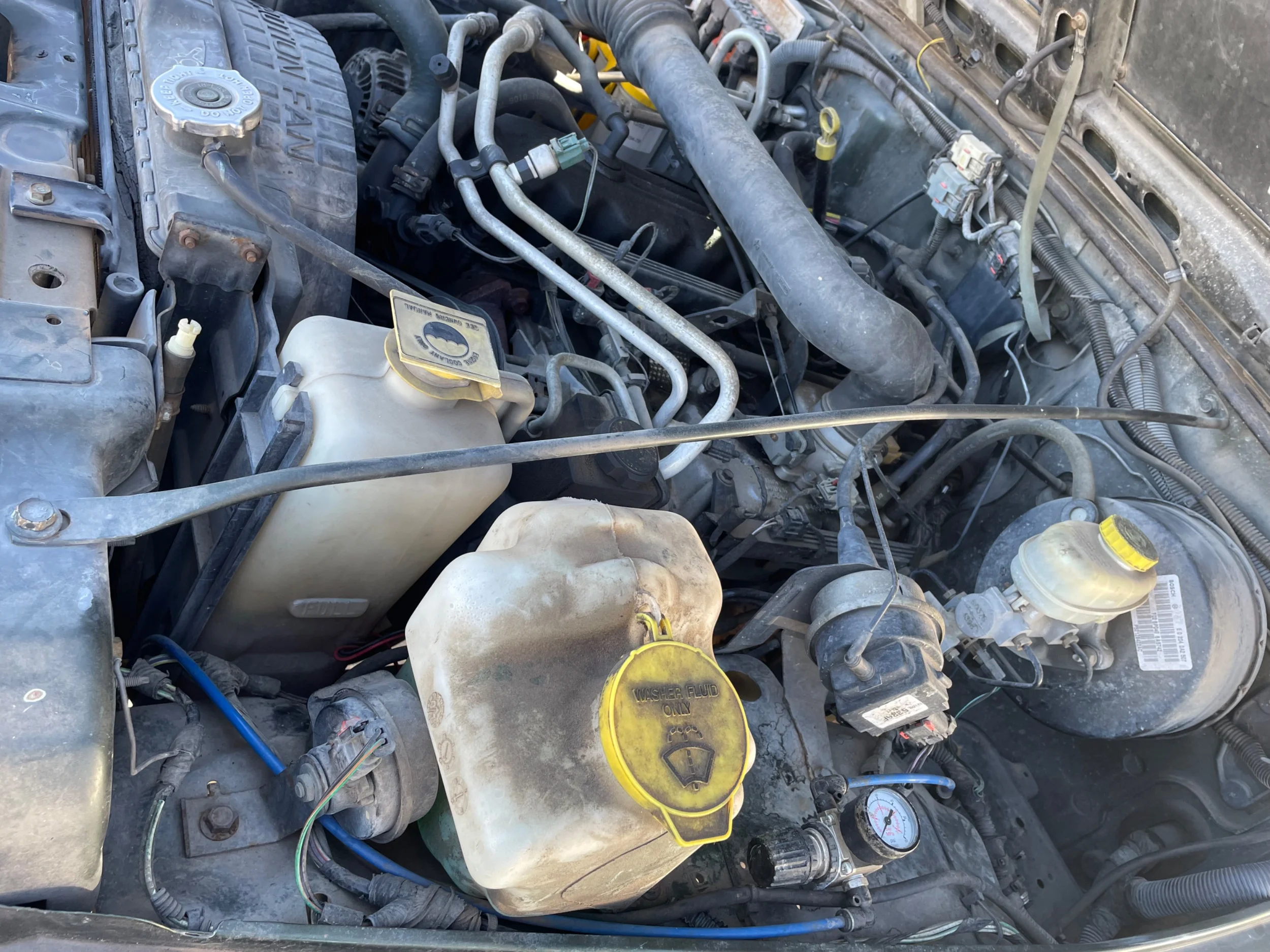

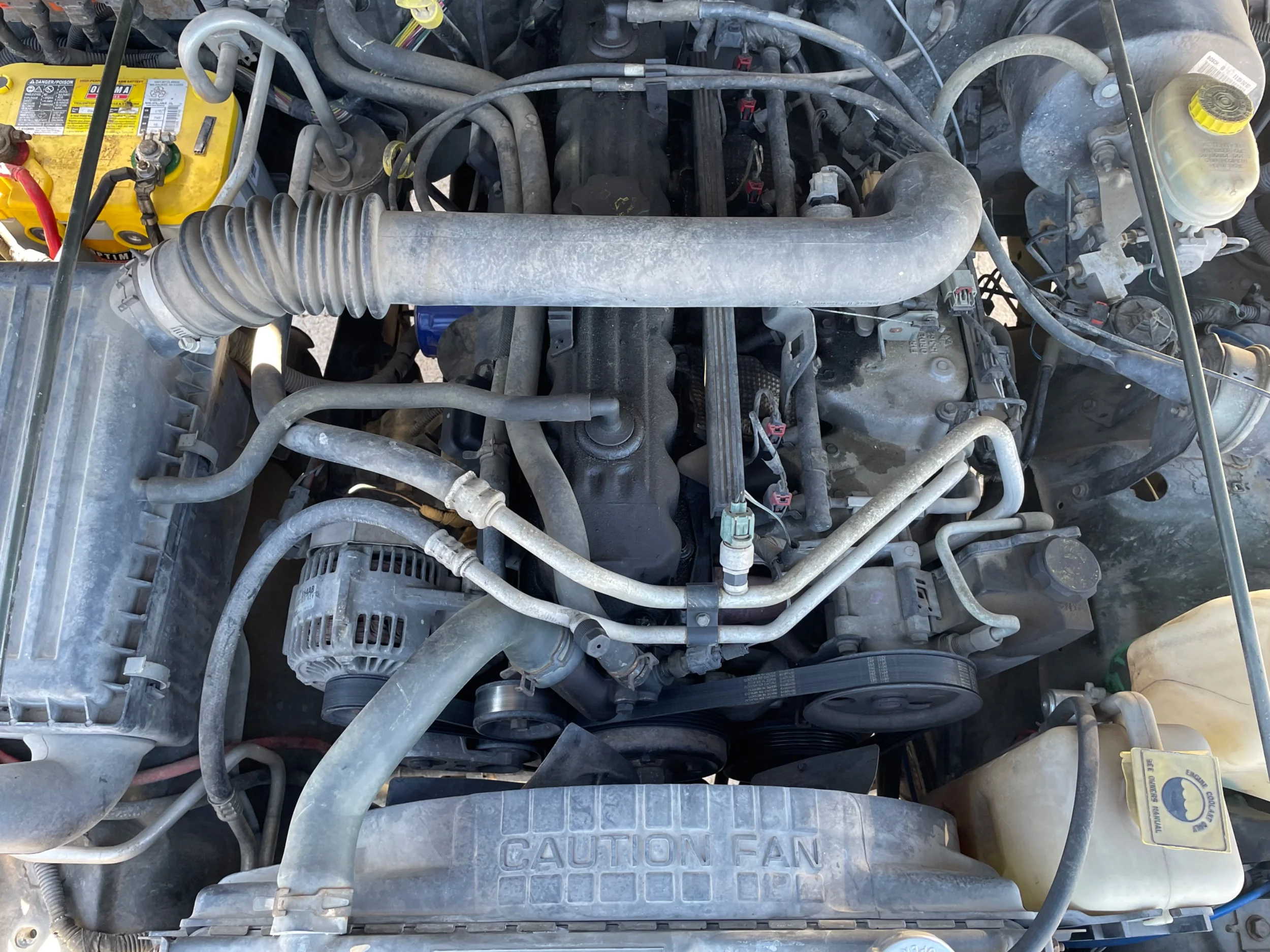

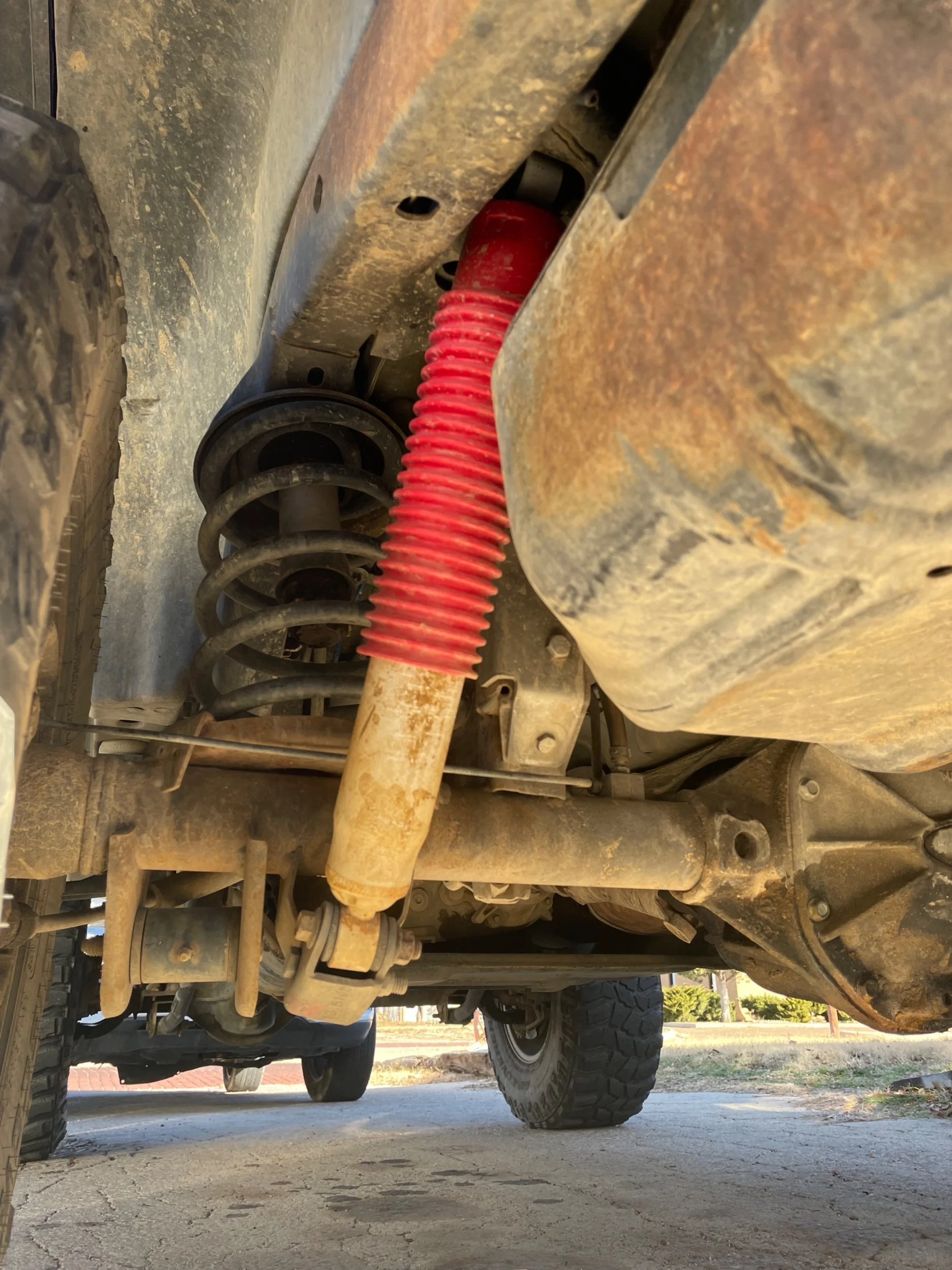

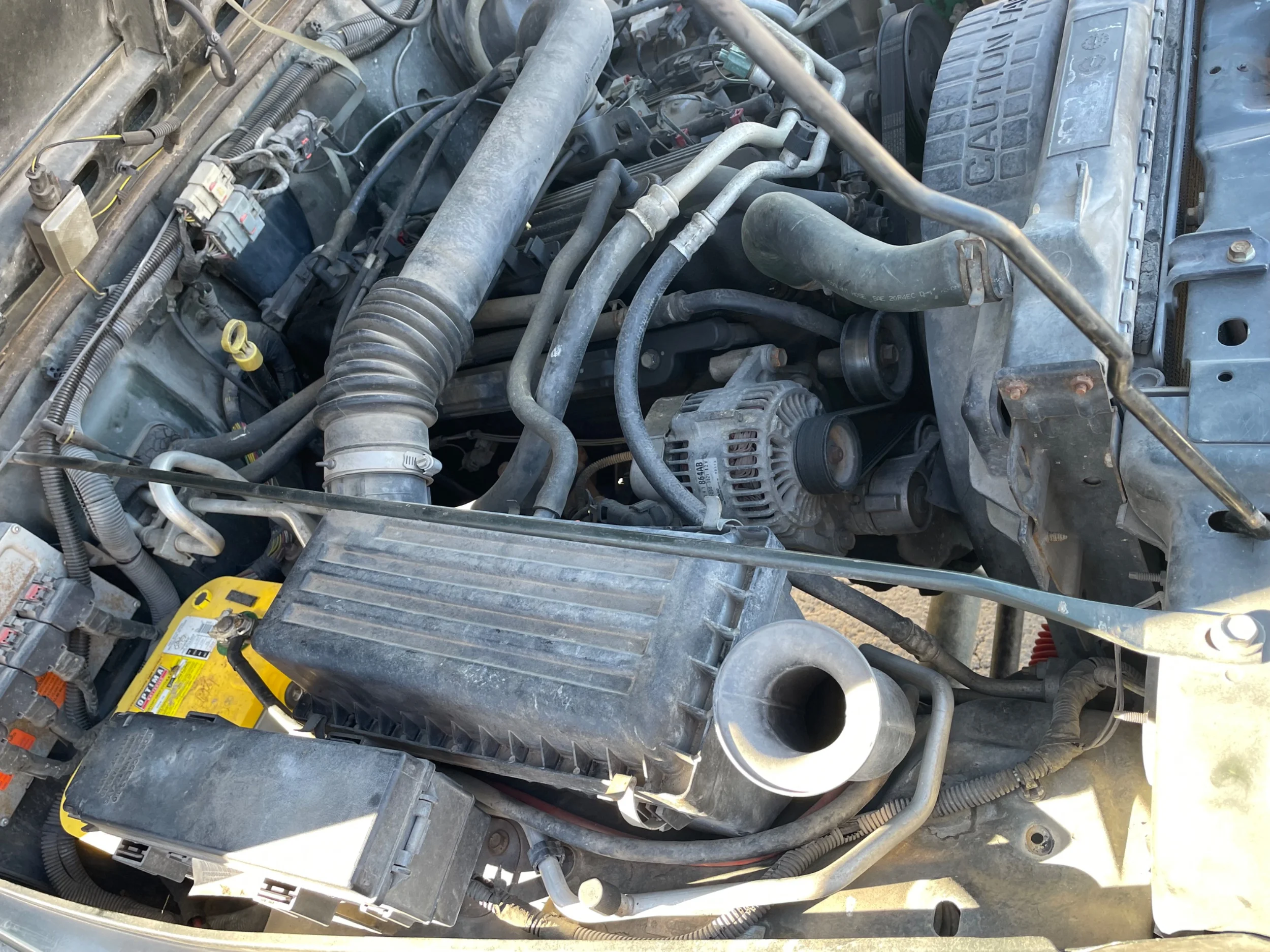

Engine is a 4.0 6 cylinder, automatic transmission, 4wd, I am not sure of the gear ratio but think the rear has a Dana 44 on it. And do you’ll have recommendations for all terrain or all season tires?

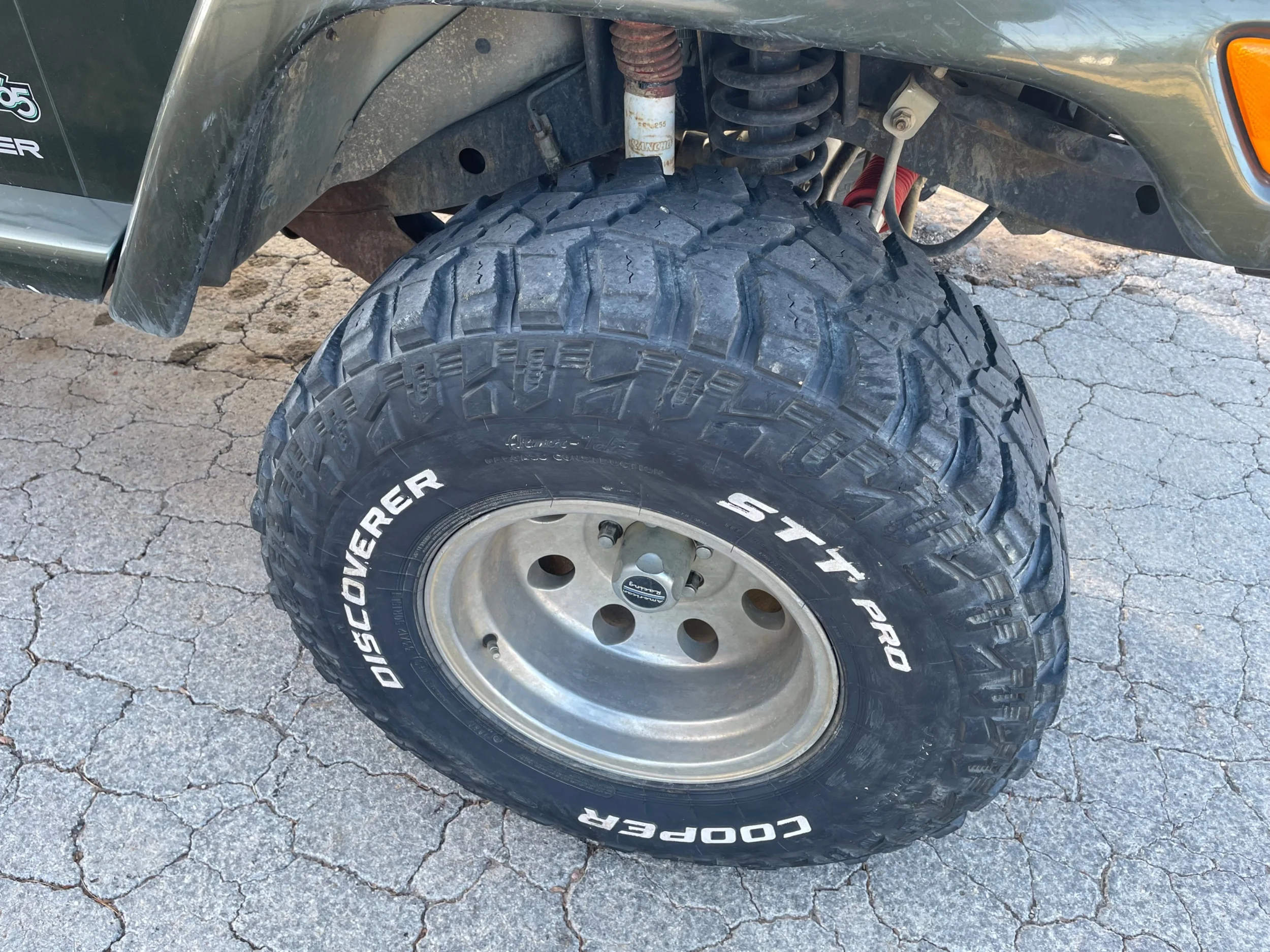

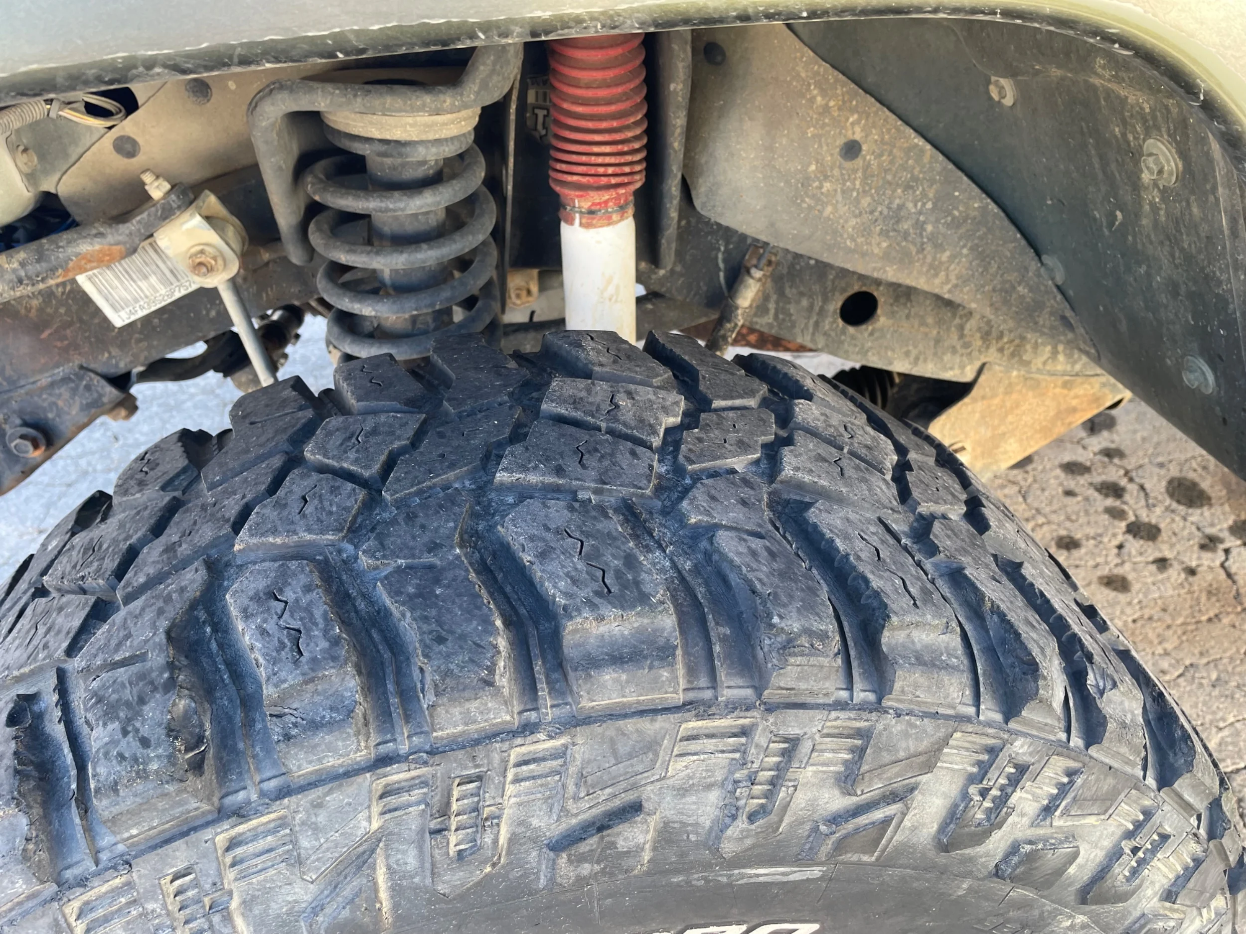

Check the tire pressure. 33s should be around 25psi. After that, shocks are what determine the ride quality.

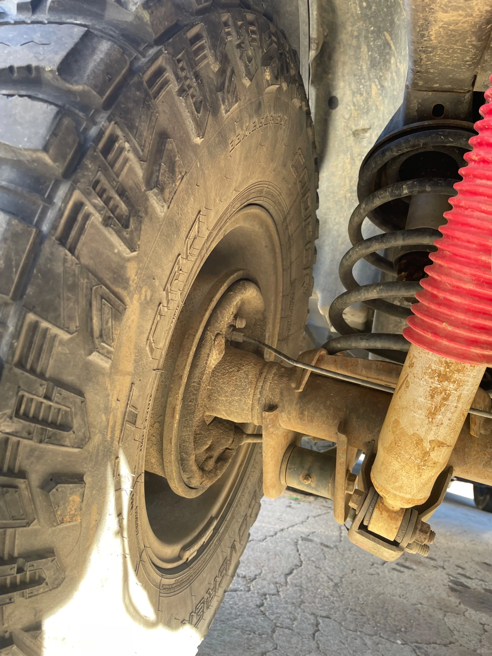

Correct on the Dana 44 out back.

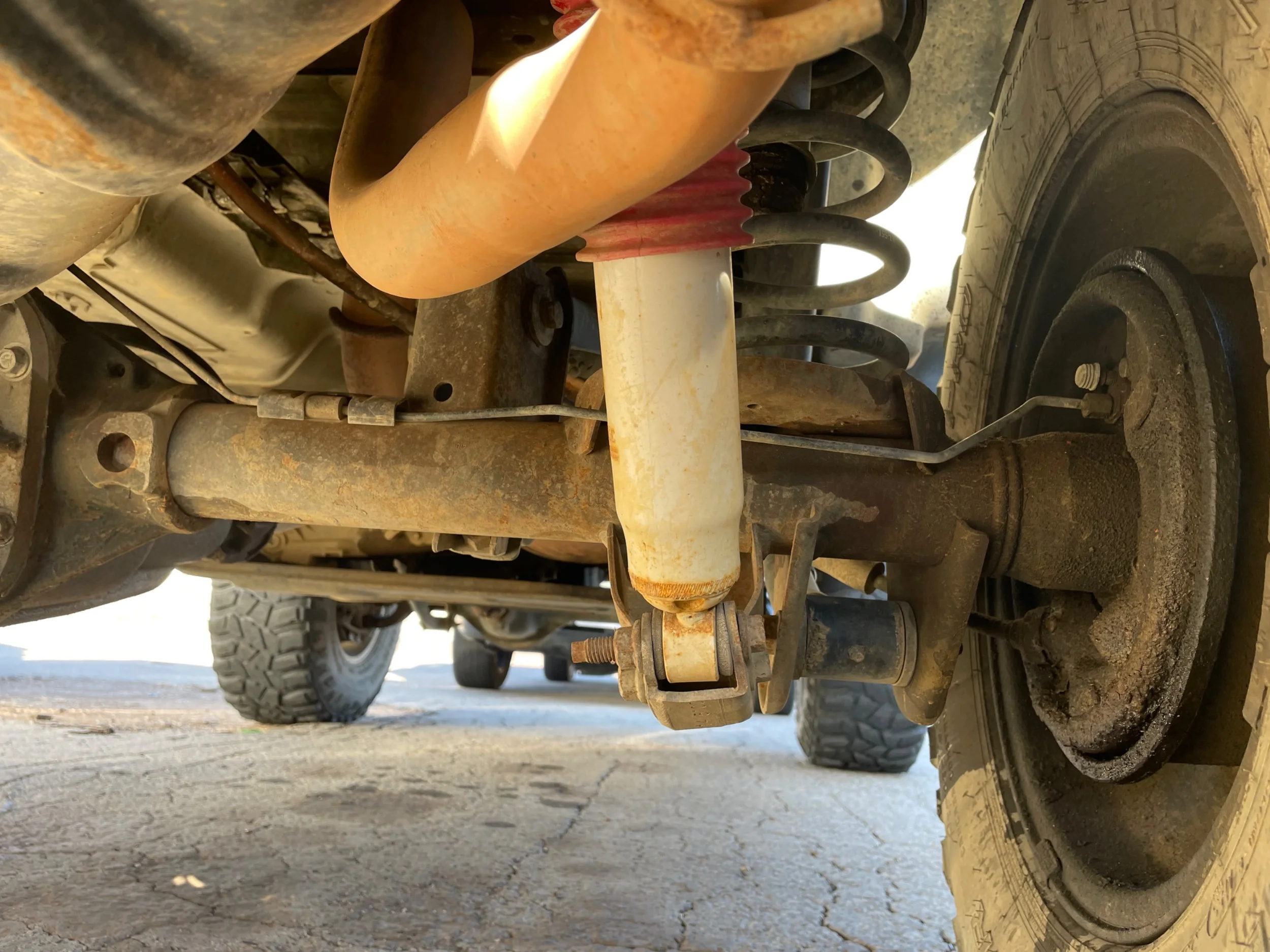

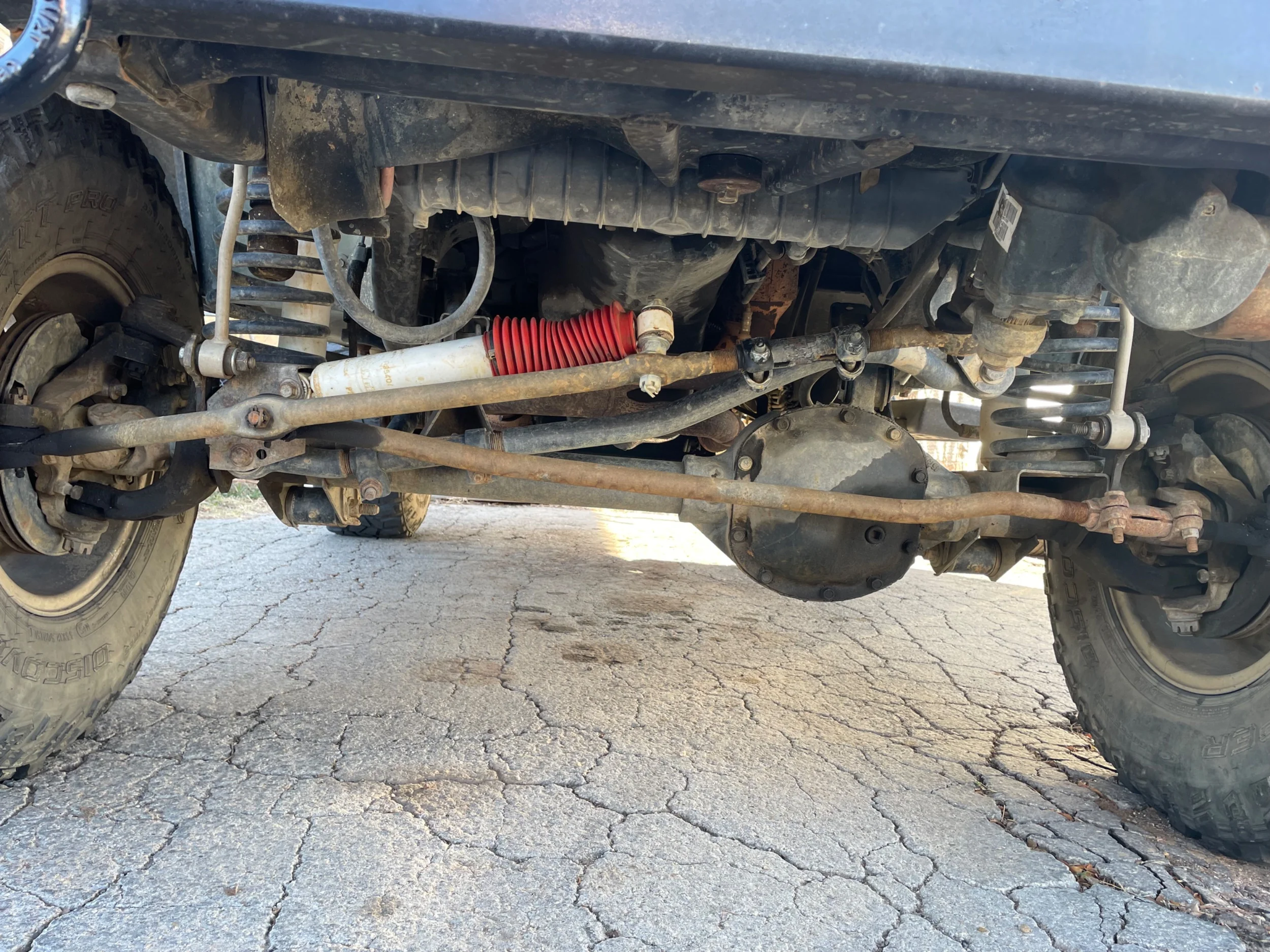

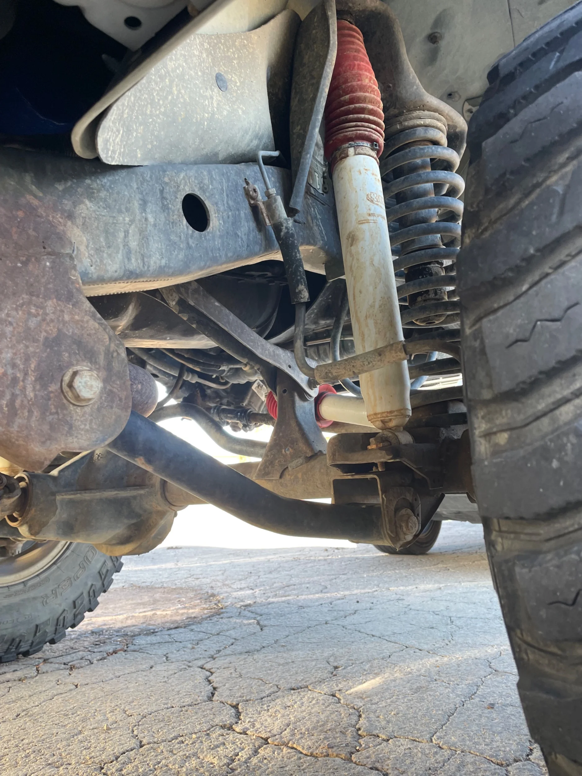

You're in TX so rust is less of a problem but who knows where the Jeep spent most of its life. Drill some drain holes in the frame, treat the inside with some Fluid Film and if you care, clean the outside of the frame and give it coat of POR15.
Might want to swap the battery cables.. those look like the originals. JeepCables.com

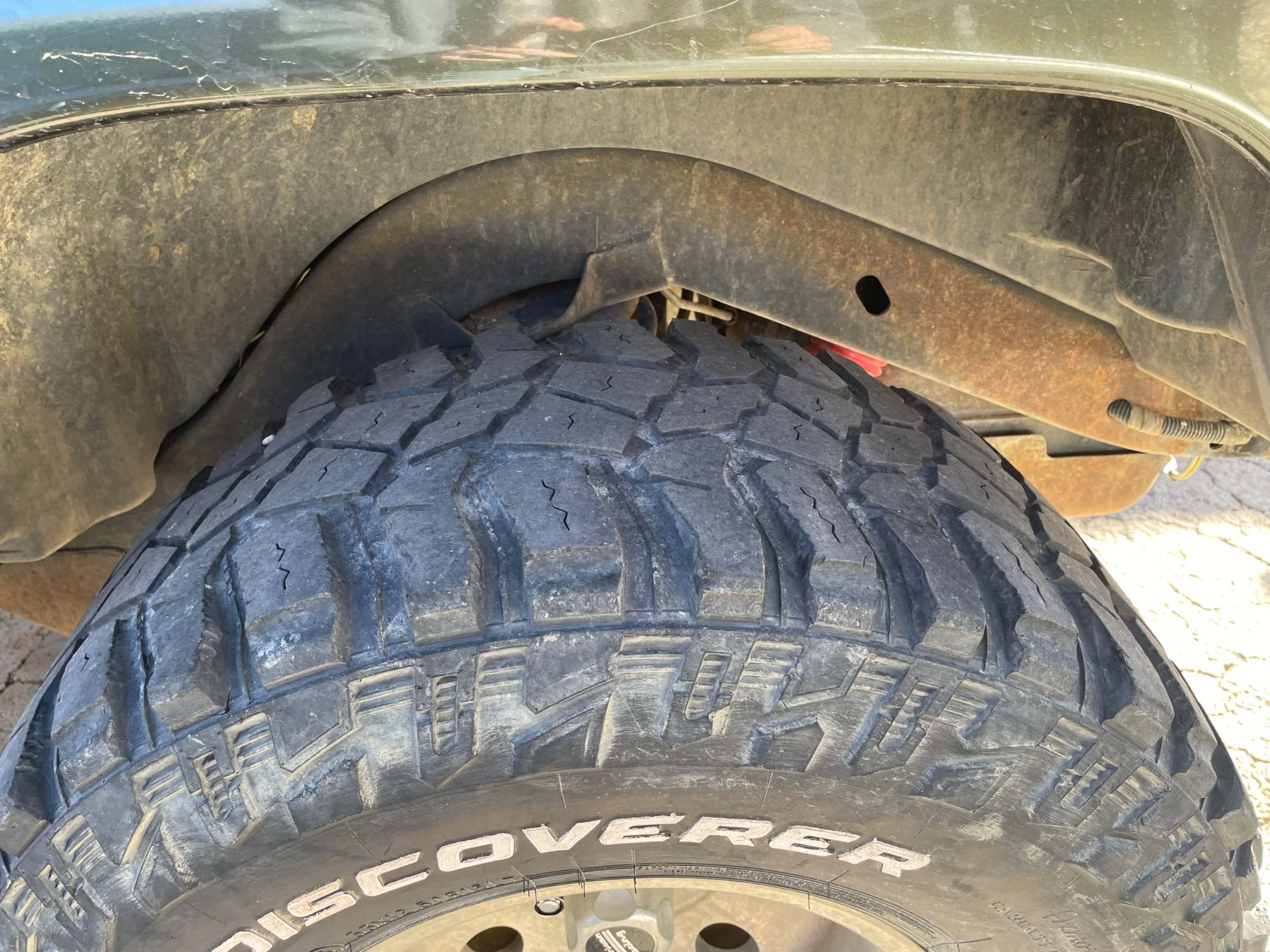

Tires.. You're ready for a new set. Though there is still some life left in them, might still make sense to change since you'll be commuting. I have Falken WildPeaks. I daily drive mine. Like them well enough for four season use, but I see snow up this direction.

Change all the fluids. Go hose by hose and change any that are looking brittle.
The ride.. no reason it can't ride like a dream. Start with tire pressure... notoriously set too high. Maybe the cause for the excessive wear in the middle of your tires. Generally agreed upon 26 - 28 psi will result in a better ride. I have 33x12.5 on similar (if not the same) wheels. Tire pressure is 26psi unless loaded for camping. Ride quality is great. Makes me giggle when I drive it.

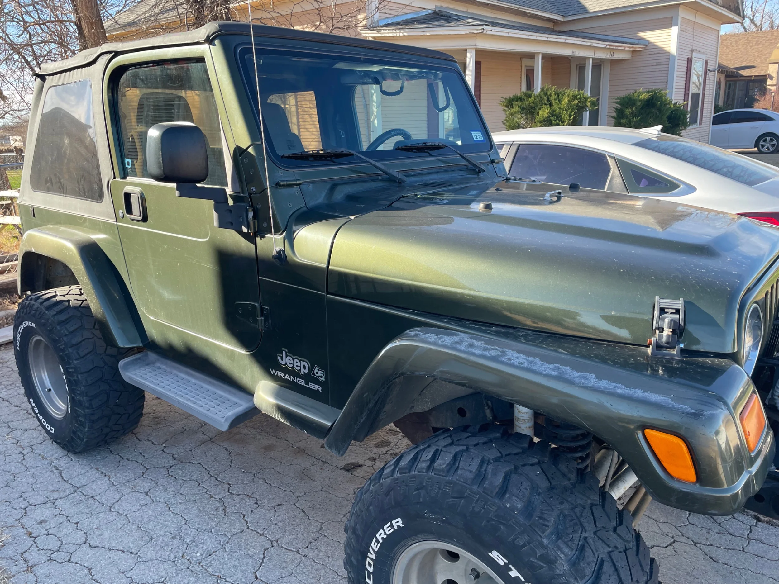

First image shows just a peak of your headlights. Do yourself (and others) a favor and get rid of the OE sealed beams. Tons of options, but the Toyota/Koita H4 kit is hard to argue against. H4 replaceable bulbs, HD harness to run higher wattage if you want and typically less than $40 for kit of late. There are a bunch of threads on this. Dig around.

So my tires are at 31 psi so I’ll hook the air down system to em and drop em to 28 psi and see how that is and adjust if needed. I’ll look into the headlights you suggested, and tires. It has 188,000 miles on it. It has only had 2 owners before me in Texas, that doesn’t mean they only used it Texas. The shocks are ranchos 5000s so my upgrade to the 9000xl. You’ll are all awesome thanks.
