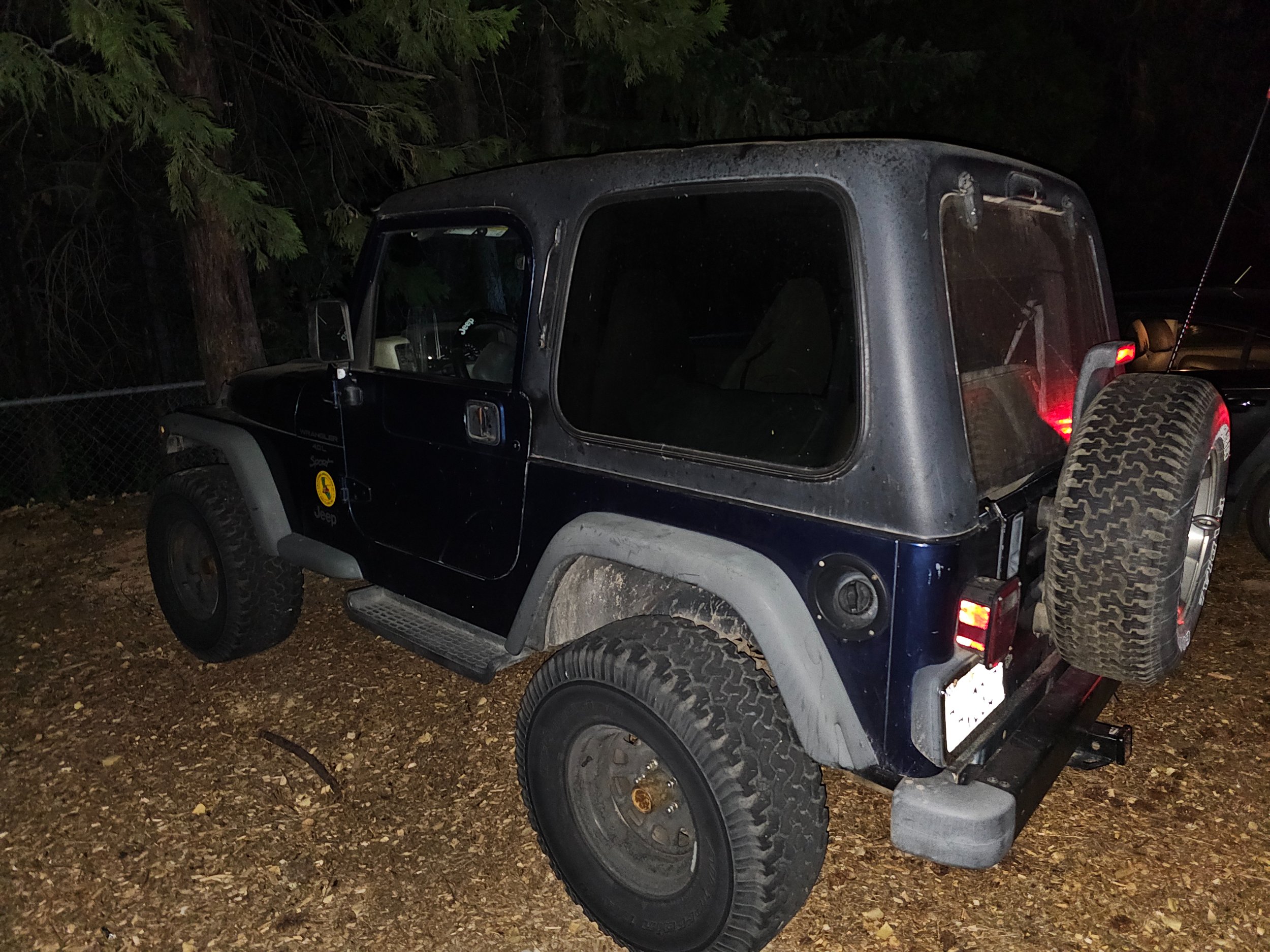

I just bought a TJ! It's a 2000, 4.0, 5 speed.
My first Jeep, first 4x4, first manual transmission. I have a lot to learn View attachment 564486
The person who "taught" me how to drive the stick doesn't really know what they're doing either, just enough to make it work. We were shifting at about 2k rpm. I did some reading and found it should be more like 3k+.
