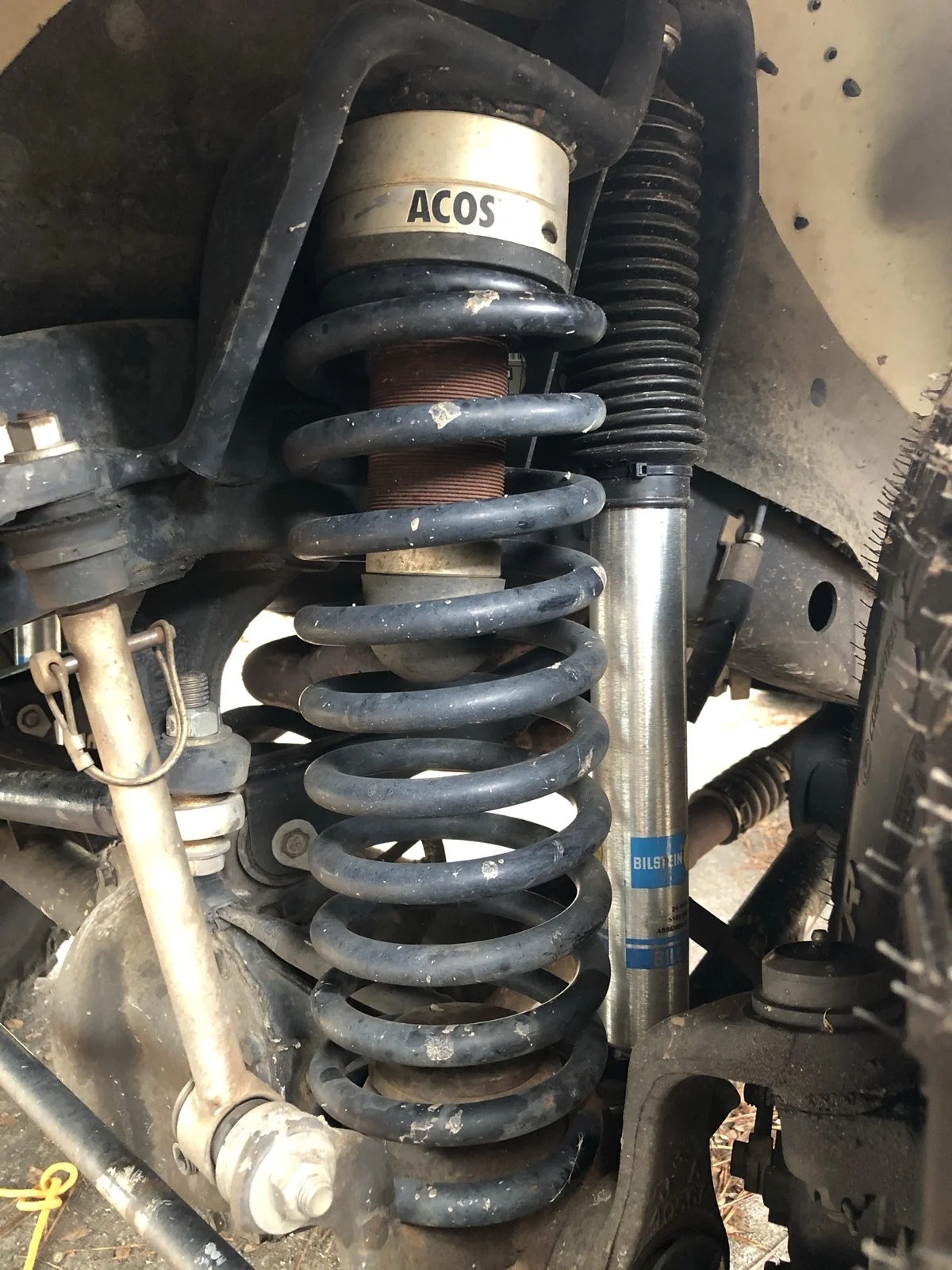

What I'm dealing with is what looks like a black diamond lift, probably 3", its hard to tell. Up front the former owner installed a set of JKS ACOS adjustable coil spring spacers; I'm not sure why, maybe he was trying to compensate for sag due to the body armor bumper and 9500lb winch on the front. Anyway, its now sitting higher in the front and low in the back. So, I'm considering three options here:
  1. Replace the springs (and maybe the ACOS) with better springs that will give me about the same height all around as the front end is now, I think its 4", again hard to tell. If I keep the ACOS I'll get 2.5" lift springs in front and 4" in the back, I think, not sure on how to deal with the ACOS.
  2. Install a spring spacer on the rear springs to level out the jeep and leave it.

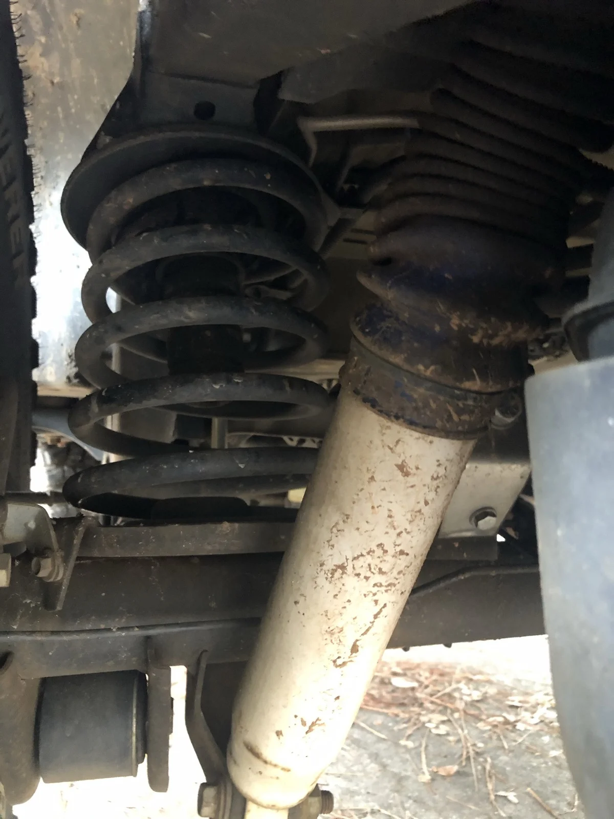

So, my first question is do I need to worry about anything by lifting the back end up to what looks like a 3.5-4" lift? I was under the impression that the Rubi does not have driveline angle issues so I wont need to lower the transfer case. Any reason not to swap out with 4" Currie or OME springs?

Here's the front suspension
Rear
I think 4" might be too much, even for a Rubicon stock shaft. Maybe if it was an LJ.
Looks like the Acos is at its minimum setting, so it's just a fancy spacer. If you decide to replace them with new springs, you'll need bumpstops.
Are the control arms adjustable? Going over 3" on a TJR will require a new rear DS and adjustable arms in the rear. If it were me I'd decide on the lift height you want, ie 3" or 4", then replace the shocks, ball joints, etc., first.
Reactions: JMT
Yeah I was just looking at the driveshaft it’s real short. I think I would need a CV type drive shaft. Already have adjustable control arms.
