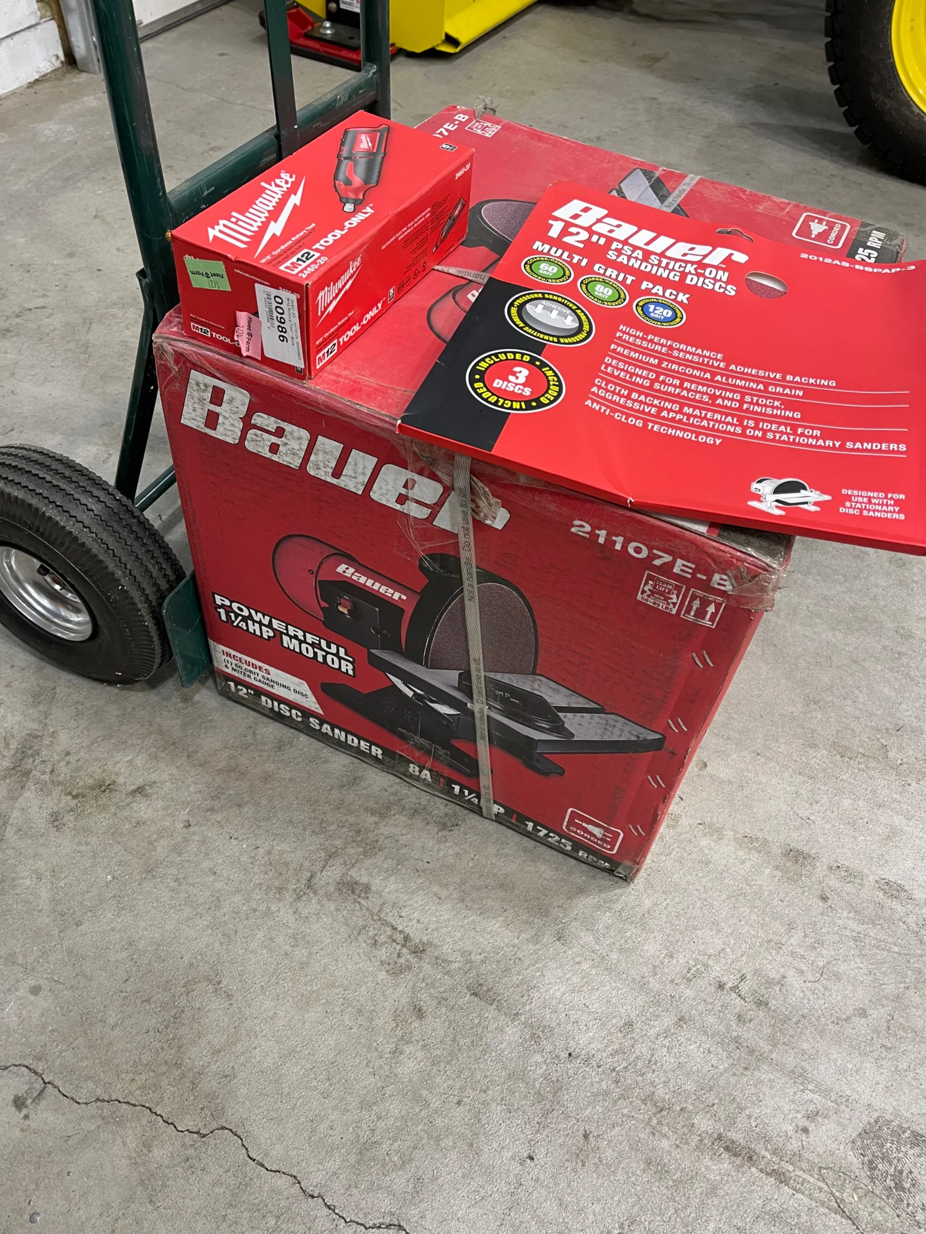

I solved a couple of needs with an M12 rotary tool and a 12” disk sander.
I definitely like my M12 rotary tool. Lots more power than the cordless Dremel I had.
High speed, but low torque. The wheel tends to stop rotating if you apply slightly too much pressure. Drains batteries fast as well. Good tool though, good for using with a wire wheel to knock off rust or scale before painting, but for sanding or grinding it's just too weak.

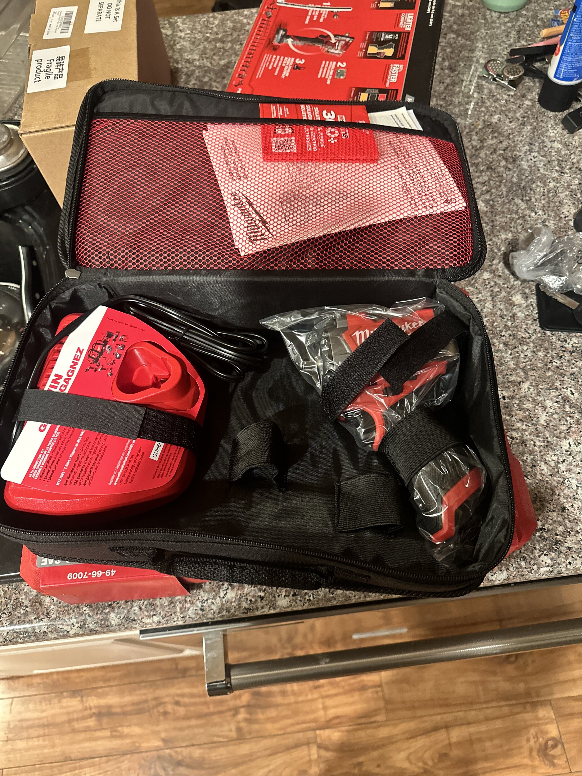

Milwaukee 2562-21
Bought this over a month ago, then bought another one because someone stole the first one 😭😭
By far one of the niftiest impacts I’ve seen and used, the power to size is ridiculous. The kit comes with the new 5.0 hight output m12 battery and charger and I highly recommend that route as the stubby needs the more optimized cells in the 5.0 high output.
Milwaukee 2562-21
My m12 stubby impact, rachets, drill, and sawzall have all performed fantastic. 10/10 on all of them. The rotary tools I would give a 7/10, just too weak. m12 is perfect for DIY but if I was buying for pro use I would go with the m18 versions.

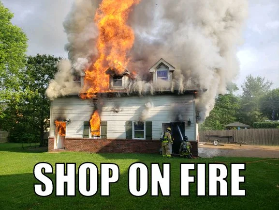

Grease and rags will burn so a metal container is ideal but nothing that goes in a grease gun will auto ignite. Only oils that cure/harden do.
Definitely happens. This is my good friend Brian's custom-built shop. He was doing some wood finishing and left a few rags soaked in something like poly or varnish in the trash can. Burned to the ground. Total loss with a couple of very nice custom cars in it.
He called me afterward and asked if I knew finish-soaked rags could ignite - which of course I do. Nasty stuff if you are not careful. When I finish a project, I leave those rags spread out on the driveway until they dry completely.

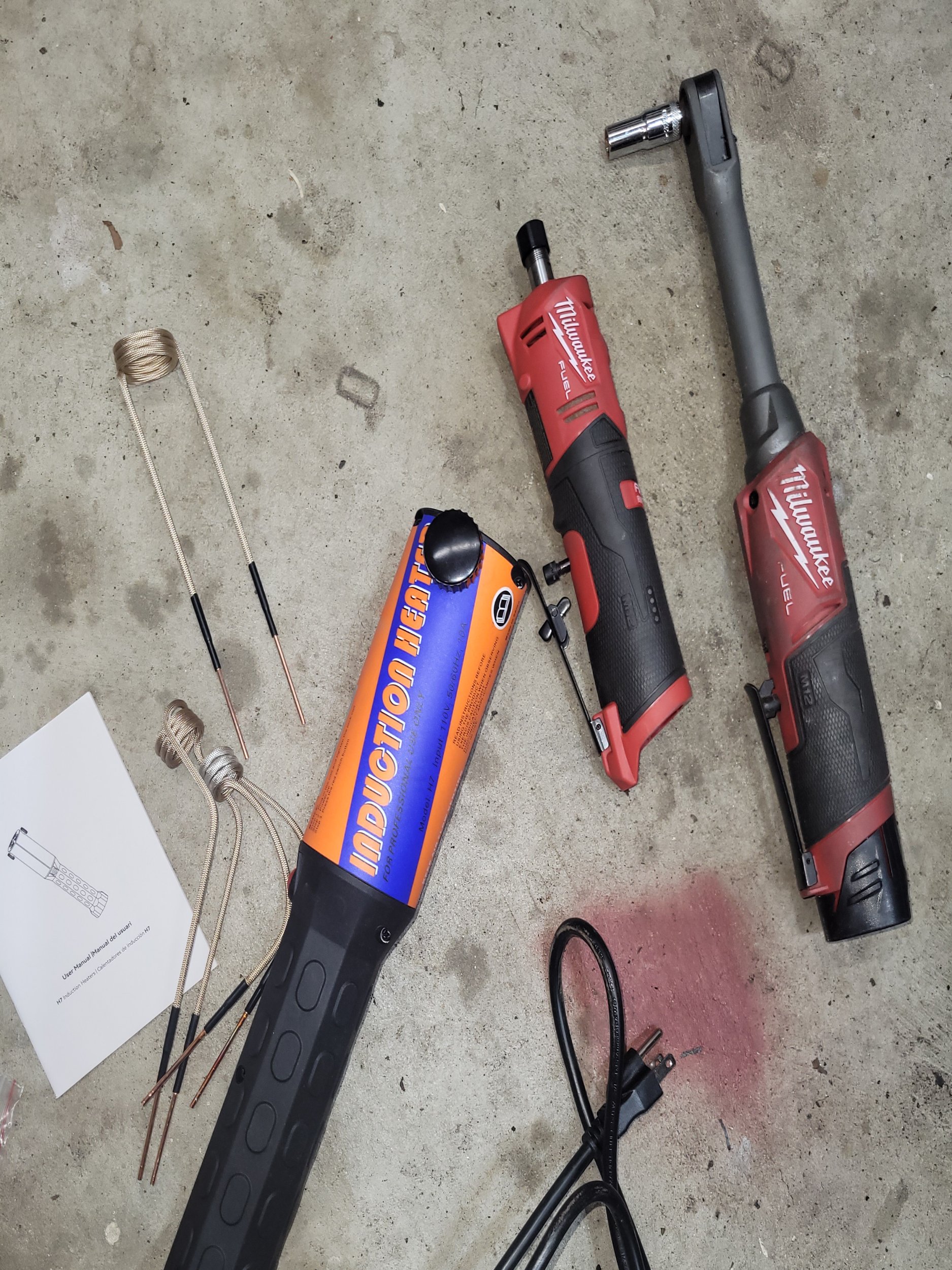

Three new tools that have been rather handy.
The Milwaukee ratchet, which I've had for about 6 weeks now, is awesome. No more ratcheting a click at a time in tight spaces.
The electric die grinder is awesome as well. Makes it easy to cut and gind in tight spaces. I've had it for about a week. The grinder uses batteries pretty fast though. I just ordered two knock-off batteries to see how they do. These are the only Milwakee tools I own other than my worm drive circular saw.
The last thing is the induction heater, which came yesterday. I ordered it after the list of stuck bolts I still need to deal with was growing (If I convinced myself a bolt was going to break in a way that I would be very challenged to remove it, I would stop whatever part of the process that was and move on to something else). I broke down and bought the heater. It worked great today when I finally installed the M.O.R.E steering shaft riser I had postponed since it had a stuck bolt connecting the upper and lower half of the shaft was going to break if I kept trying to remove it (head was flexing but the other end of the bolt was static). The heater made easy work of it. When I reassembled everything I used plenty of antiseize since it was a steel shaft and bolt connecting to an aluminum yoke.
I've never seen an induction heater before. Do you have more info on it?
Reactions: srimes
I like a pencil-tip butane torch for heating fasteners. Just direct it to the head or other end. The big advantage over an induction heater is it works on fasteners with no protrusion and broken-off fasteners. With the broken fasteners, I'll use a bit of heat before trying to remove them. The heat will cause relative movement between the male and female threads, and often, that is just what the doctor ordered to break the chemical bond that forms over time. This method worked great for removing those dreaded Torx bolts in the door hinges. I didn't break any of them!
