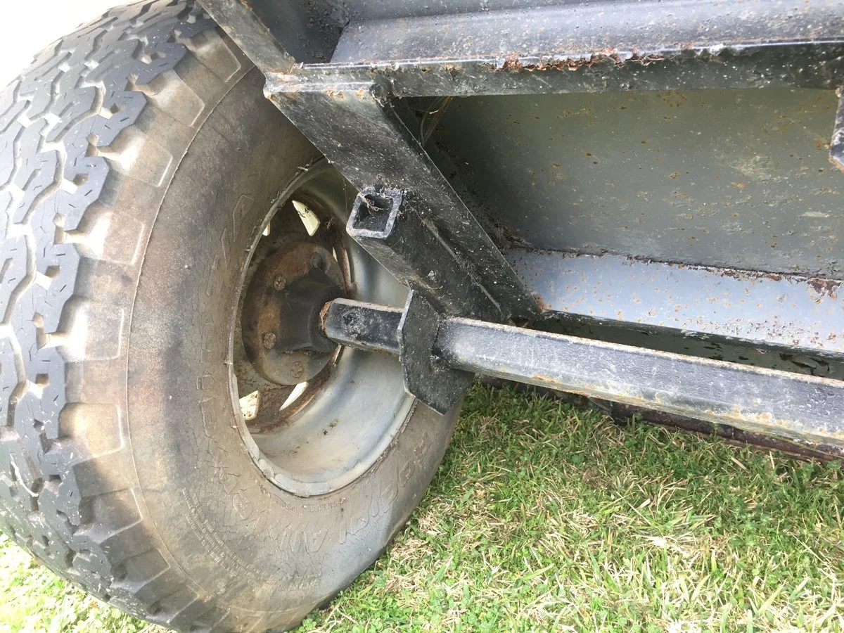

@lowranger , did you happen to find details of what axle you used? Did you have to modify it much to fit the trailer?
One of the pictures I’ve came across looks like it has a bar/axle spanning from side-to-side. I’m now considering trying to find one a little cheaper than the Timbren axle-less ones. I don’t really need the ground clearance for it, plus can save a little money.

No, I couldn't find the receipt on where I ordered the axle from. I didn't have to modify it at all. I ordered it to fit. Measured the width of the trailer frame and told them what I wanted.

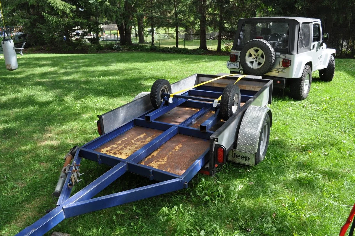

The price of used trailers can be all over the map. Granted, a lot depends on how much of a "starter kit" it is. My off road trailer build ( http://www.jeepcentral.ca/forums/showthread.php?3937-PCO6-s-Trailer-Build ) started out with a $200 find on Kijiji. I saw it in the morning and had it home later that day. If you're able to act quickly you can get some great deals.
This summer I'll be selling a utility trailer I built. I've been monitoring prices on Kijiji and based on some of the poor examples I've seen that are going for decent prices I should do well. I may even get my money back after using it for the last 10 years!

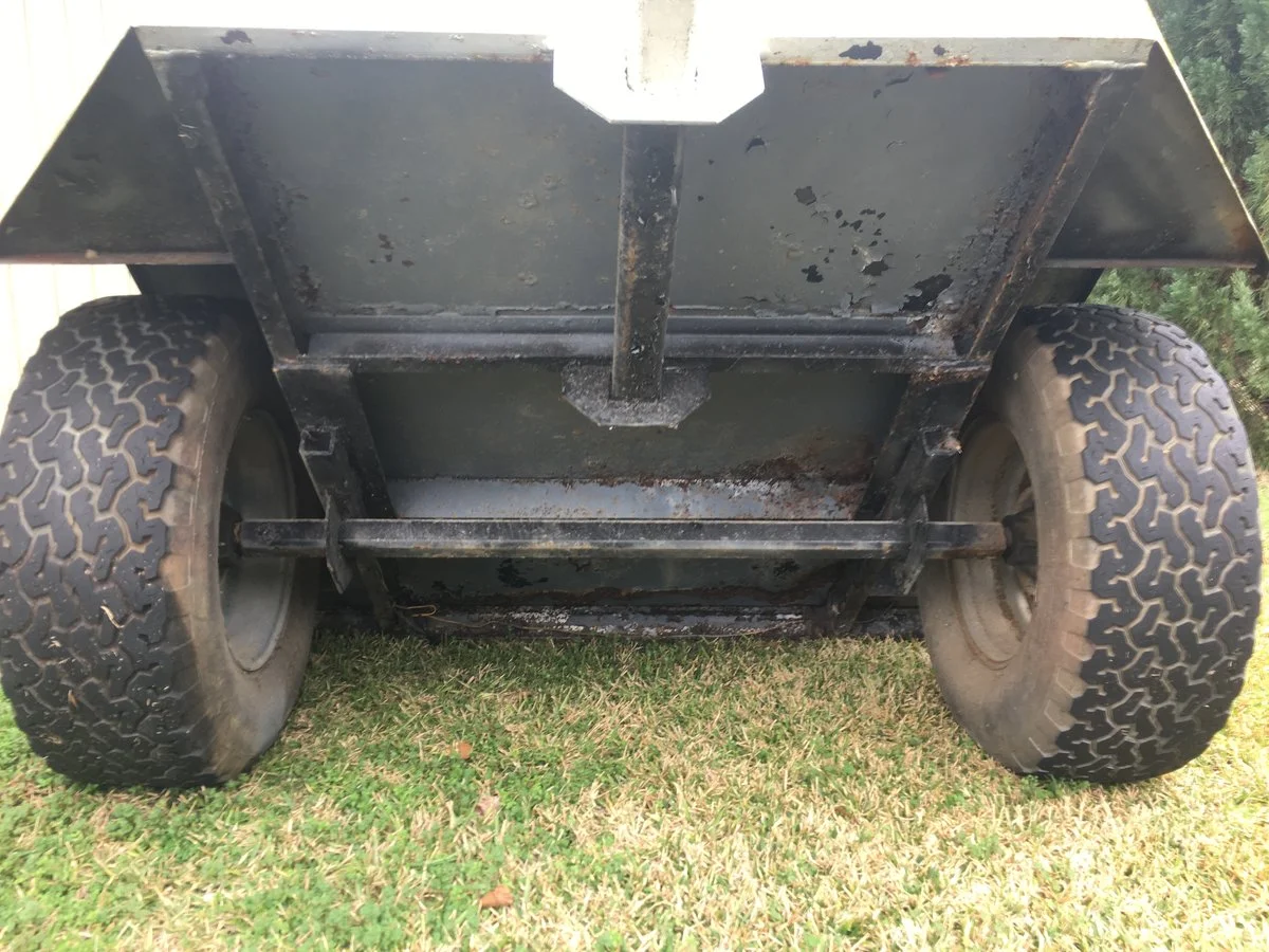

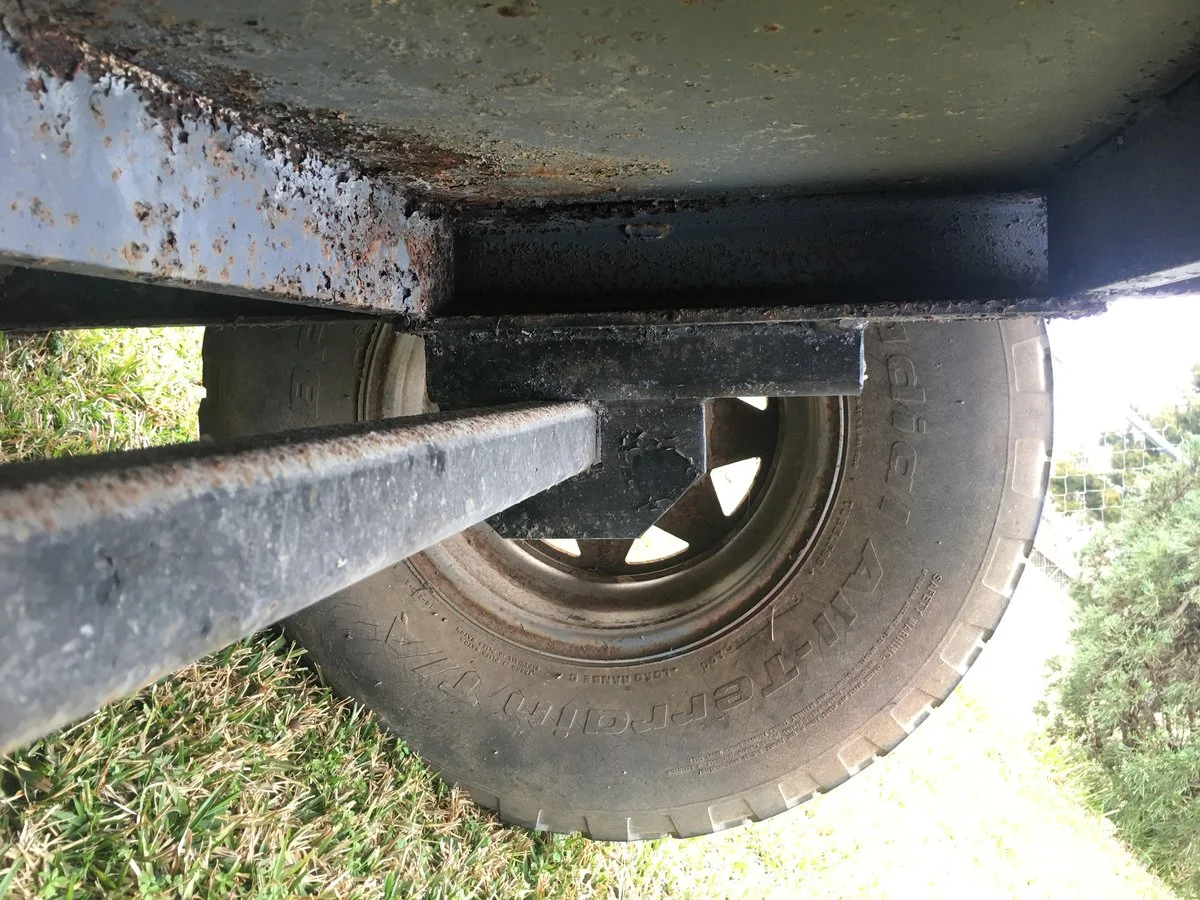

@lowranger , do you know if this is how the original axle is set up?
Just trying to figure out what I'm starting with.

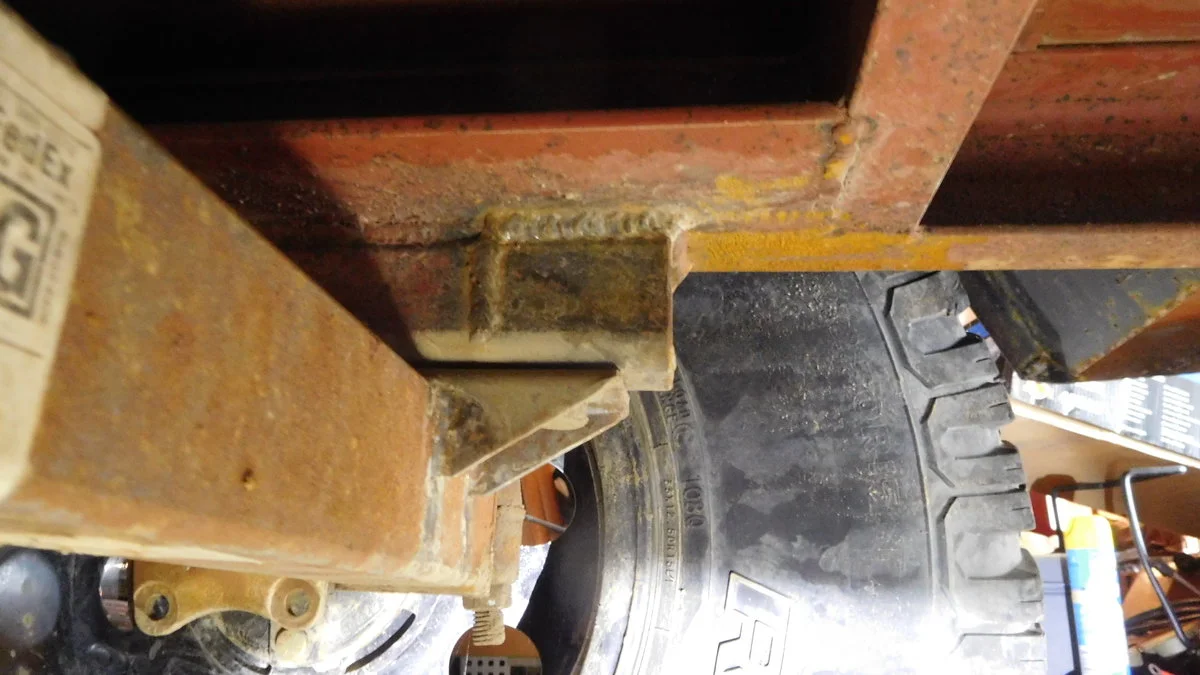

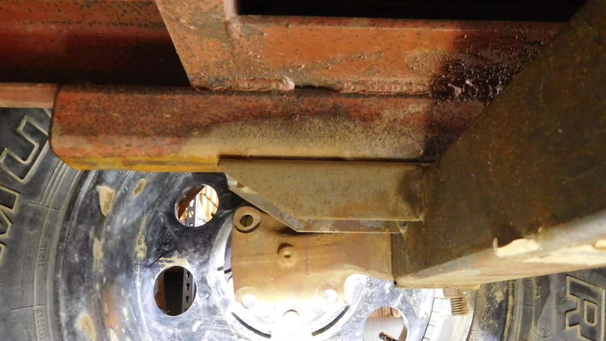

Sorry it took awhile, but here is a picture of my torsion axle bolted on. There is even a part #. I can take more pictures if you need them.
The name of the place I got it from was.
SouthWest Wheel Co.
8740 John W. Carpenter Fwy
Dallas Texas 75247
214-631-0200
They were great to work with. I called them and told them what I wanted and the measurements.
I went with a 3,500 lb axle. I don't think you really need that much. I would go with a 2,000. Would probably ride better.
I left the 2"x2" tubing they have on there, had to extend it out a little and then bolted to that.
