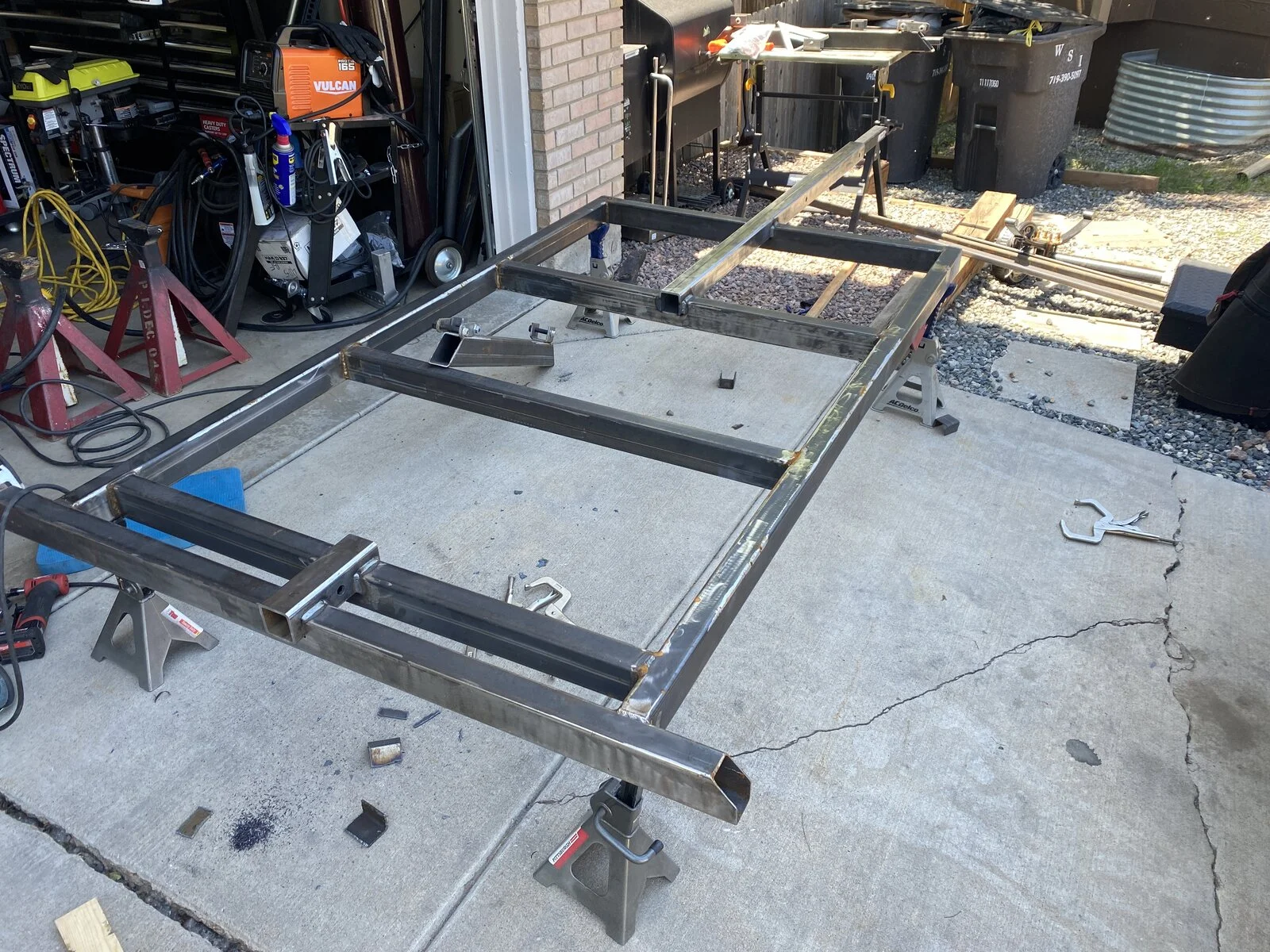

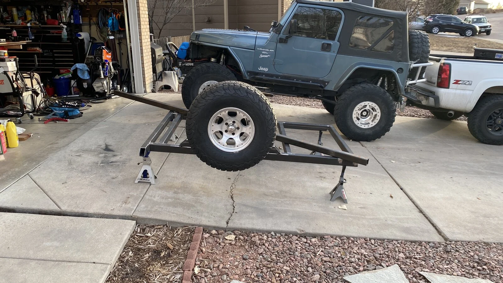

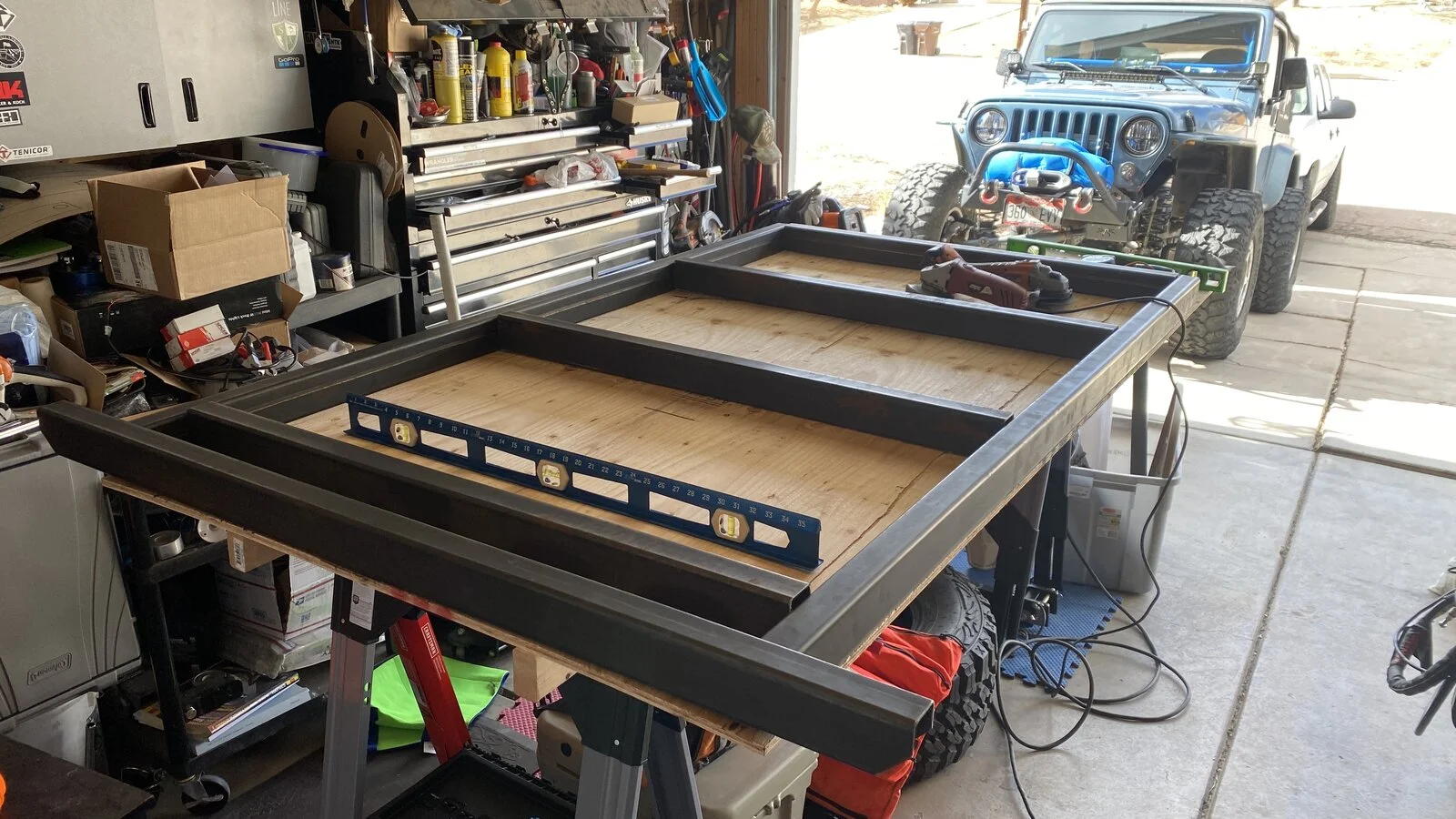

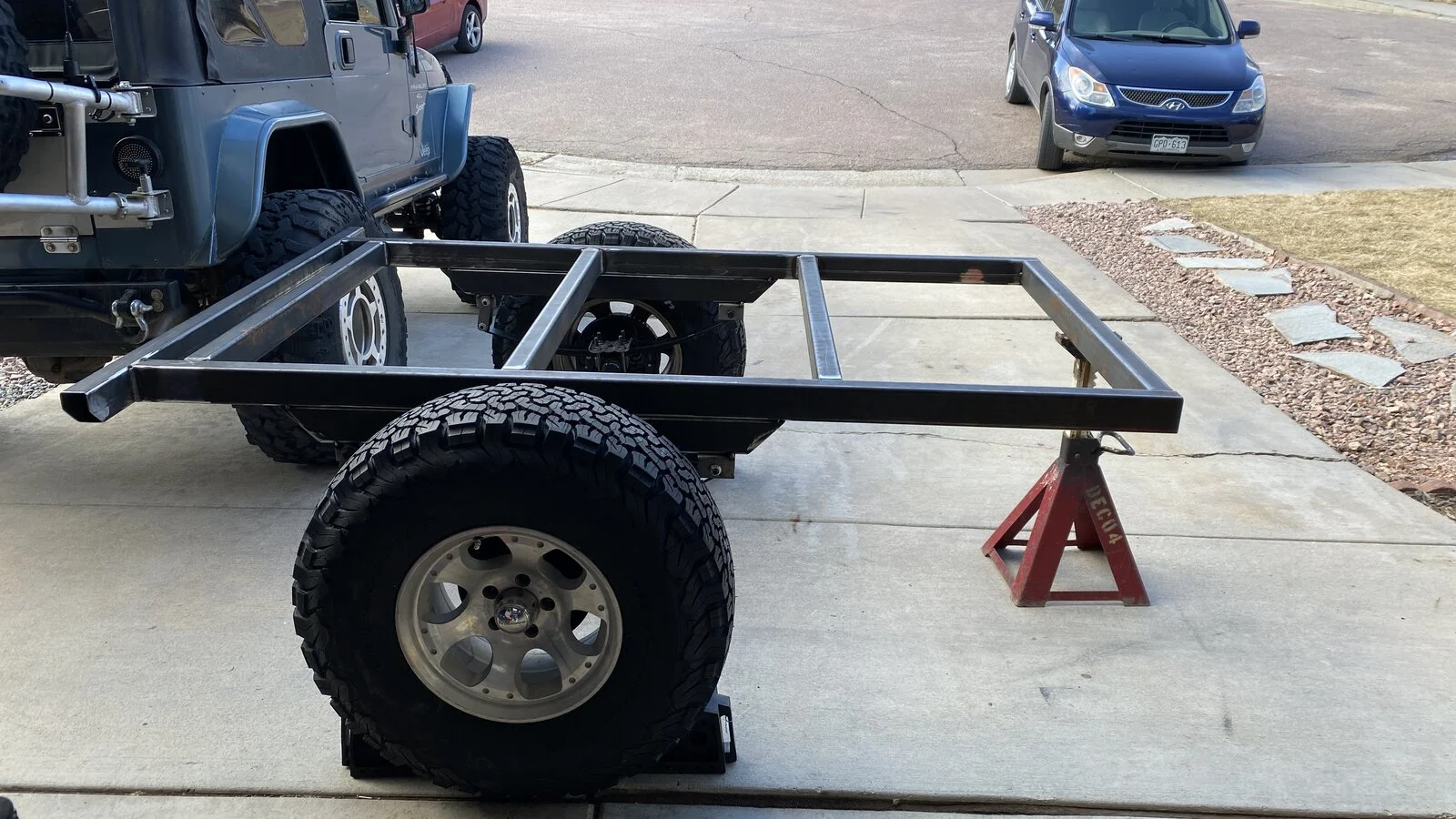

Nice trailers you all have. I sold my old bantam trailer earlier this year and started building a custom trailer myself. It will be on 33x10.50-15 tire and I had the axle made using the wheel offset and tires I got so that it is exactly the same track width as my Jeep. I’m made the frame to have an extendable tongue length so I can shorten it up for trail use and lengthen it for long Highway use. It’s got a 3500# axle with brakes and 2000# springs and will have shocks as well. I using a Lock n Roll hitch set up. It’s still in the early stages. But here are a few pictures. If all my measurements and calculations on what I’m hoping it weighs it should set pretty level with the Jeep.
