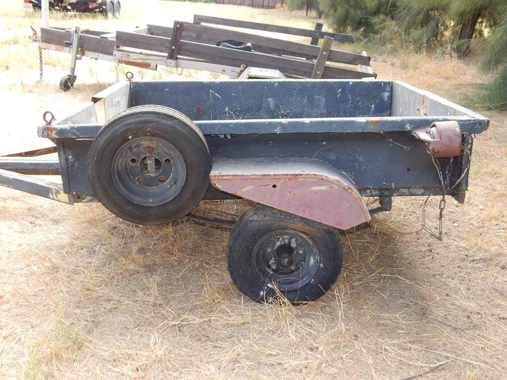

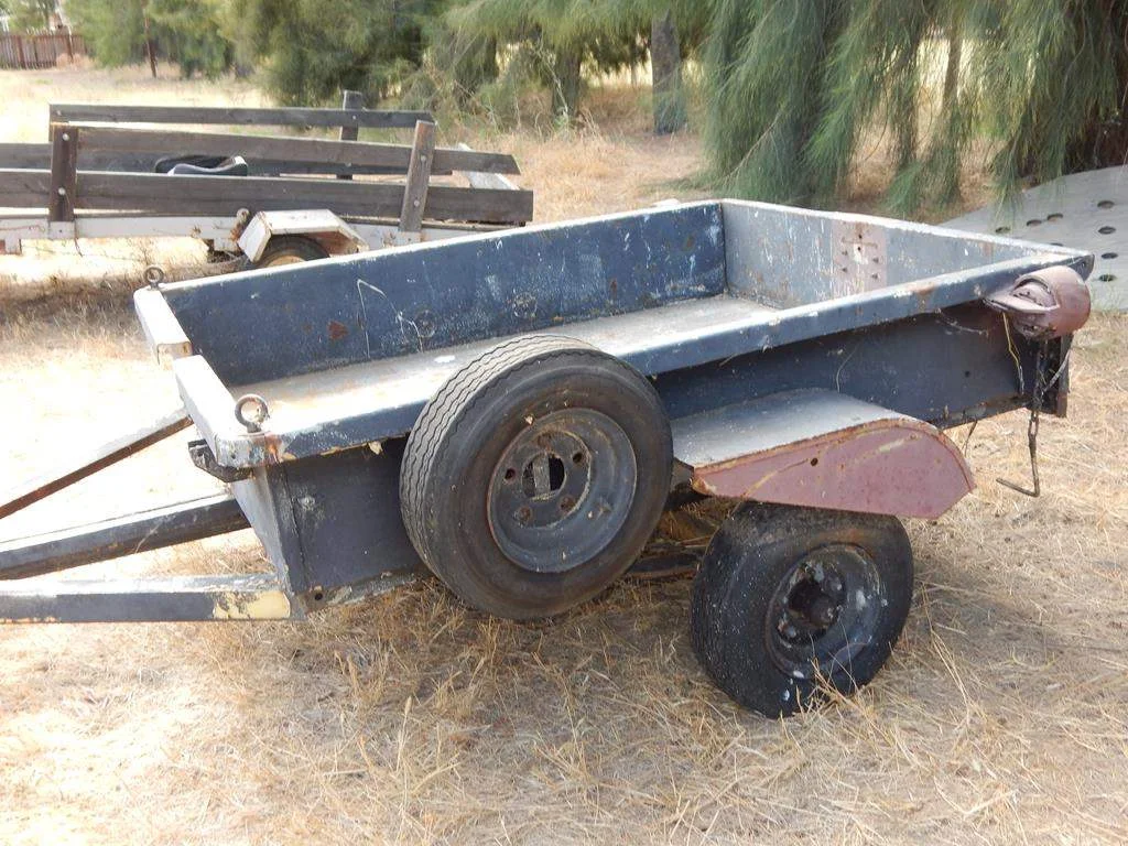

A friend of mine had one of these trailers and I really liked it. Then I saw one at Bugorama over Labor Day and I told hubby that we should tell our friend that if he ever decides to sell his, I am interested. So a week goes by and I was browsing a auction website I follow and there it was! I ended up winning it and we go pick it up tomorrow! :D
I shared it on my FB page and another friend told me that it is a Sears trailer. I did a search and I found out that it was supposed to have a clam shell on top. I guess I need to start learning how to weld. :D The other friend that has the one I liked, just paid a lot of money to have a top made. I want to attempt to make one myself. :D For now though, the plan is to sandblast it and get it cleaned up, weld a piece back in the front to fix the slot the PO made in it, and then paint it. It will still be useful even with out a top. Perfect for my Jeep and my Bus. :D

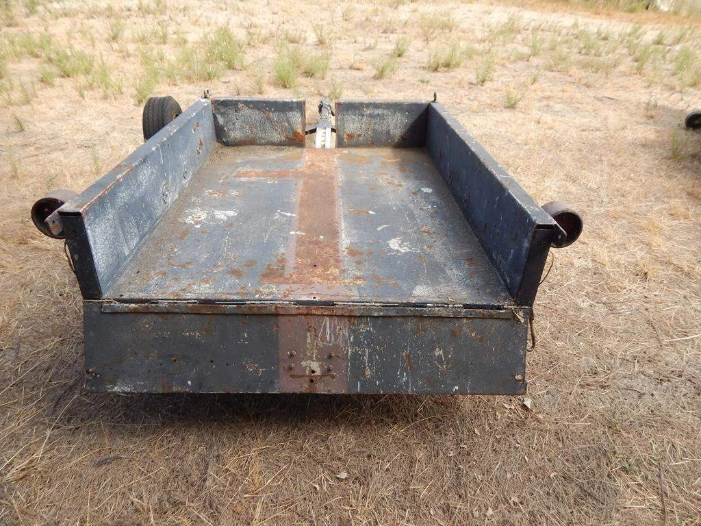

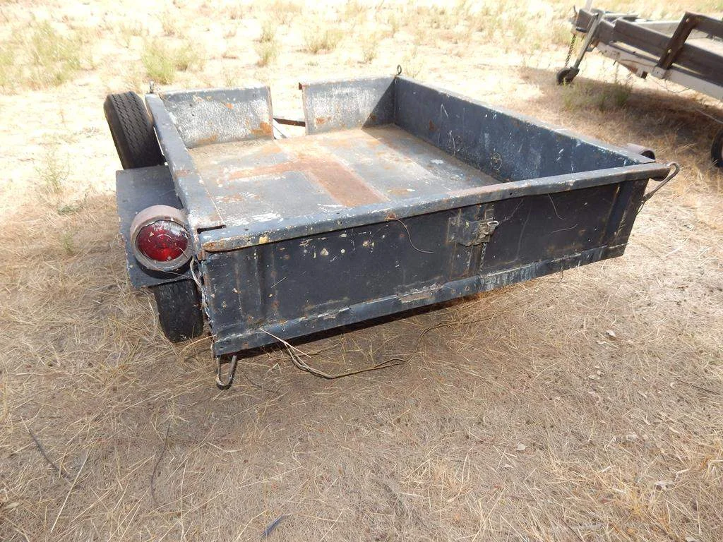

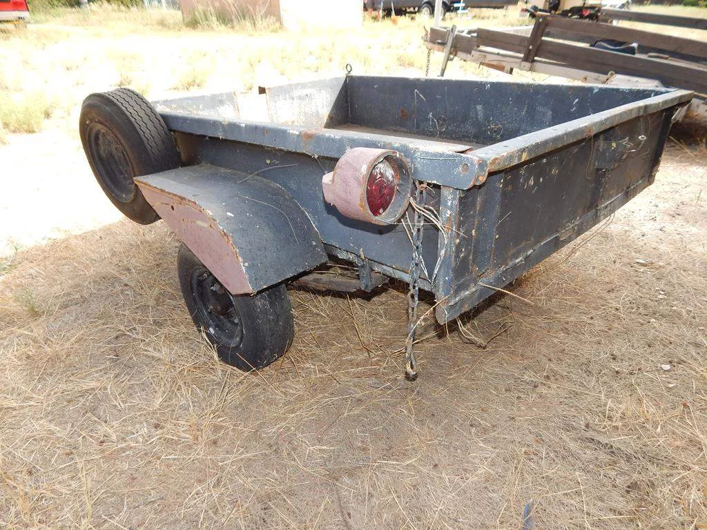

Here are a few pics the auction company took.
You can see on the tailgate that there is a latch, and also a bracket on the front where it used to have a clam shell. I'm going to look around when I am at the place to see if I can see it laying around.
Can't wait to start on it. As of right now I think I want to paint it white, then put the rest of my purple pin stripe material on it. It would match my Jeep really well and also still look good behind my white VW Bus. :D

I also wonder what it was used for that it ended up with the "slot" in the front.
That is a great find. The clamshell top would be very cool.
I wonder how much it would cost to get a used soft top modified. You could have a soft top Jeep towing a soft top clamshell trailer.

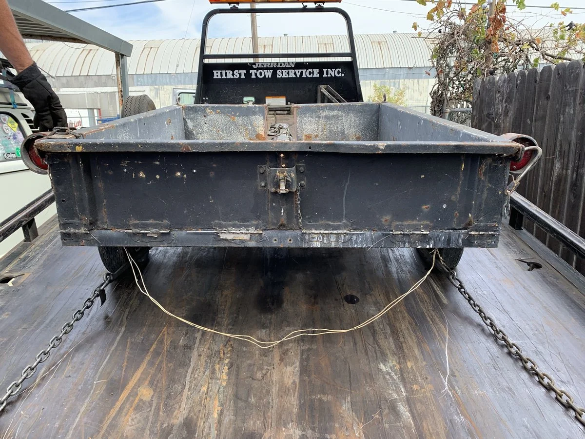

The slot in the front was most likely cut for hauling a motorcycle. It also has a tilt frame which I don't think is original to a Sears Clamshell and the tongue is extended. I'm going to be cutting down the tongue.
We went and got it today and I started working on it right away. We discovered it does not have a tilt. Somebody welded angle iron on the sides of the tongue to reinforce it, most likely to haul an MC. We found out that the tongue actually extends out. In person, it was fine the way it is in the pics, not sure why it looked so long in them. LOL

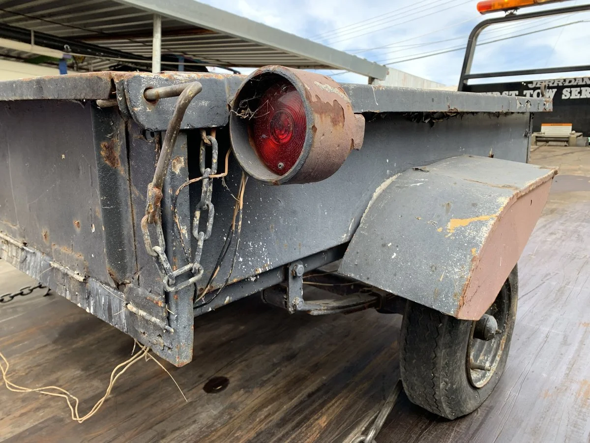

Here it is on the tow truck ready to come home. :D

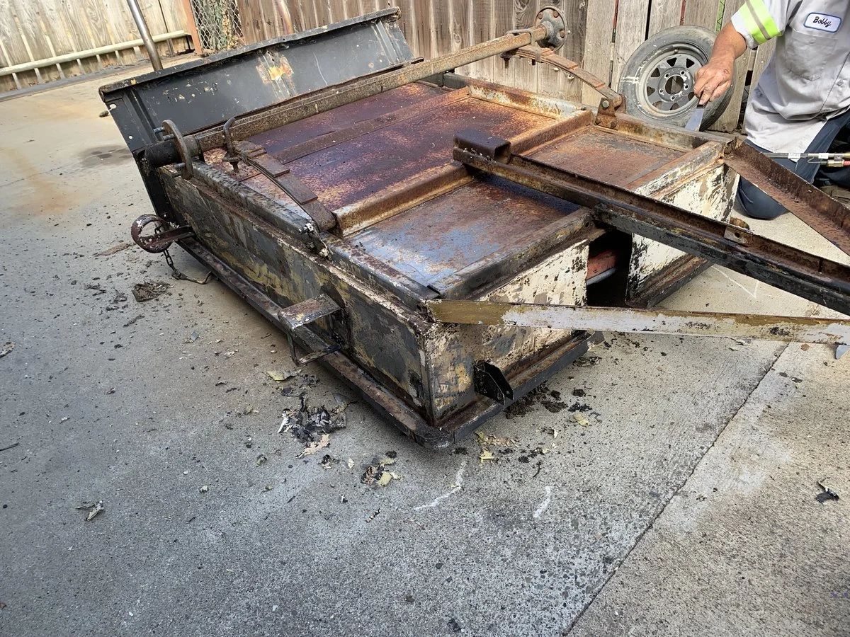

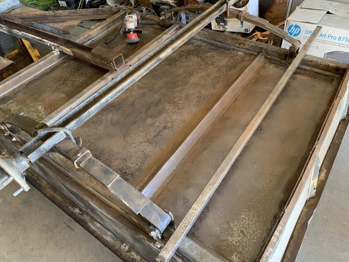

We got it home and flipped it over to start taking all the old wiring off and to see how bad the underneath was.
Some surface rust but not all that bad. Then I started taking stuff off so we could start getting the paint off.

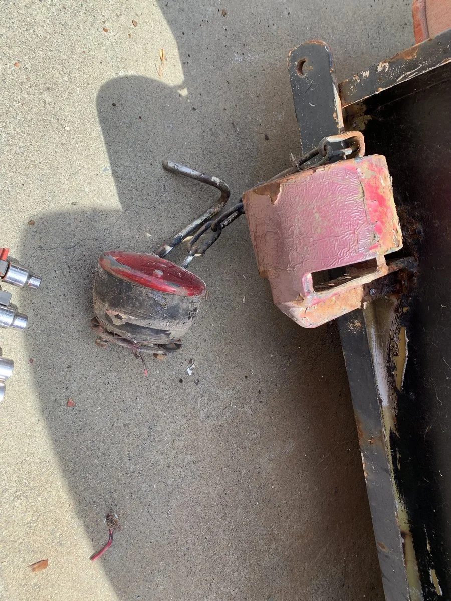

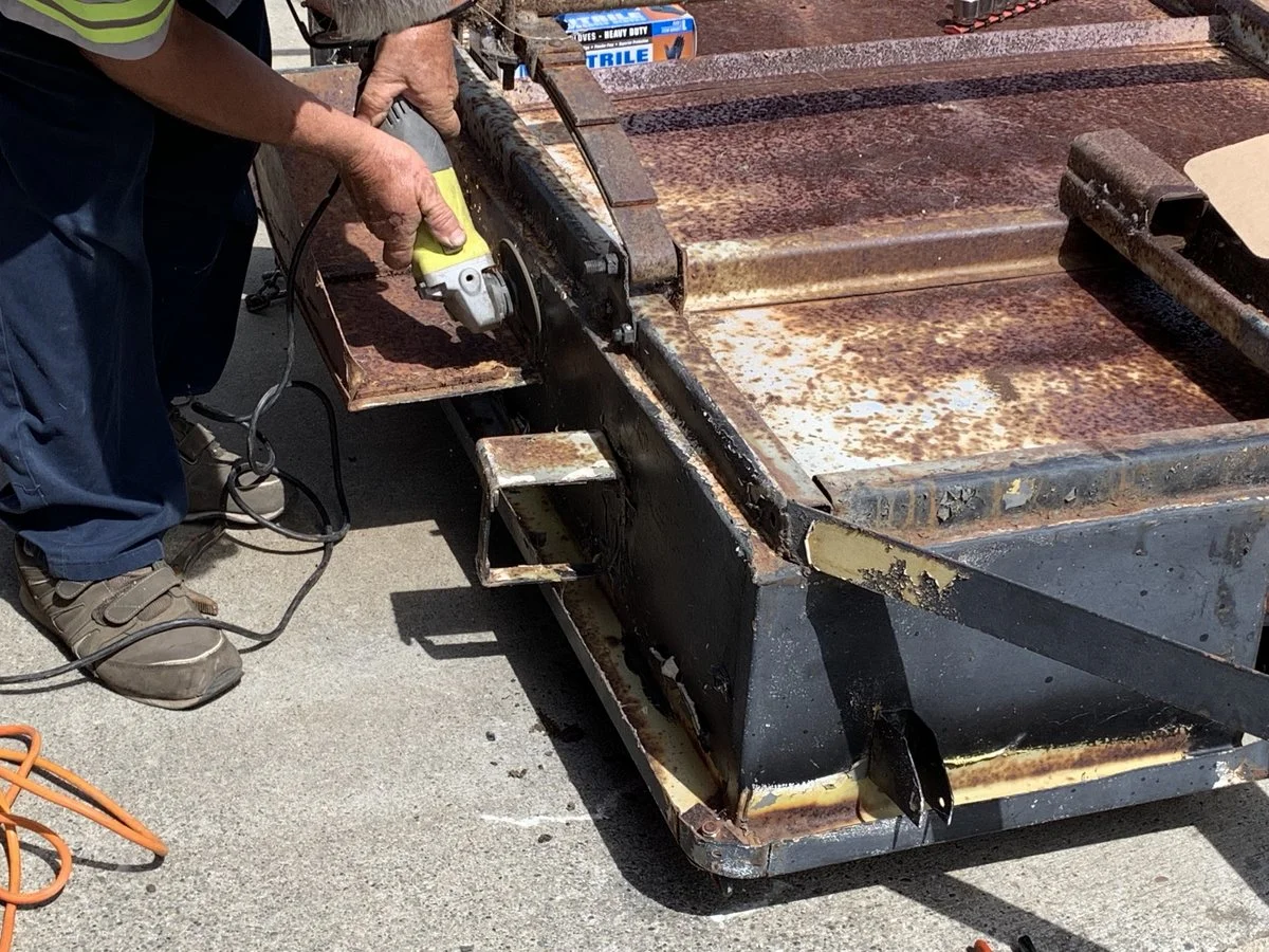

Hubby had to grind most of the bolt off. I can throw the little stuff in the sandblasting cabinet, so that will be the easy part.
We pulled the tongue out so we can clean it up too and make it work like it is supposed to, pull in and out without having to use a sledgehammer to beat it out. LOL

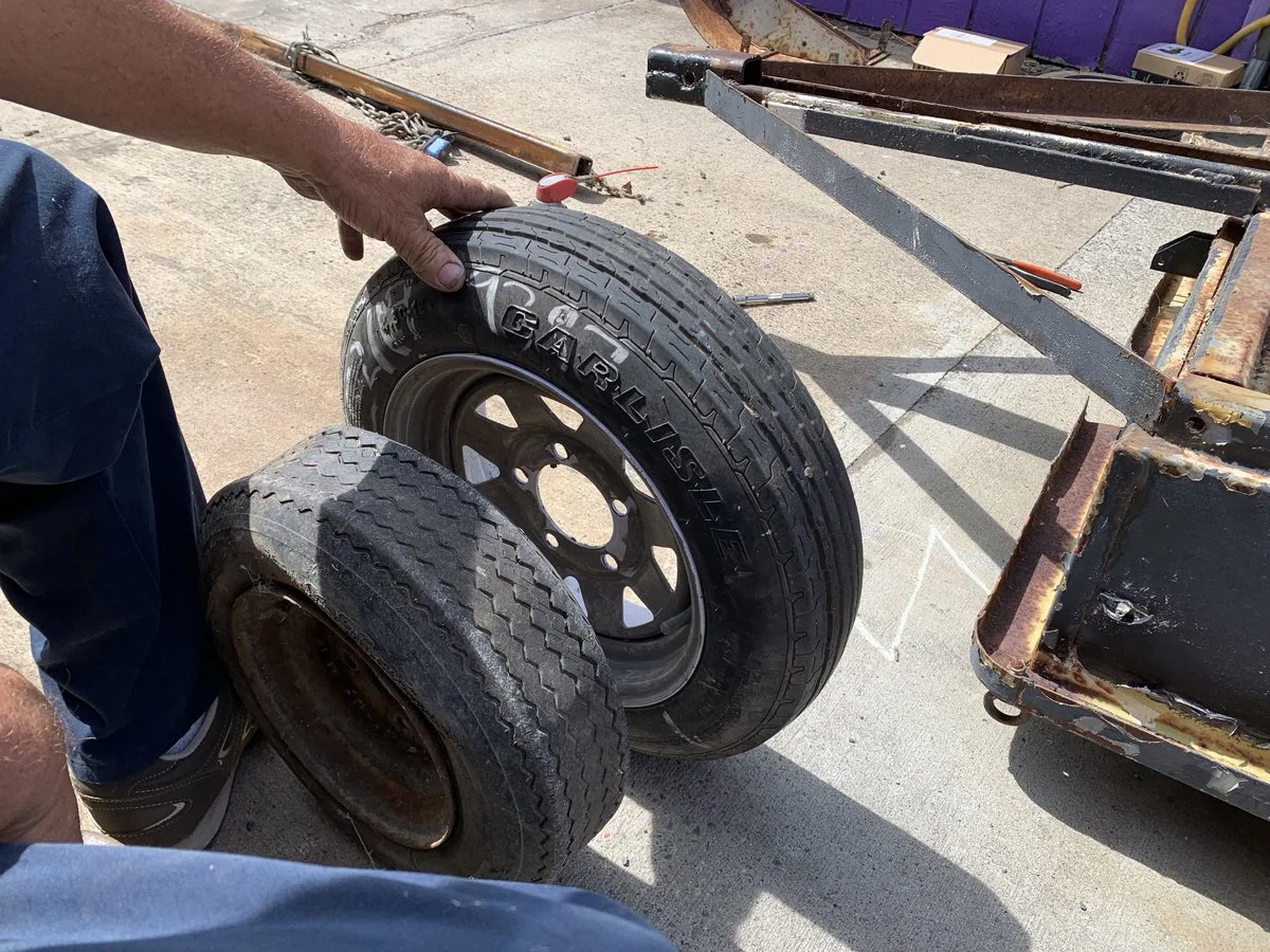

I was going to buy new tires but hubby said he had some. He did but not exactly what I was thinking. He says these will make it tow a lot better and won't have to go 200mph when being towed, like the smaller ones would. LOL I think it kind of loses the "cuteness" of it, but hey, can't really complain to much as he is at least helping me rebuild it. :D

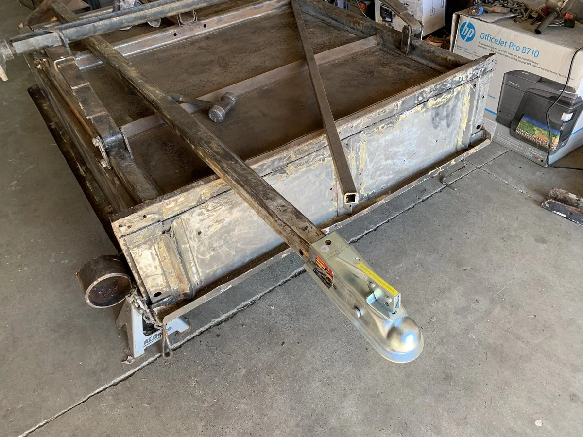

We also bought a new coupler for the tongue. I got the bar sanded down and just need to use some acetone on it to get the WD40 off that was sprayed on it trying to get it out of the trailer. I'm going to paint it with spray paint and before we put it back in, probably use a little grease of some sort to make it slide in a bit easier. Should be a little easier anyway because it doesn't have 3 layers of paint on it anymore.
Then hubby added a bar under the rear section that the tailgate is attached too. It was bent forward pretty bad, so this was his way to straighten it up a bit. Looks a lot better.

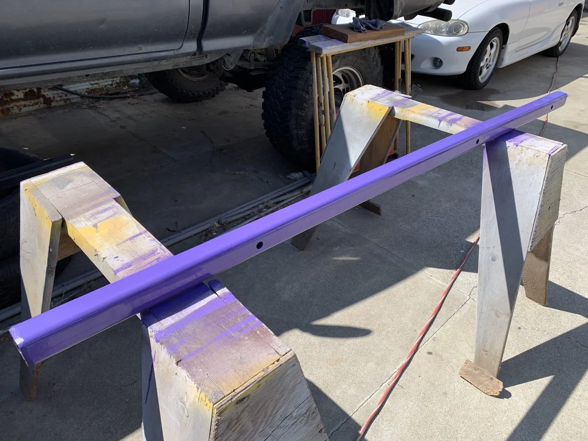

I did change my mind on the color of the tongue and frame. I won't say what color I went with, but here is a picture to kind of show it. LOL :D
That is about all I got done to it yesterday. I did fix the sandblaster cabinet and tried to clean some parts up but it wasn't taking much off and when I told hubby about wanting a different tip, he said that sometimes it gets plugged and to hold my finger of the the tip. So, today I will probably go give that a try, and see if I can clean the parts. :D

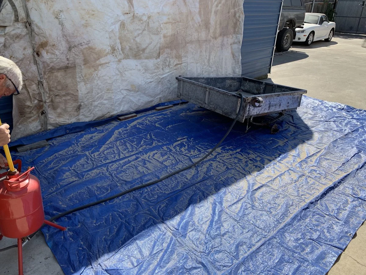

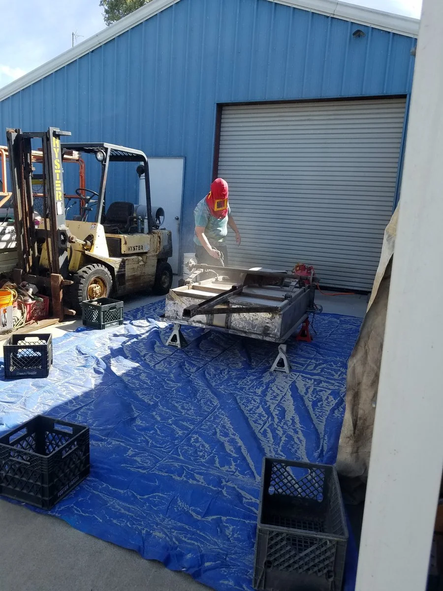

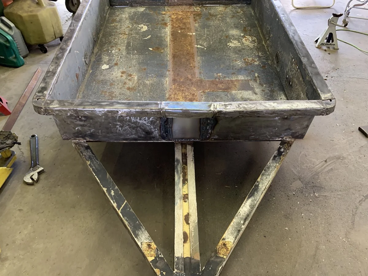

Hubby welded the patch piece in the front, then we set up a spot for me to sand blast some of the harder to get areas. We bought a pretty neat little helmet so I could see but not get sand all over me. It worked pretty good till we started having issues with the sand blaster and I was gettin hot. I took the helmet off to get some air and of course that is when the sand started coming out again. LOL So I went to the beach with out going to the ocean.
We ended up giving up on the sand blaster for now. We will get some new sand tomorrow. We were trying to sift the sand and reuse it and I finally got tired of it seeming to plug up every 6 inches of blasting. I think if we just use clean sand it will work a lot better. At least I hope it does. LOL When it did work, it seemed to take off the old stuff really fast.
Hubby was trying to figure out how much sand was down in there. LOL
If all goes well tomorrow morning, I'm hoping to be able to at least get the black paint on the bottom.
Sand blasting is done. Thank goodness. LOL We finally figured out the issue. We need to get a new 'dryer" for the air hose. We are getting to much water in and it is causing it to clog. The dryer we have just wasn't doing the trick anymore. I got it done enough so we can just finish the inside with a air disc grinder.
Hubby got this pic of me blasting. LOL No, I'm not the skinny sexy blonde. I'm the chunky one. LOL Wish he would have told me he was taking a pic, I would have sucked it in. :D
Here is a close up of the helmet. Pretty neat but fogs up when you get hot and breath at the same time. LOL

Here it is ready for the black paint. My little helper is in the pic too. Lucy Lu! :D Just noticed my other helper is in it too. The brown dog to the left is Buddy. :D

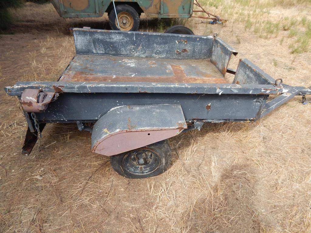

Never heard of a Sears trailer so I looked it up. Interesting.
Yah, I have actually seen them with the clam shell, but mine didn't have it. We did look around the farm that we got it from but no luck. I would love to have the top one day and I will keep an eye out for one, but hubby is just going to make some wood side for it. Kind of like a picket fence thing. Then I will probably either get a piece of canvas and try my luck at make it fit over sides or have one made. LOL

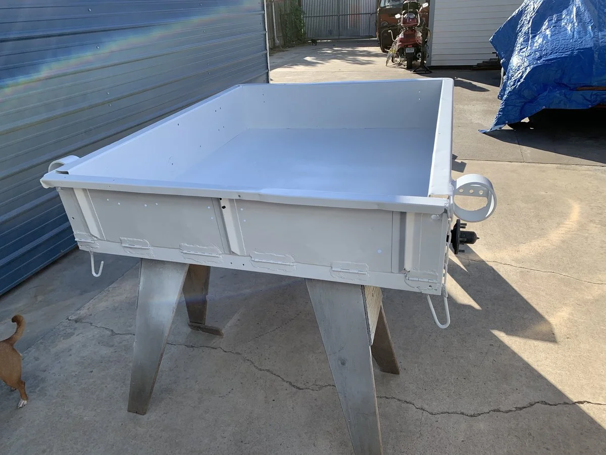

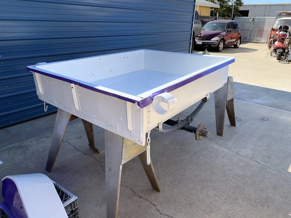

I think hubby got tired of working on the trailer. LOL He decided to primer and paint it today. LOL Didn't even give me a chance to do my purple stripe. Oh don't worry, it will still get purple on it, just not like I had originally planned. :D
I will have to go back through and touch up the black on the springs and all. That won't be that hard since it is just brushed on. Don't have to worry about overspray. :D

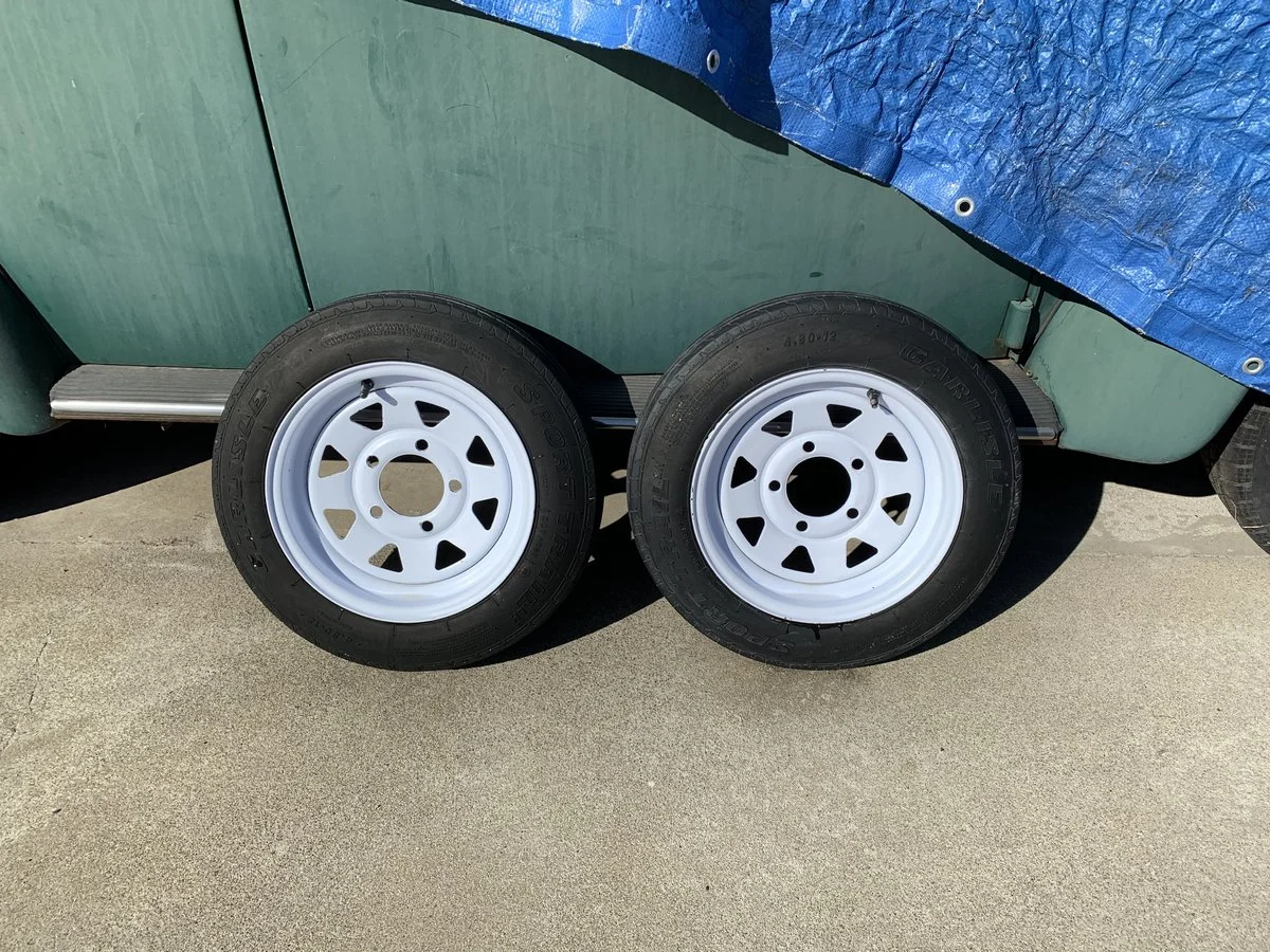

I still need to go get some oven cleaner so I can try to take the ugly paint off of the wheels. Then we will need to run wires and put in the lights.
Almost done. Well with the main part. Will still need to paint the spare tire holder and find a spare for it. All I need to do now is go to the hardware store and buy some new bolts to mount the fenders. :D
I cleaned up the wheels. Amazing what EasyOff oven cleaner can do!! I didn't have a good before pic but you can see the tire way in the back ground against the fence.
This image you can somewhat see it, its the taller one.
After cleaning them with the oven cleaner,

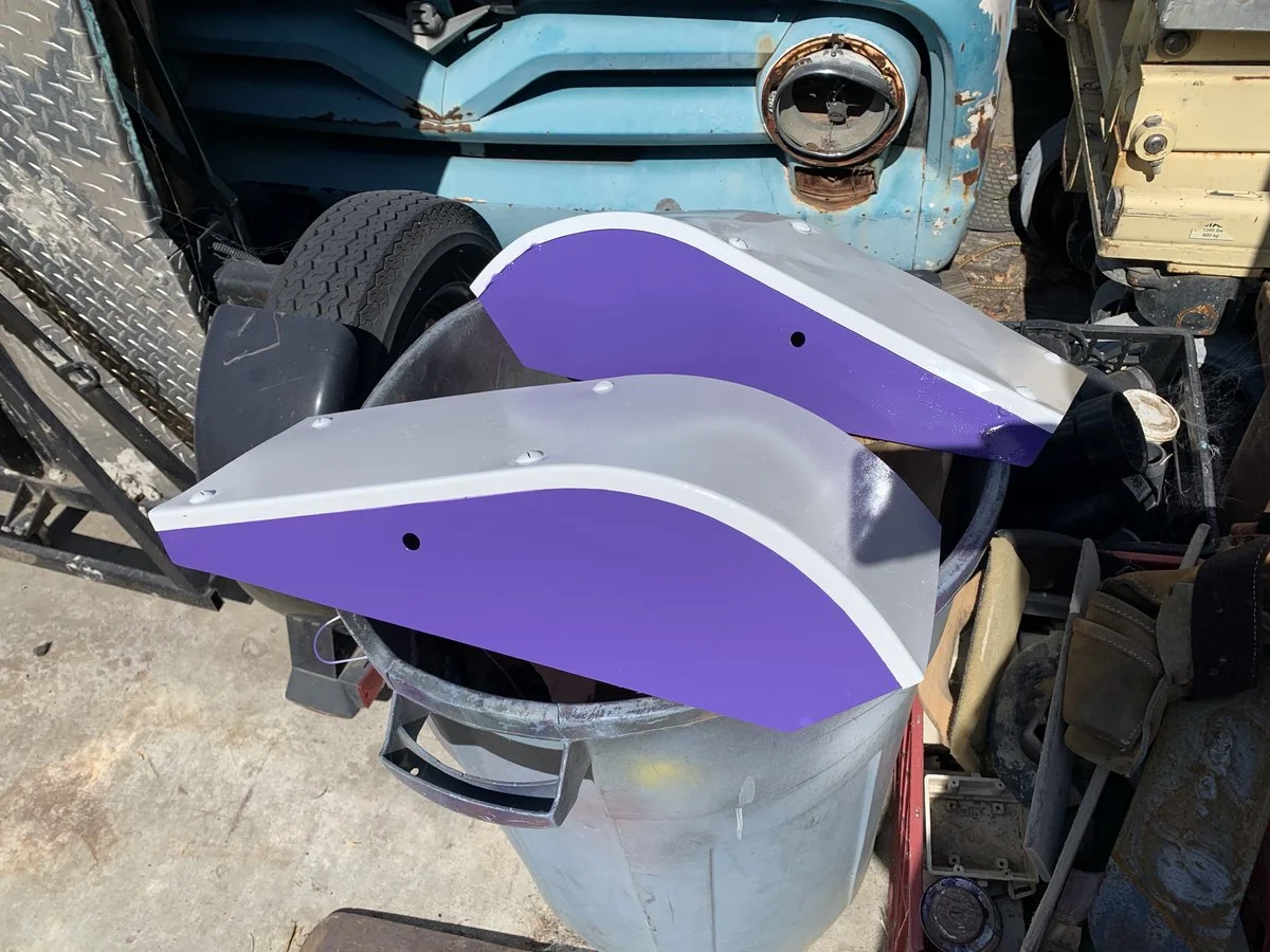

Here is a sneak peak of the trailer and fenders. Can't wait to get it put together and take a pic. :D
Next pics will be of it put together, all except the spare tire.
