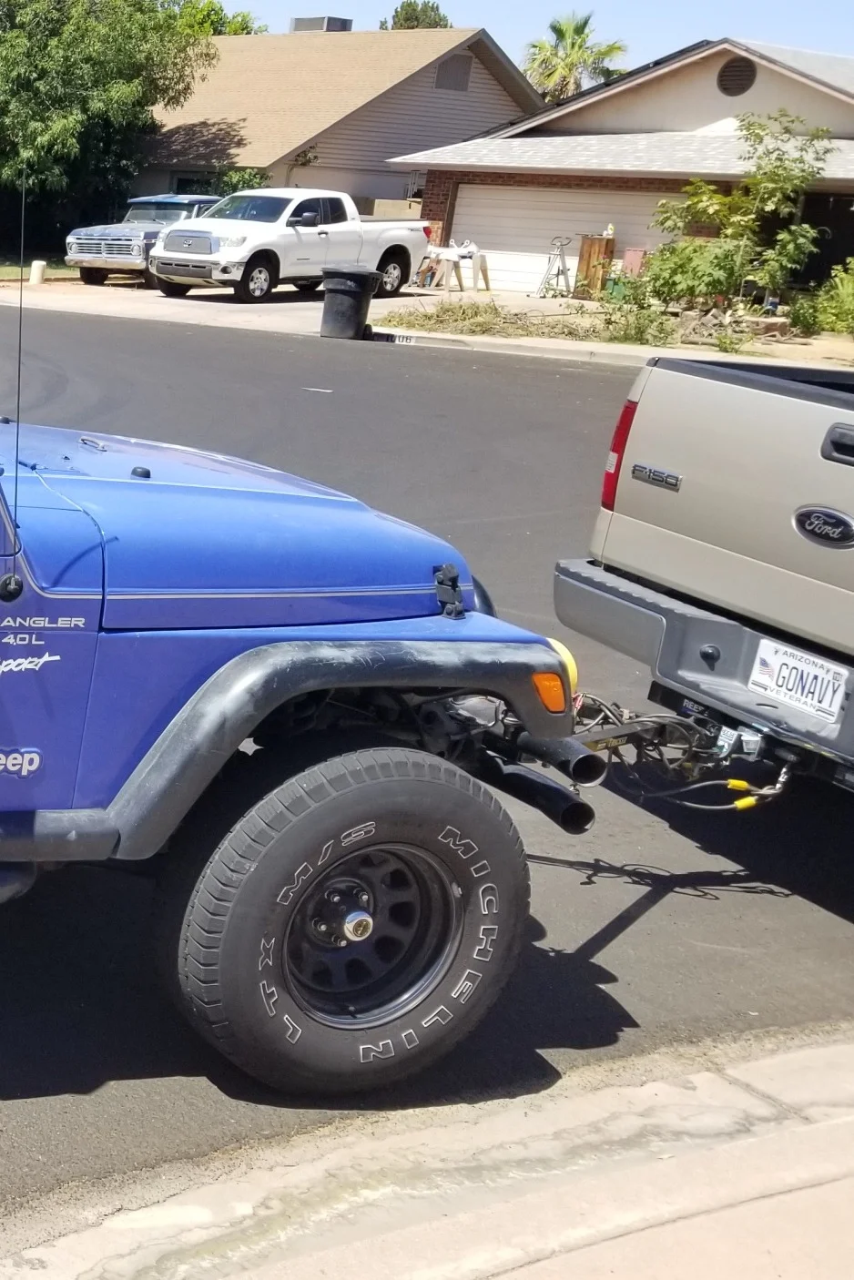

Im up way to late..... i just thought about it. You can always add a towbar attachment to the front of the jeep and pull it.
My truck is a 1/2 ton and pulled the jeep no problem. Its an option. But the trailer would be less ware and tare on the jeep. And god forbid you break it in moab it will be a pain to get home.

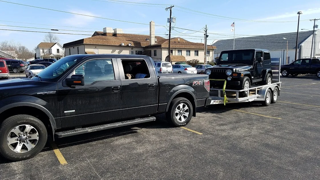

I don't think you'l have any problems @ac_ I had an 02 Avalanche that I used to tow with...EVERYTHING. The majority of my towing was my boat, which goes across the scales at 5750 on the trailer, full of gasoline and "supplies" for the day. While I didn't do any mountains (we only have big hills in Michigan) it was NEVER a problem. The only thing I ever wanted to change is to put airbags in it. Newer trucks are designed to ride well, so they softened the springs...they don't take the tongue weight like they used to...but then again, you don't lose your dental fillings either!
I've also hauled a 30 horse John Deere Compact tractor with a bucket with that truck. I wouldn't recommend THAT going over mountains...I'm pretty sure I was overloaded then!
When that truck started to rust out...I picked up a NEW (yeah, I know) F150 FX4 with an Ecoboost. What a towing machine! It pulls the jeep without ANY drama whatsoever.
This is a 18 foot Aluminum Trailer my dad bought. Its SUPER handy to have around. If I were you, and you're already considering a new truck...I'd add a brake controller to my current truck and spend the 2800 or so on a trailer like this. Electric brakes are SO much better than surge. The boat trailer has surge brakes and they work, but they are a compromise, at best. They are not very progressive...They work by virtue of a sliding hitch. When you come to a stop, the hitch is stationary on the ball, but the trailer chassis is free to move forward. That movement is resisted by a damper and the master cylinder. So, the harder you stop, the harder the load pushes on the MC and in turn you get a greater application of brakes. At least, that is the theory. On my boat trailer, which I keep in good nick, you won't feel the brakes and then you do! When you take off, the hitch slides back out with a clunk. Its not a smooth operation...So they DO work, but Electric is so much better.
Thanks for the pic. That does make me feel a little better for sure. It doesn't really even look like your truck sags at all.
Reactions: Mike_H
You control tongue weight (sag) by vehicle placement on trailer. Move it forward increase tongue weight, move it back decrease.
