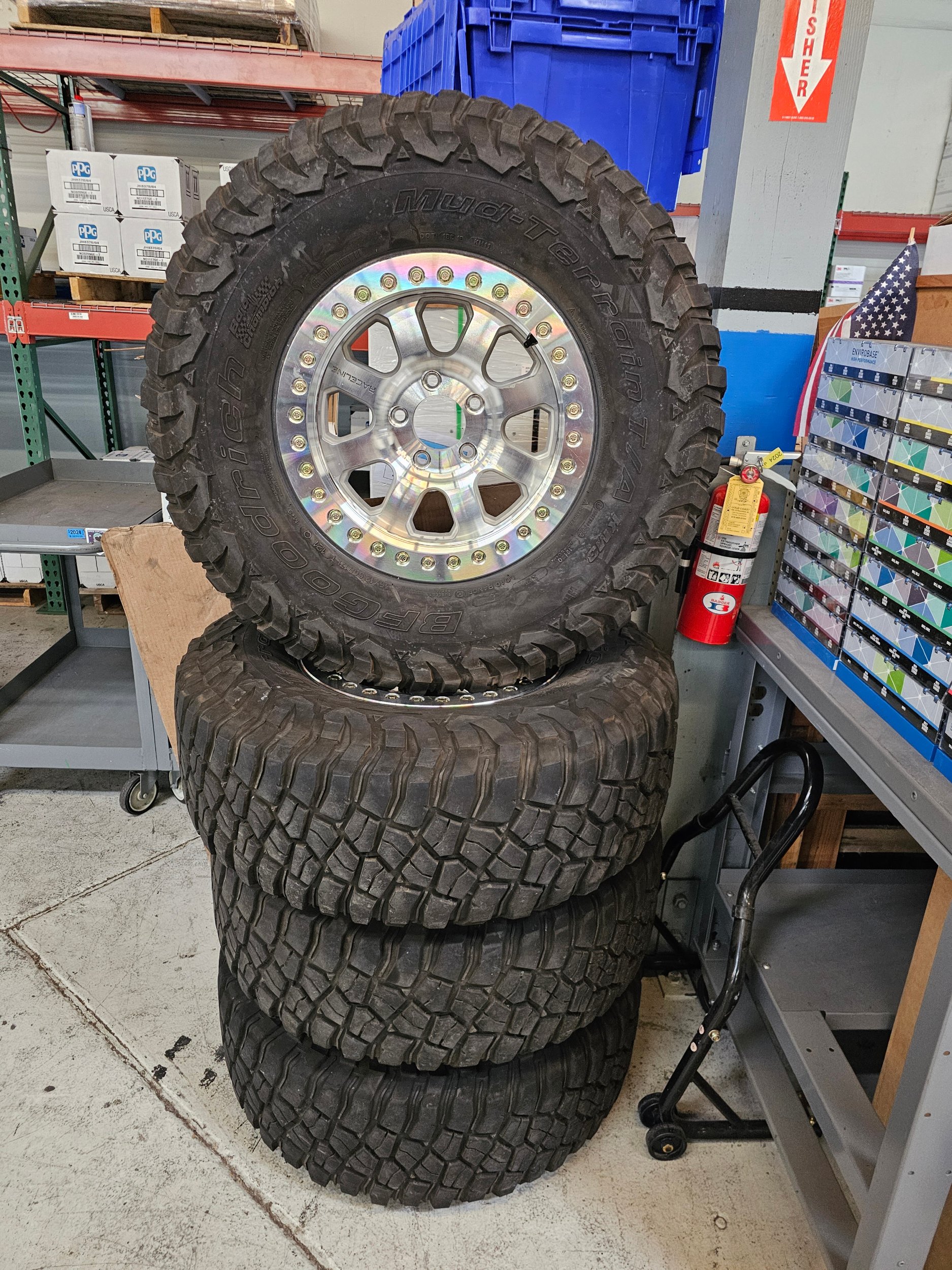

Did you mount the tires on the beadlocks? They look awesome. Can't wait to see them on your Jeep.
Yes I mounted them to the beadlocks and it wasnt too bad, just alot of bolts to tighten.

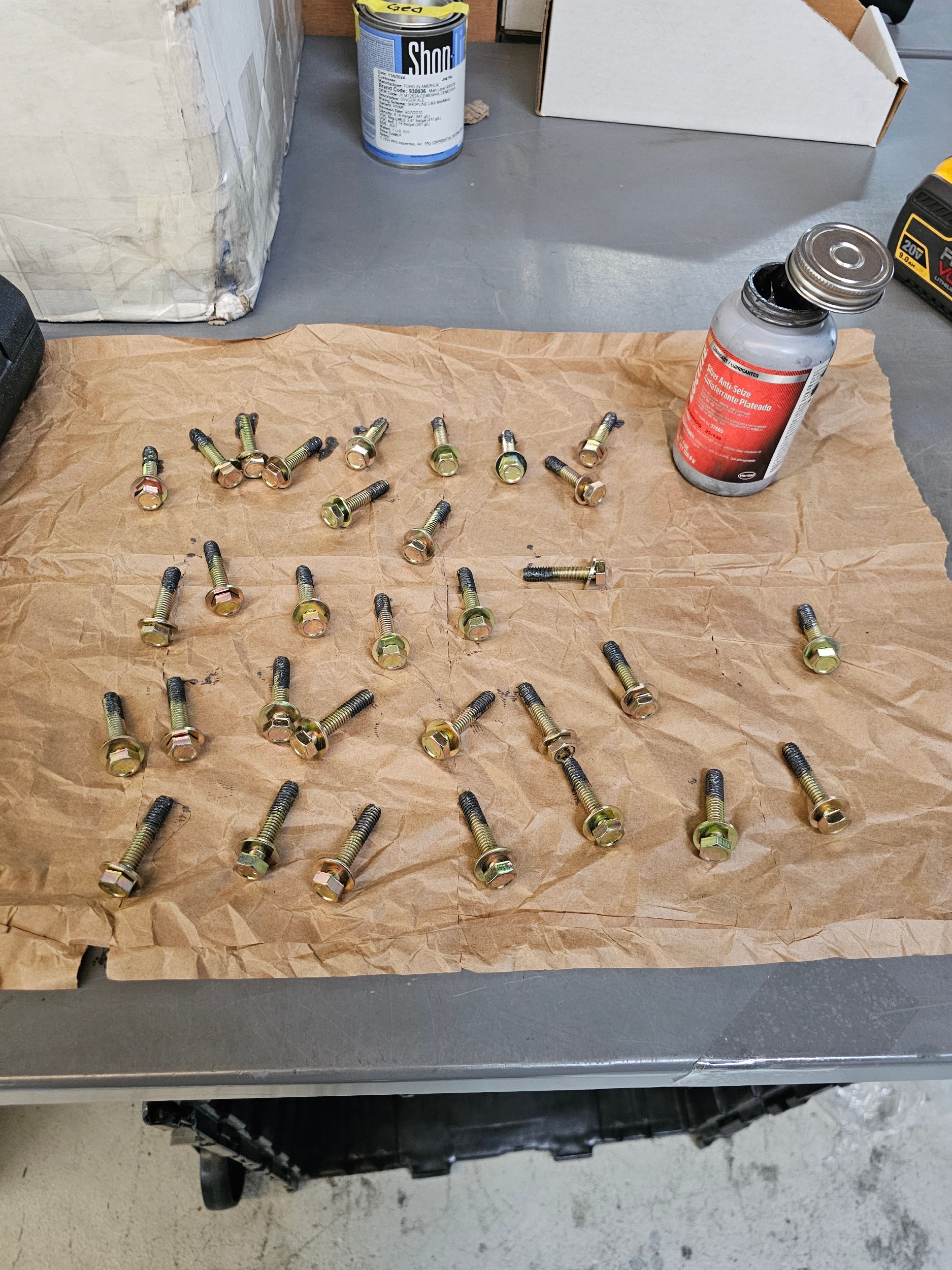

Step 9 says to tighten to 192-216 in-lbs.Mine did not have to be tightened that much I believe raceline has a different torque number. I did don't slow to get it right and when I finally g$et them on I will check it more often especially before a trail run.
So I checked my notes I have and I tightened them to 18ft lbs
I finally got tires on the wheels and now I just have to put them on the jeep! also trying out balance beads
Are you running an wheel adapter on these? I didn't think they sold those in a 5x4.5. What backspacing are they?
4” BS, Got them from Wheels ASAP
No not you, the Raceline beadlocks.
My Raceline Beadlocks Monster 232 came in 5x4.5 with 3.75" BS. They are the same design, but have some black accents. Otherwise they look the same.
