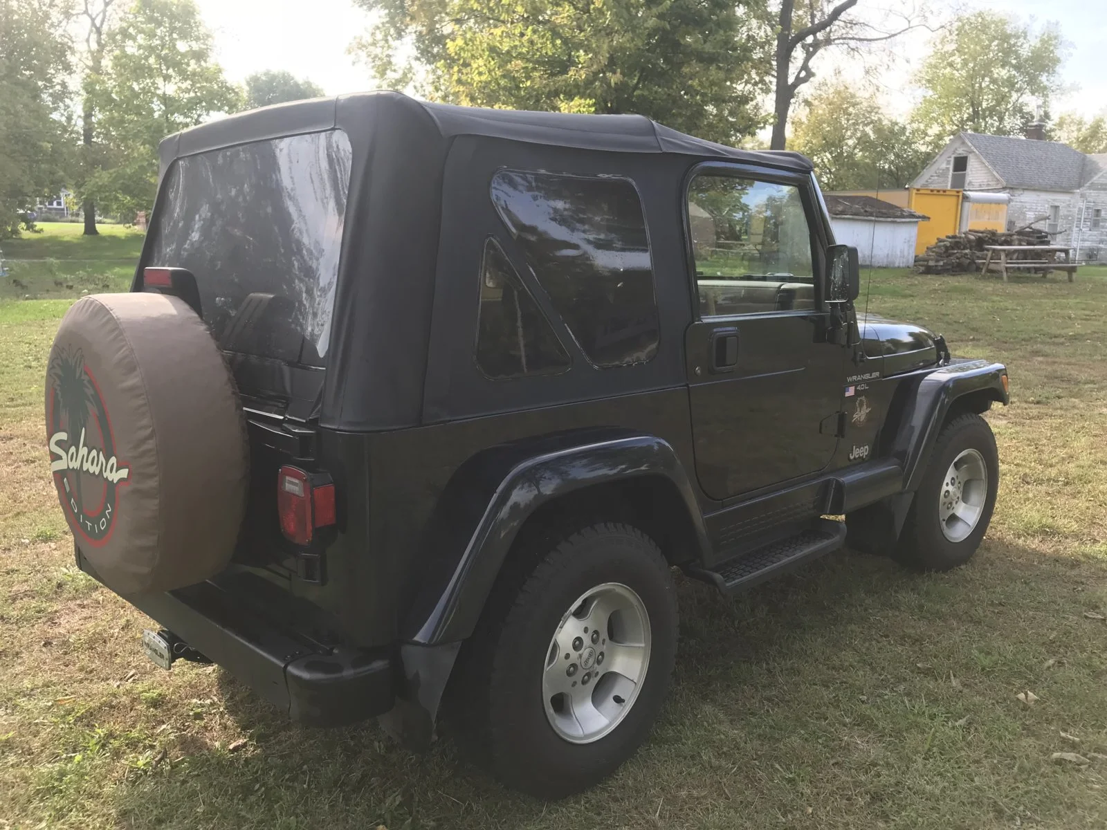

Hello to fellow TJ owners. I’m new to owning any Jeep. Bought my first one roughly 3 weeks ago. Have not had a chance to go off-road, as of yet.
From what I have read and seen when I was looking, I got lucky as this one has a little surface rust.
A little about me, I’m 46, getting started with a Jeep a little later than most. I have some mechanical ability but haven’t done much lately because I do not have a garage (yet). I have already read some great advice on here from members and looking forward to more. Also I am new to forums, so if I make mistakes let me know what they are so I can improve.
Now to what most on here want to hear about, the Jeep. It is a 2000 Jeep Wrangler TJ Sahara edition with the 4.0 I6 automatic. From the build sheet it came with Dana 30 front and Dana 35 rear axles with 3.07 ratio. The frame is solid. It was stock when I got it, have added a new front bumper from EAG with 3X3 led fog lights and a grill cover. Looking forward to all the mods that can be done to it.
Thanks for all the advice in advance,
Daryl

Looks like a pretty clean and rust free TJ, that's the important thing.
Minus that grill, I like it! With a lift and some bigger tires, it should look great! I definitely agree with what @Alex01 said. I'd put new gearing in it well before bigger tires. 3.07 gears is the worst combo you can get with larger tires!
