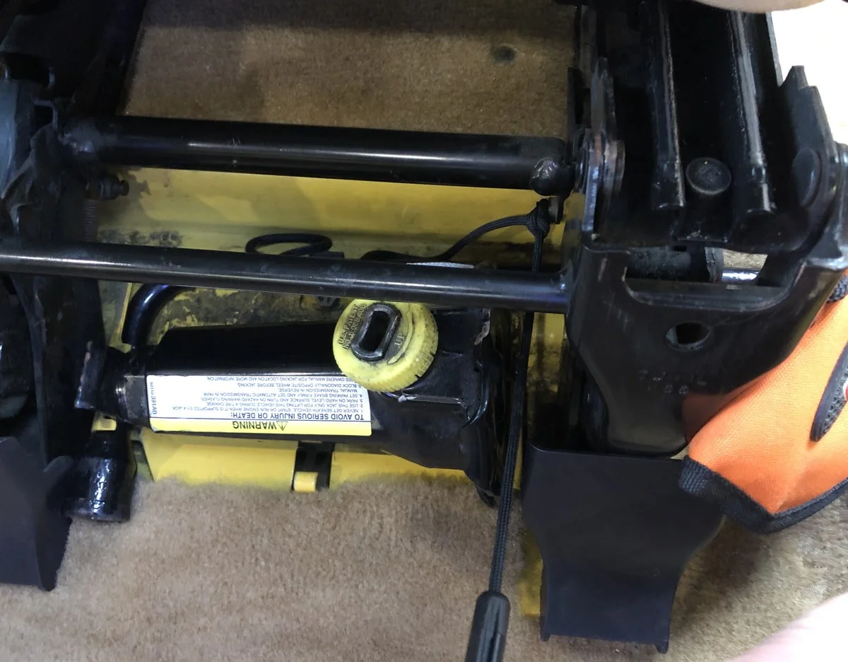

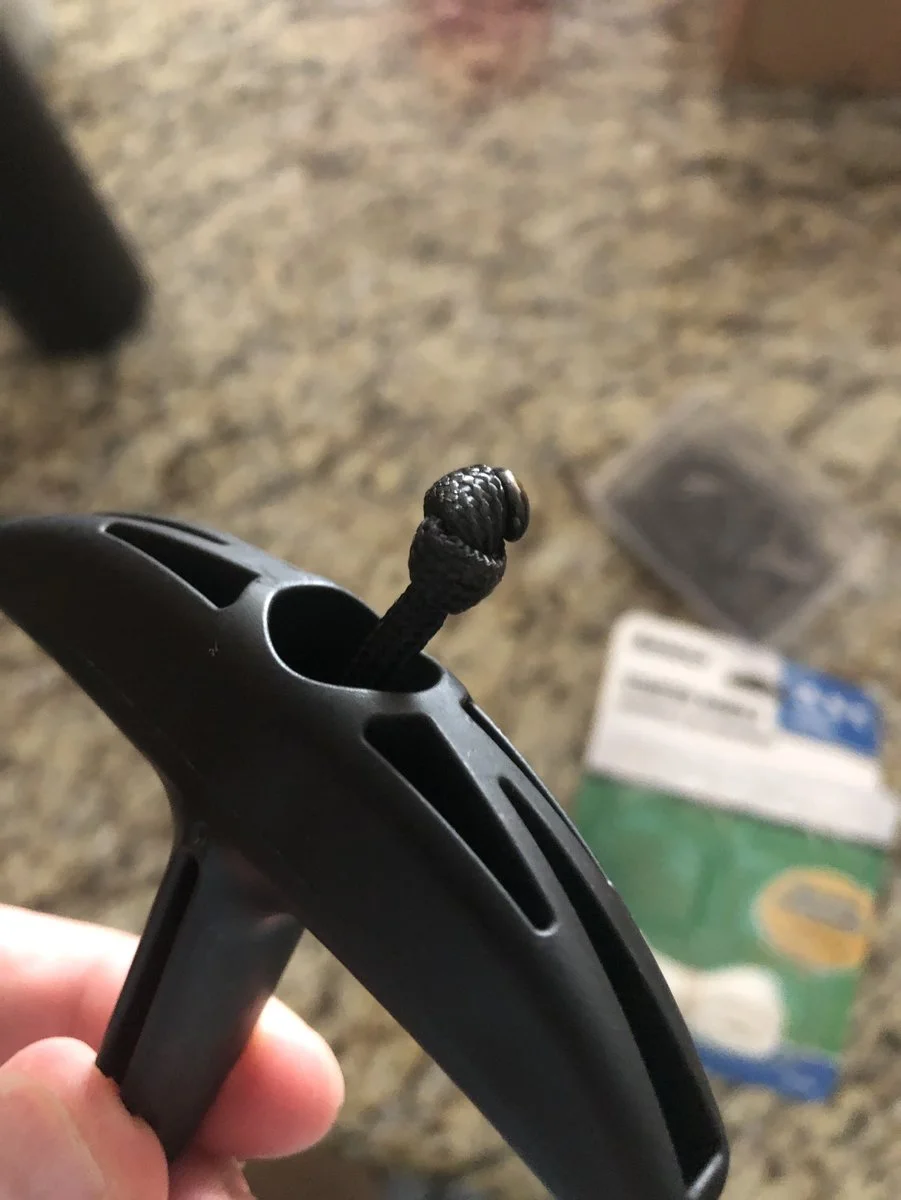

Ever since adding aftermarket seats I effectively eliminated the fold and tumble feature of the front seats by any normal means. Now that I’m putting the kiddo in and out on a more regular basis I needed this feature so I rigged up a little pull lever today
I picked up a general purpose pull starter from the hardware store for a couple bucks and used 550 cord.
under the seat I found the cross bar with the actuating lever that activates the fold and tumble and tied the other end of the 550 cord to it. Now my fold and tumble works by just a small pull on the starter handle instead of having to reach under the seat to turn the bar by hand.
