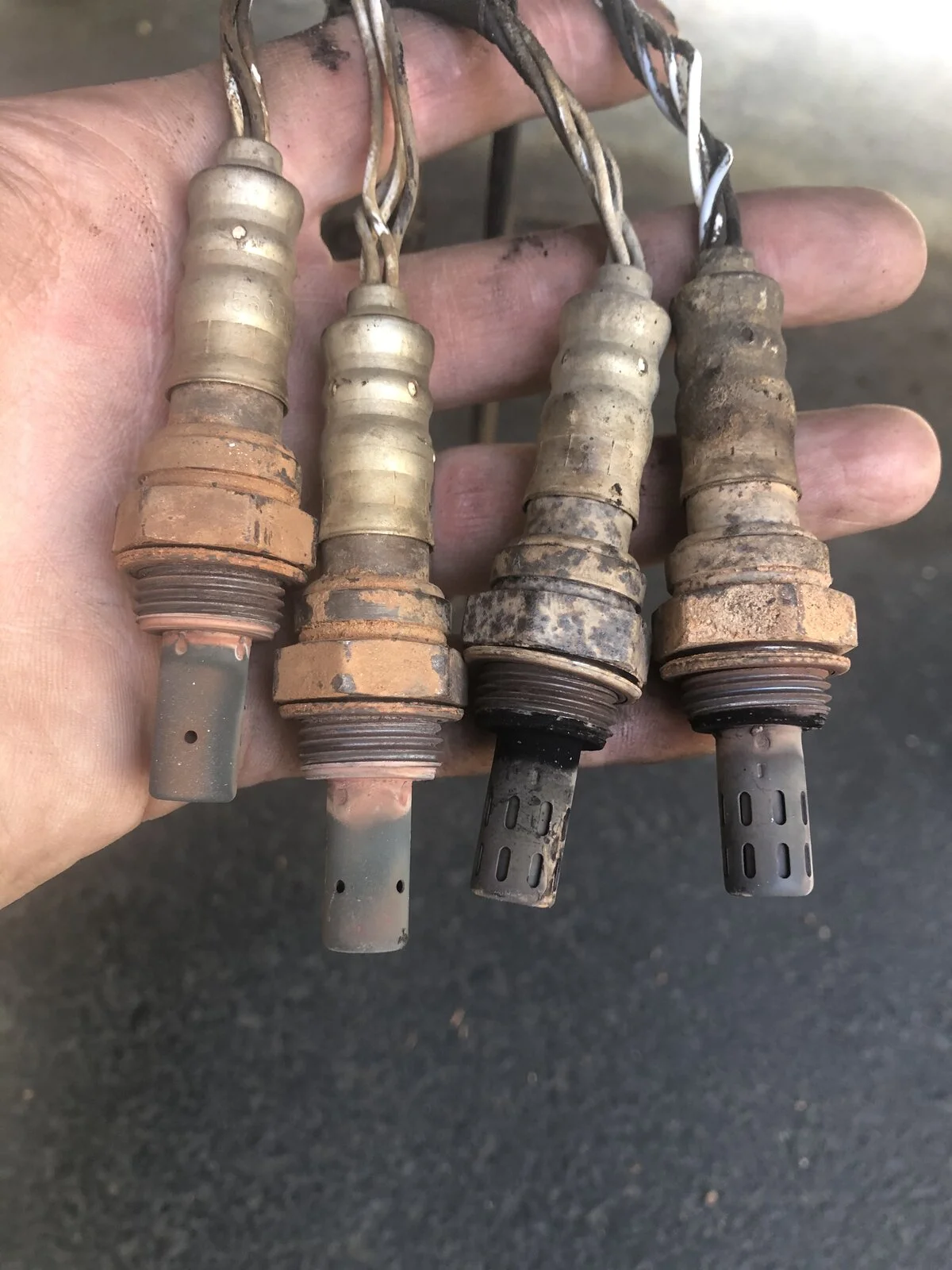

Well that sucked more than a little. I was fully prepared to pull the valve cover but man I did not want to. Luckily there was barely enough give in the grommet for me to get it out... eventually. The rear came out with very little struggle. Replaced the hoses as well.
