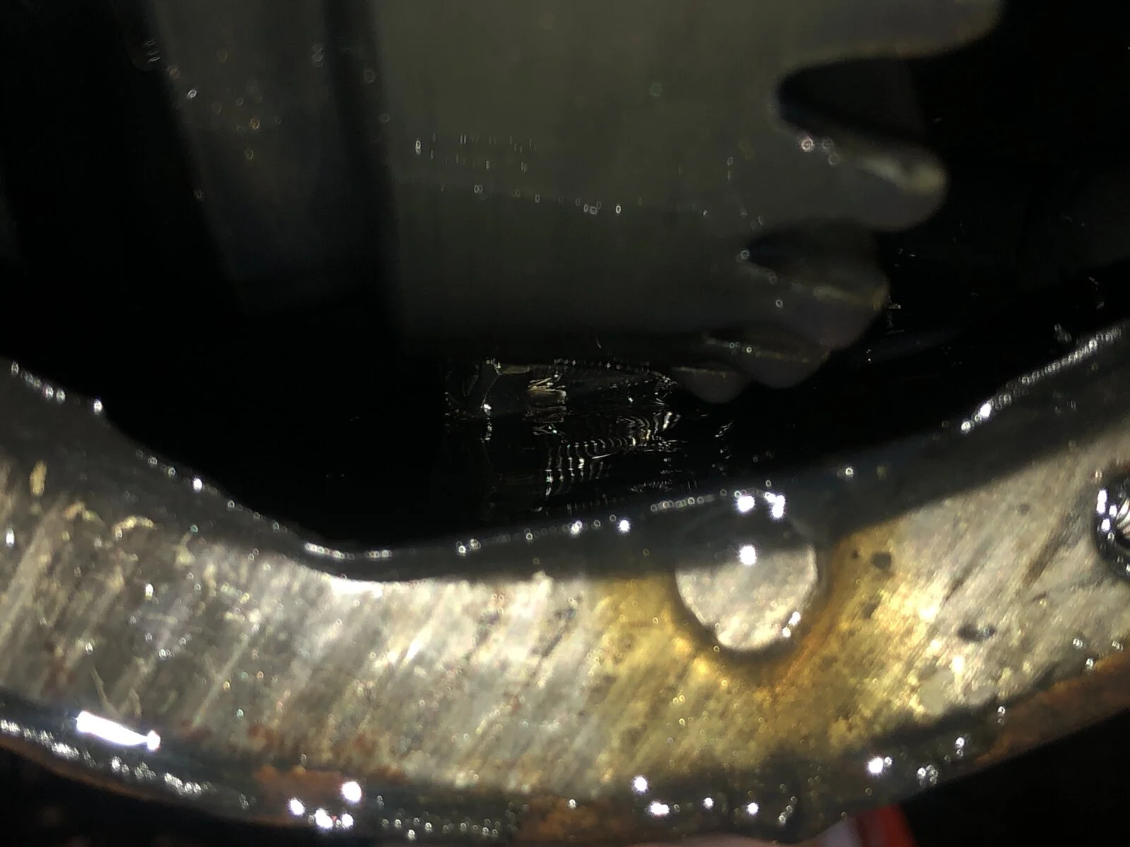

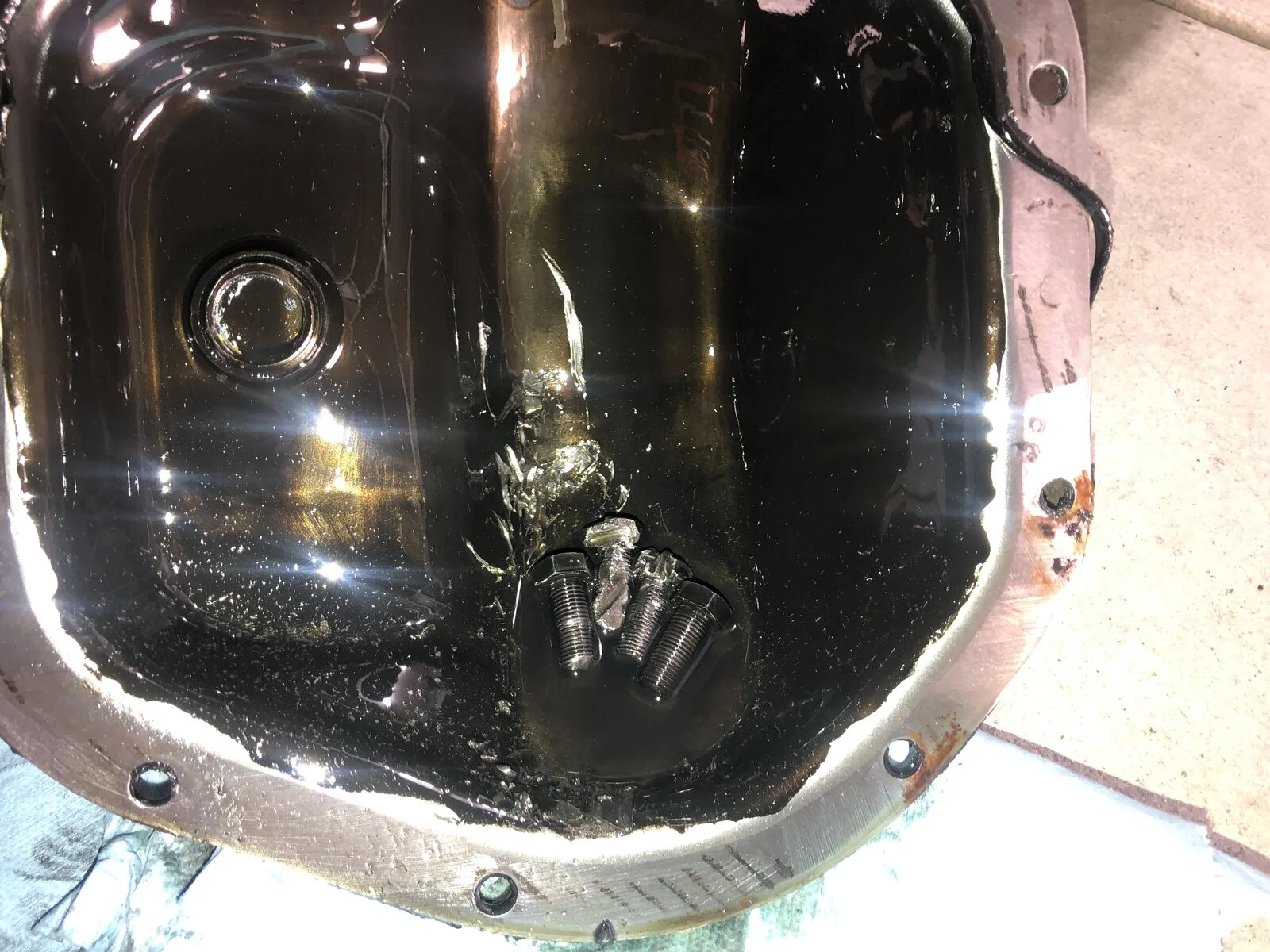

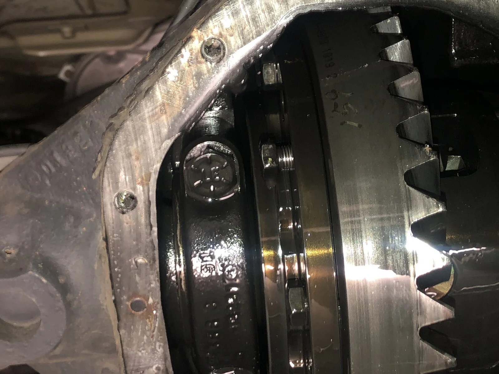

That happened to me recently - about 10 years after I changed my gears. Best I can figure the original loctite just degraded and checking the ring gear bolts should be a maintenance item during diff fluid changes. I cleaned out the ring gear thread holes with some compressed air, ran a thread restore in each ring gear thread, and installed a new set of ring gear bolts with some hi temp red loctite (different than the normal red loctite) and it's been fine since.
