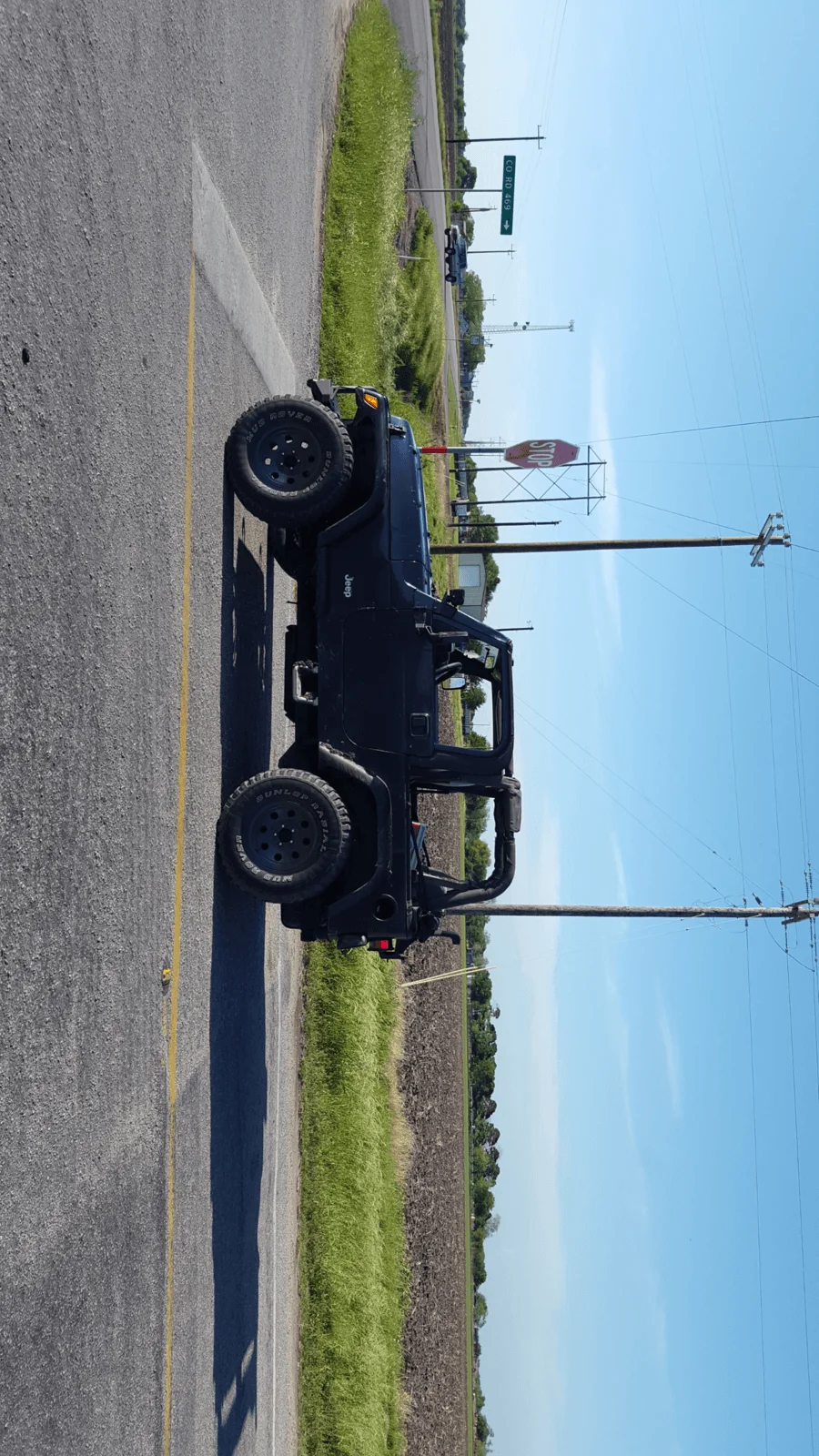

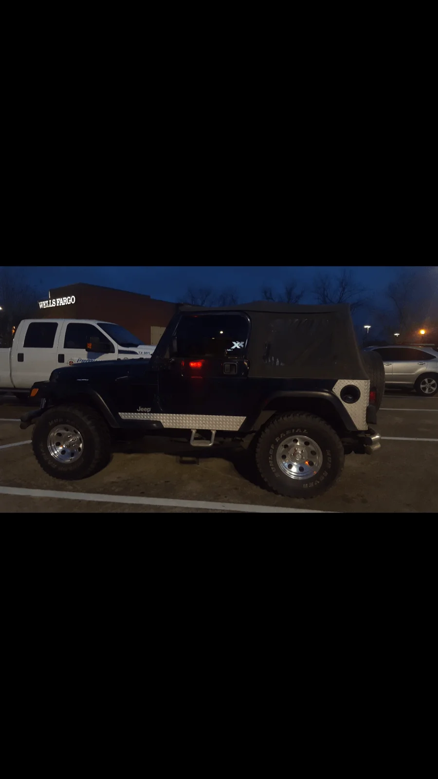

First, this is my first vehicle and ironically up until about 5 months ago I thought jeeps were way overrated. But as I was browsing for a vehicle, my cousin bought a red YJ. He bought it from a older gentleman that he was working for, at a price to good to pass. I went with him to pick it up and rode back with him, I was changed and began looking for a TJ and also spent many hours reading on this forum for which I am so grateful. So Febuary 5, went to north Houston with my Dad and purchased my treasure.
This is the evening I bought it...

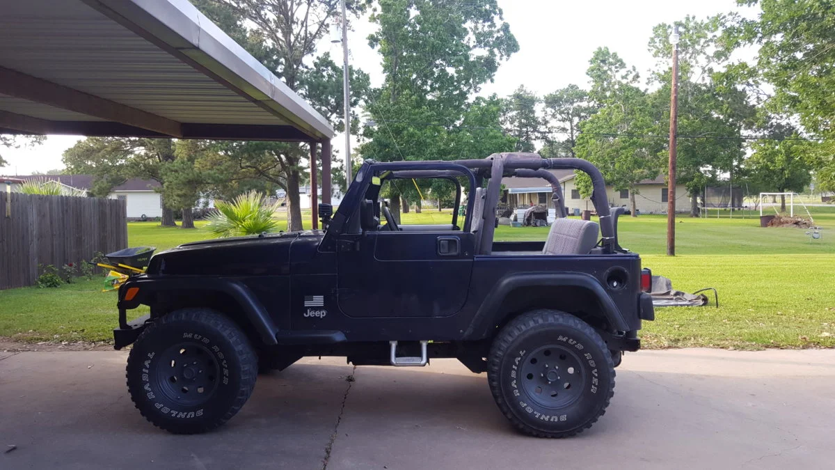

So far I have replaced the front bumper with one from EAG and removed the rear. I am in the process of building my own rear bumper, and just got in (hopefully) all the parts I need to install the a.c. system. So that comes first. Also removed all the aluminium armor and have done some work on the interior.

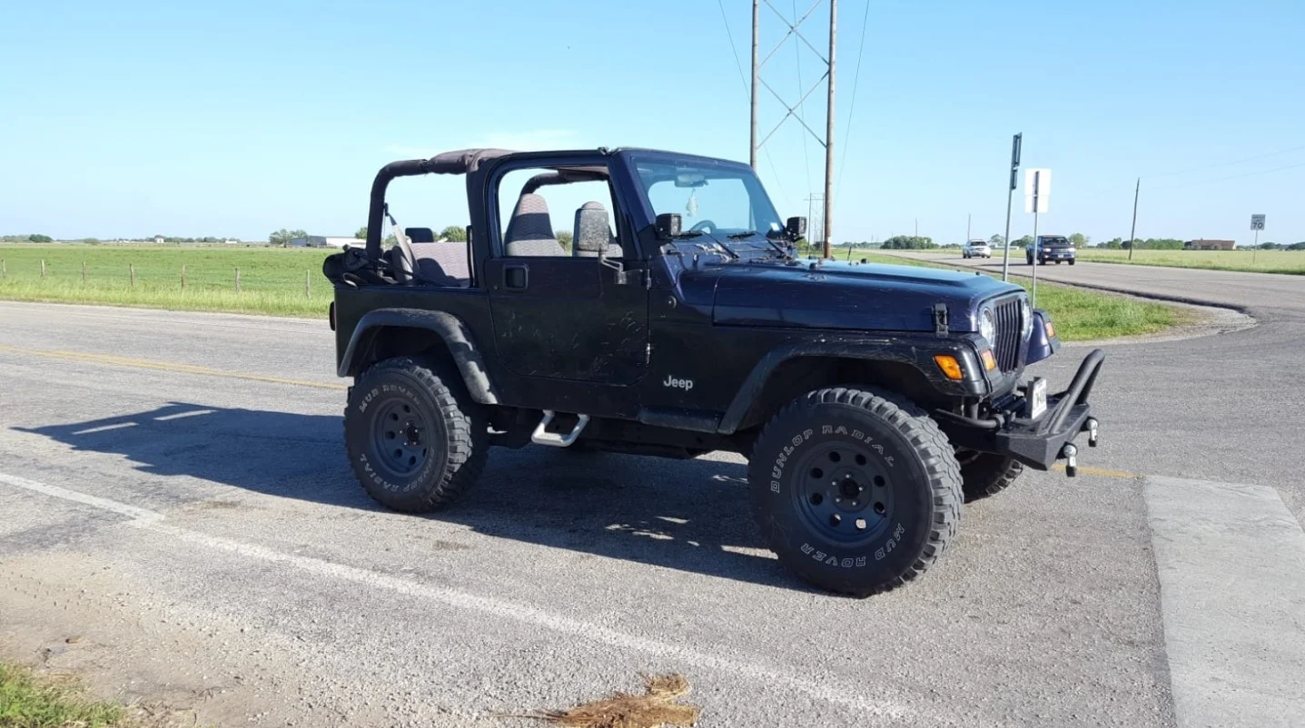

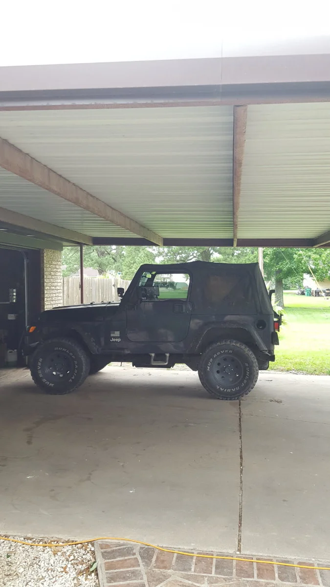

As it sits right now...
94086
94090
O, I did also pasti-dip the wheels. I did it just to see how it would look, and I didn't like it as much as I thought I would but it has kind of grew on me. I am debating buying new wheels also when I buy new tires and then also getting a matching spare. As I don't have one right now.

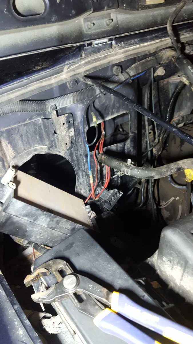

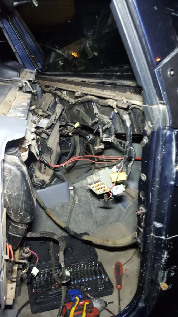

So last night I started getting serious with the a.c. install. I had previously bolted the compressor in temporarily.
96861

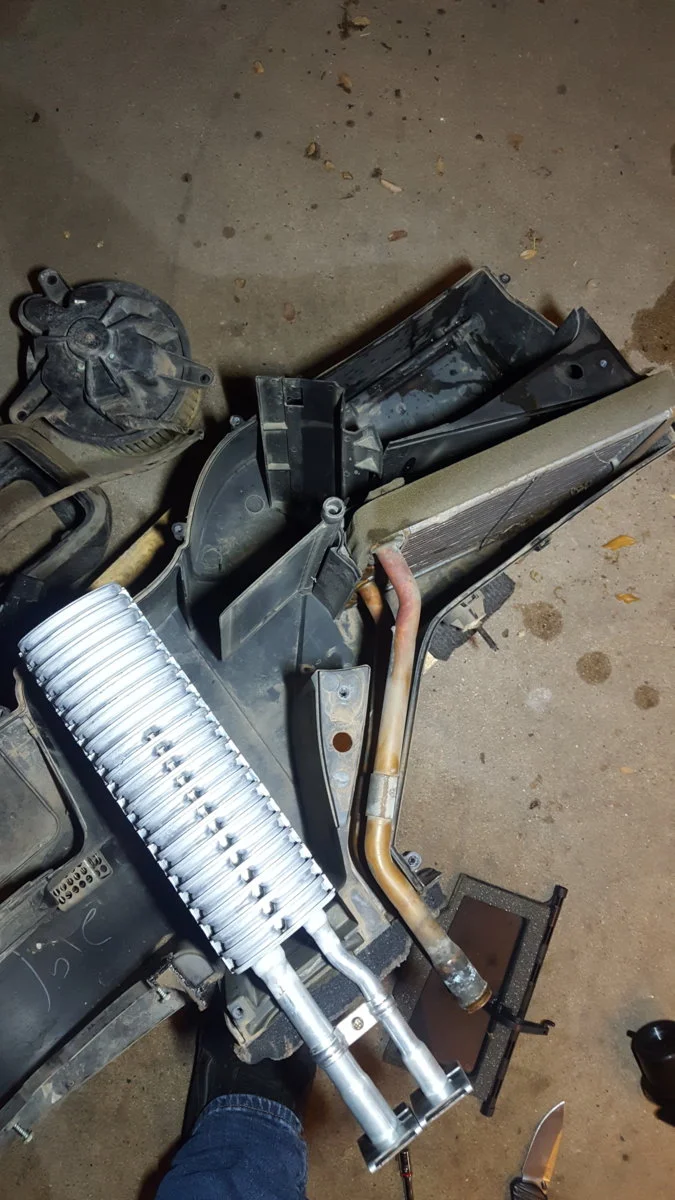

I ordered all the (coming to the part were I didn't order all the parts) parts from rockauto. These are from last night.
96862
96863
96864
96865

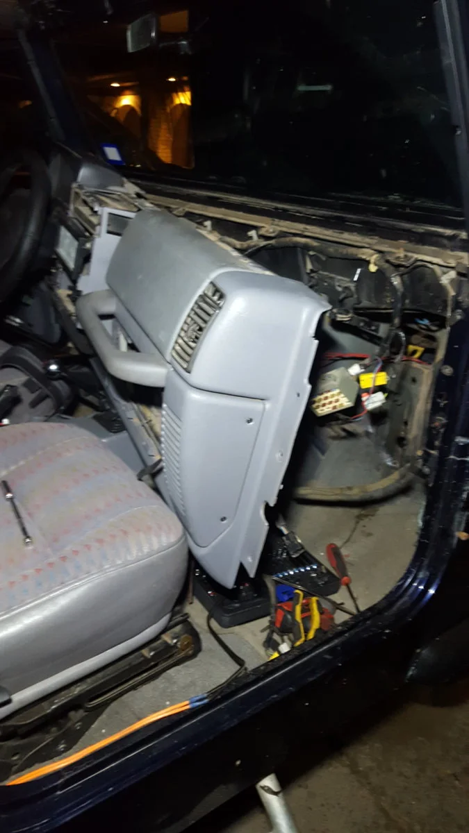

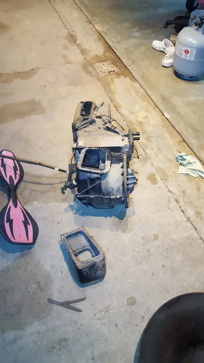

Getting the heater box out turned out to be quite a bigger job them I had anticipated, but got it out. 😥
So it looks like I'm missing the control panel for a.c. (the thing with the knobs lol), the vacuum actuator for the fresh air door, the vacuum lines for that actuator and whatever else that entails, and the fresh air door itself. And now I am lost. Not sure where to start looking for these^^ parts. Not sure what I'm gonna need to finish the vacuum actuator part of that. I have been searching YouTube with very little success. I know the instruction are on jeep air but some of that is still a little unclear for me

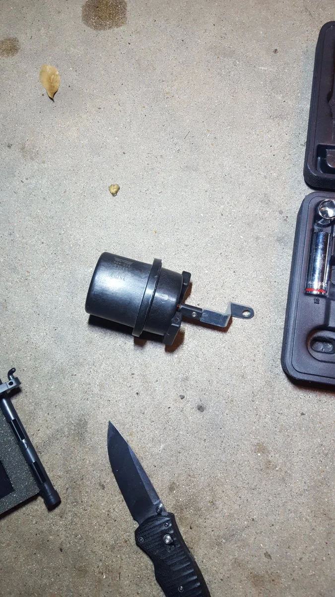

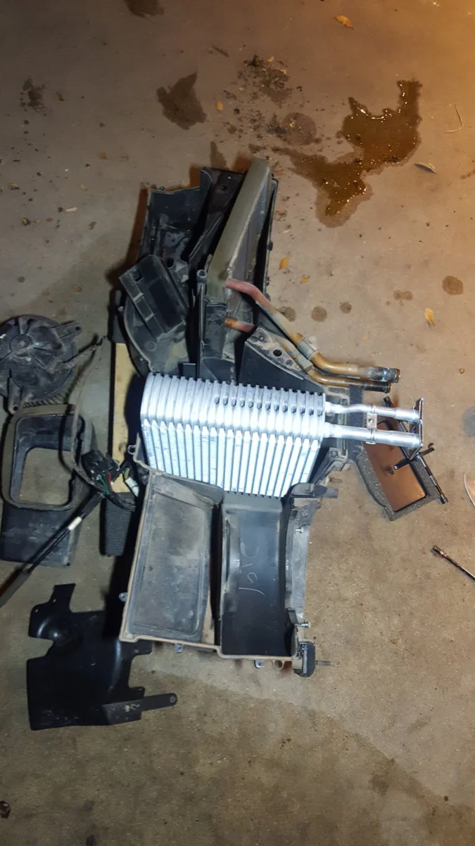

So the rest of my order got dropped today. As in the parts for the a.c. Of course inevitably I messed up trying to follow part numbers and managed to get the wrong vacuum actuator.:mad: But I got the box opened up. I need to grab some replacement foam to. So back to eBay it is. I'm not sure if its worth trying resale or return the $24 Dorman actuator.:cautious:

I'm learning something new here. I've never ventured behind the dash really, so all these parts are foreign to me.

I had to laugh when I noticed that your very first picture had a Wells Fargo bank in the background. Yeah, because you'll be getting very familiar with withdrawing money from some form of baking institution, now that you own one of these! Also, your second picture has a "TJ Maxx" sign in the background. Gonna name your little rig "Maxx"? Somehow seems appropriate, given the picture. ;)
