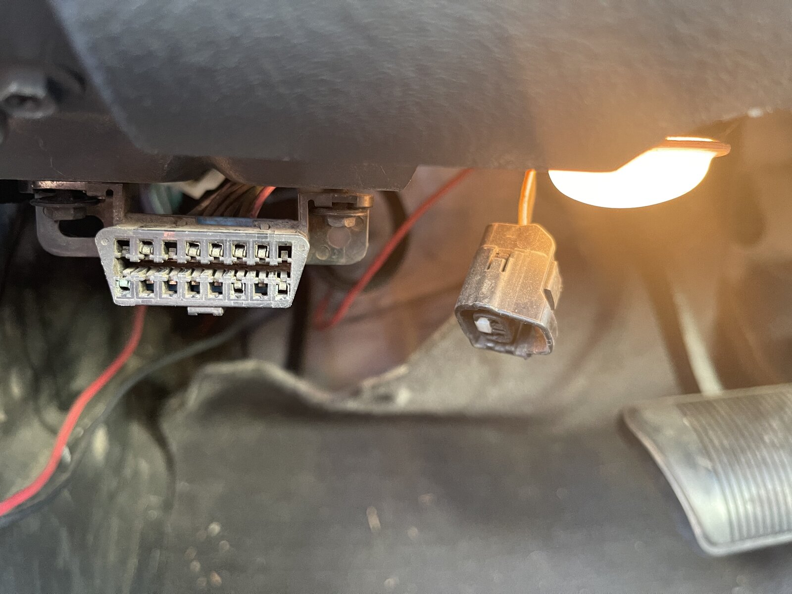

@Wranglerfix I was finally able to test some wiring this weekend. This jeep is a weird one. I found no breaks in the five wires that run from the OBD2 port and the PCM. I did find two wires in different pin locations on the OBD2 port. I’m not sure what to make of this? I guess I should try and confirm my port is PIN out different than others? I used the factory service manual as a guide. Below are the PIN diagrams and a picture of my port. Best case I relocate pins to correct location and have someone hook scanner up to the Jeep.
OBD2 Port
Actual Location ——- Circuit Function —— Service Manual Listed Location
#6 ————- ——- SCI Receive (PCM) ——————- #12
#14 ——————- SCI Receive (TCM) ——————— #15

Thank you guys for the info. I understand the the circuit can be tested better. This still doesn’t address the pin locations on my OBD2 port. If the pins are not in the correct location it would make sense why the scan tool can not fully communicate with the PCM. I agree damaged wiring can also cause this. I will look into testing the wires with some voltage behind them. I’m trying to get this thing running and then I’ll look at finding a new harness once I have a better garage setup. The dash harness definitely needs to be replaced as it was repaired.
Reactions: Wranglerfix
(Attached a simplified wire diagram from Mitchell 1) You've definitely got something fruity with your OBD2 Port. Someone's done something weird. Pay attention to wire color, de-pin and re-pin the connector and try again.
SCI/PCI = Pins (2,7,9,12,15)

Real quick, yours is a 2006 4.0L A/T?
Yes. Originally it was a M/T. Previous owner swapped in the A/T. All original factory parts.
The wire repairs are behind the radio. Fire was in the center of dash. I will get some better pictures of the wiring repairs today.
