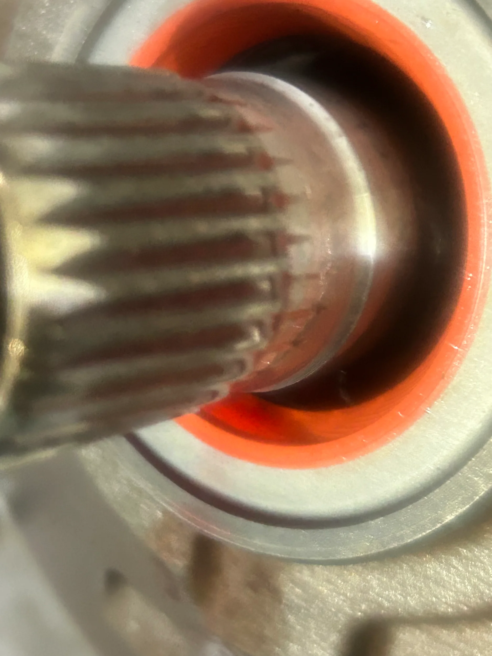

Trans dropped, there is a trail of tears from the bottom of the seal, so I'm confident we found at least one problem.

Since we all love pics. That’s more hemorrhaging than he ever seen from a pump seal but it’s pretty obvious the cause of *this* problem.
What I don’t know is the root cause.
The square looking pin on the lower left is the kickdown band apply lever pivot. It's one of those things that could easily be the source of a leak but never is. It's not held in by anything other than 2 little o-rings that hold it in snug. The next time I see fluid weeping from there will the the first time. I guess because they're lubed up on the way in and never actually move once in place and not exposed to hot fluid they tend to not break down. IDK, one of life's mysteries I guess.
