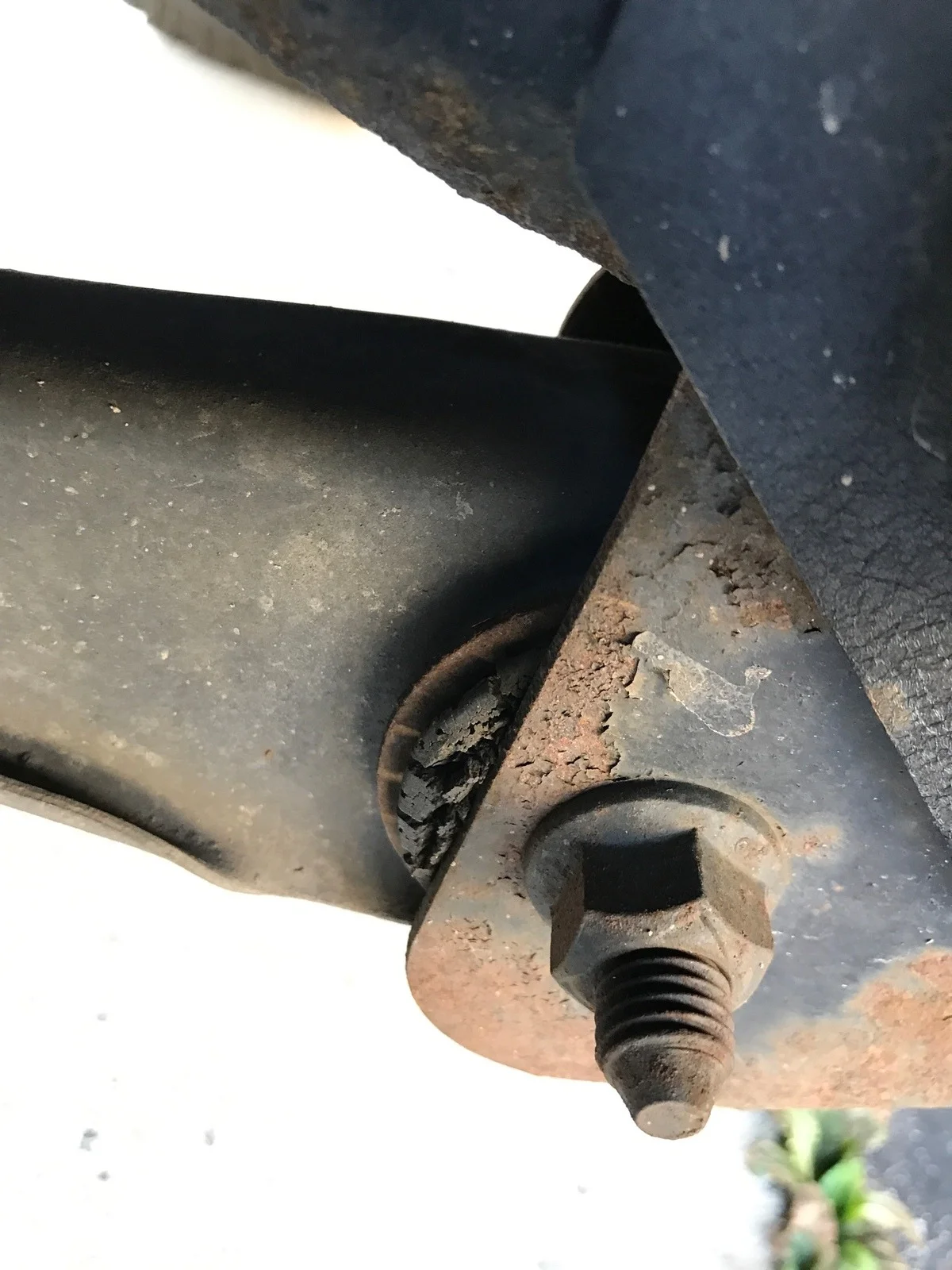

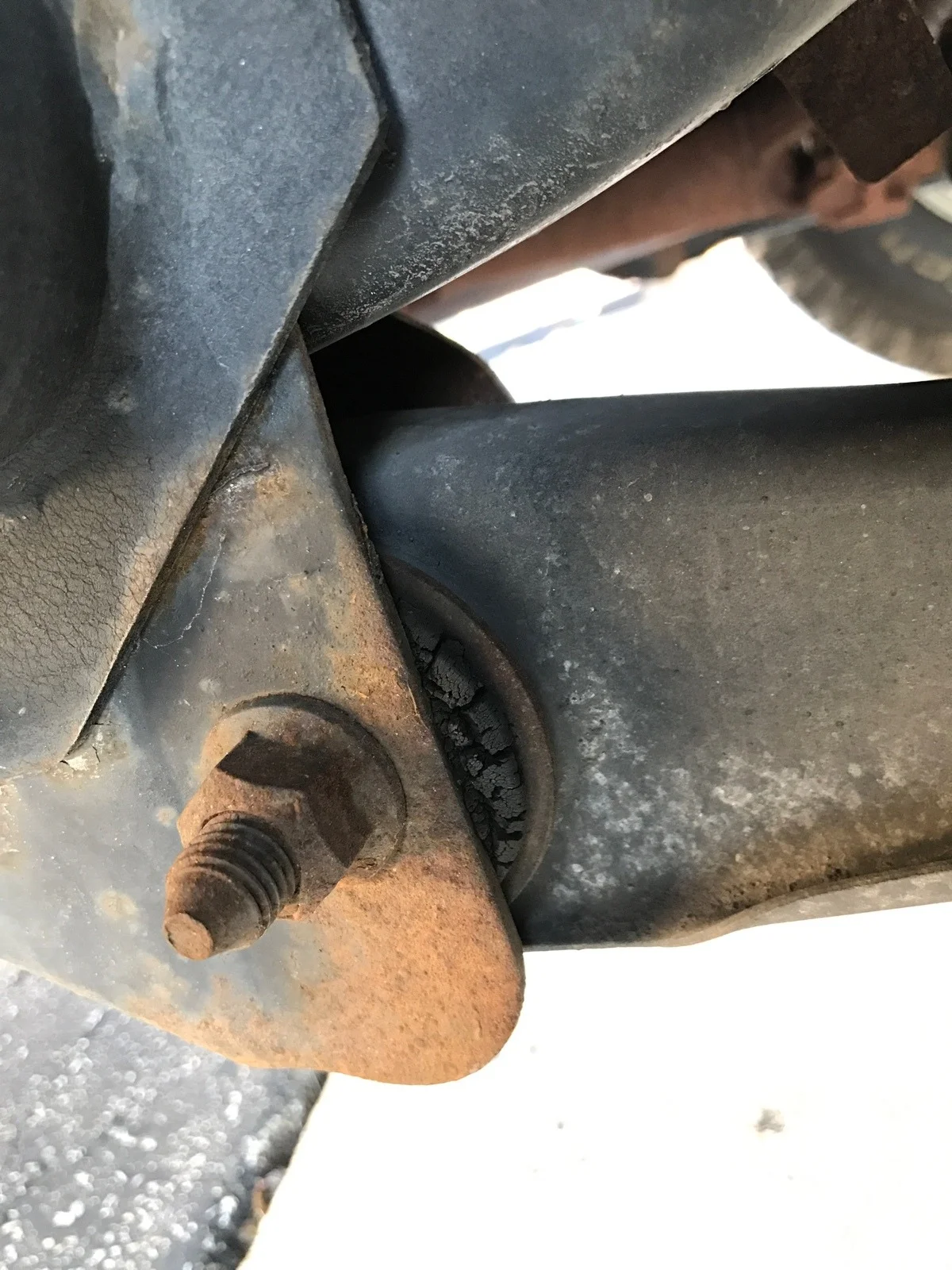

I took a glance at the rear control arms bushings, the forward ones are kinda cracked up. Nothing looks torn or off center in the mounting area... Will crawl under tomorrow and take a closer look. I'm in school to be a radiologic technologist. Graduate in May. Just wish Dad was still here to see me graduate.
If you can get some good pictures of them (try to use a flash light if you do), we can help tell you if they need to be replaced or not if you aren't sure.
I'm sorry to hear about your dad. I'm sure he would have been proud. Congrats on the up coming graduation!
Here's pics of the rear control arms, what I could see. These are the frontward/chassis end. Track bar looked good... shocks looked recent, I'll have to poke around in the folder Dad had for her and see when he did them. They were even Mopar shocks...
Wow... Those bushings are TOAST! I'd replace those things ASAP. I'd be willing to bet that could be the source of your noise right there.
