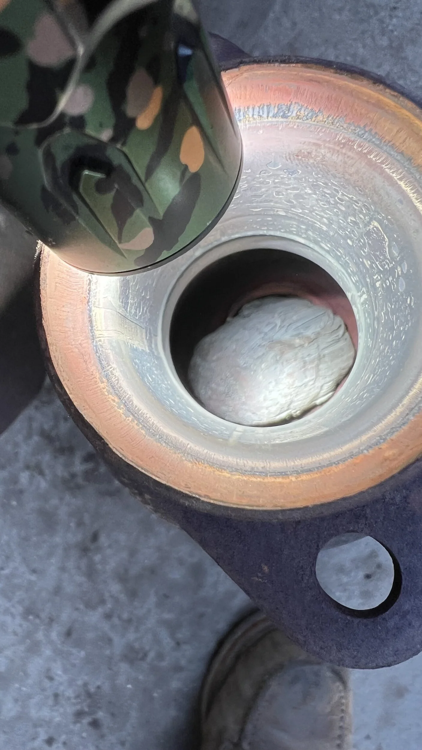

I would check the mini cats. Here’s a melted mini cat that caused a single cylinder misfire code only after cruising on the highway for a period of time followed by limp mode.

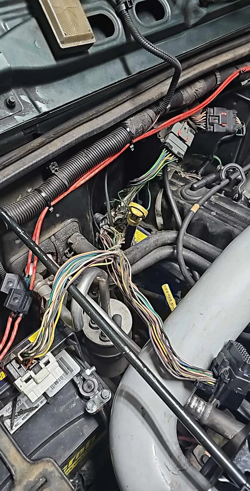

Unplugged bank 2/1 o2 sensor last thinking the same theory. DTC for that one popped so I test drive..same thing. CEL flashing only under hard load. I hook the noid back up...nothing. key off engine restart I have flashing again. I can't seem to figure out why I loose injector pulse then a quick KOEO and it's back. I came back home to check resistance, ohms out. No O/L. See attached photo. I have traced every freaking wire. I'm drawing a blank as to what is causing this.

Yes, I stripped it down the other day. No signs of any breaks. All wires ohm out pertaining to #6 injector. I am getting injector pulse when restarting engine. Only lose it under hard load. I can duplicate the issue everytime
How much of the wiring harness did you strip down? I’m thinking you may have to go deep into it
I'm with @Chris on digging deeper into the harness. These jeeps are known for wiring issues in the harness behind the valve cover.
I would open it up and reinspect for chafed or broken wires. Also inspect the connectors for water intrusion/corrosion.
You said that you Ohm'd out the circuits, perhaps you need to do a voltage drop test.
You can have a wire with all but one strand ohm out perfect but if the circuit is loaded, it can create excessive resistance.

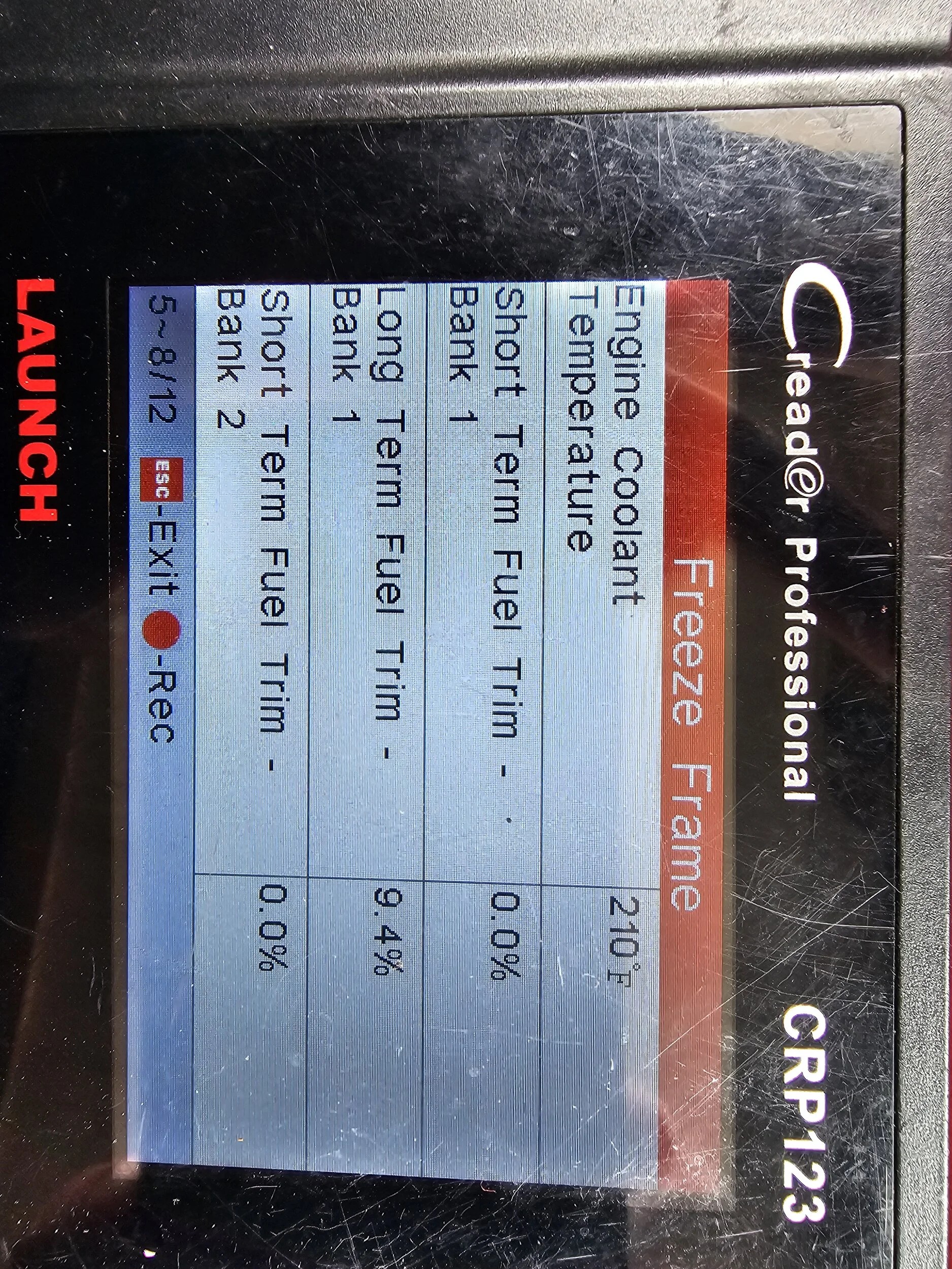

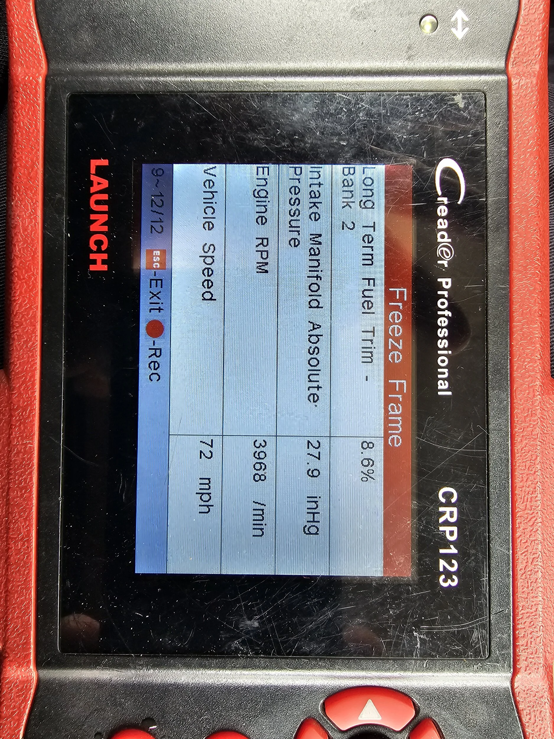

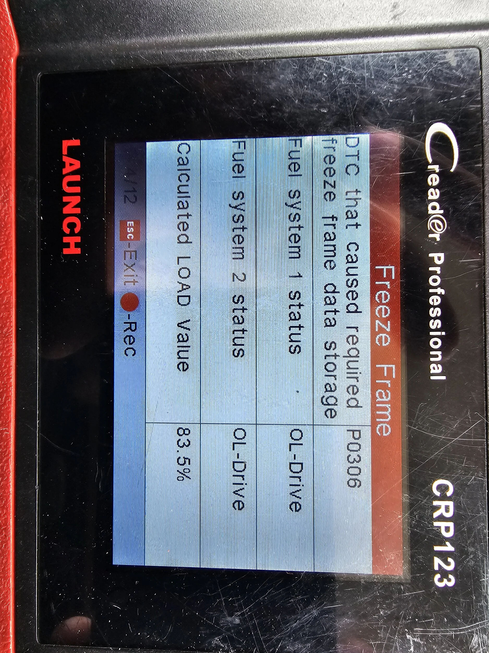

Mostly wondering what's going on with the CPS.
Some good data there...but no smoking gun and I'm sure there are more data points.

I will get a different scanner tomorrow, it's a lot more detailed then my readers. I will update then. Thanks for your time on this. And I'm so tired of throwing parts at this thing. I can drive 100's of miles with no CEL. The minute I WOT I get this. Seems to run way better cold, once warmed up is when it seems to f'up. I did replace the coolant temp sensor with an oreily I believe. Seems to be reading fine. WE will figure this out I'm sure.
