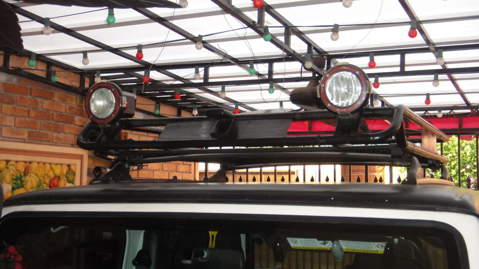

I have front and rear LED light bars on my Grand Cherokee 5.9 but decided to go in a different direction with the TJ. After installing an Explorer roof rack on my hardtop I installed a pair of eBay 35W HIDs up top. Bright as looking into the sun. Like these but from a different seller.

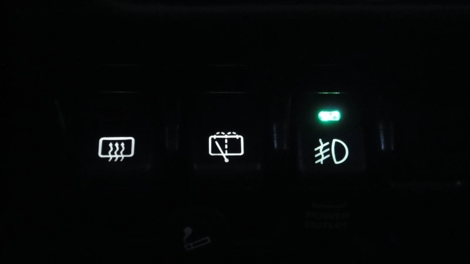

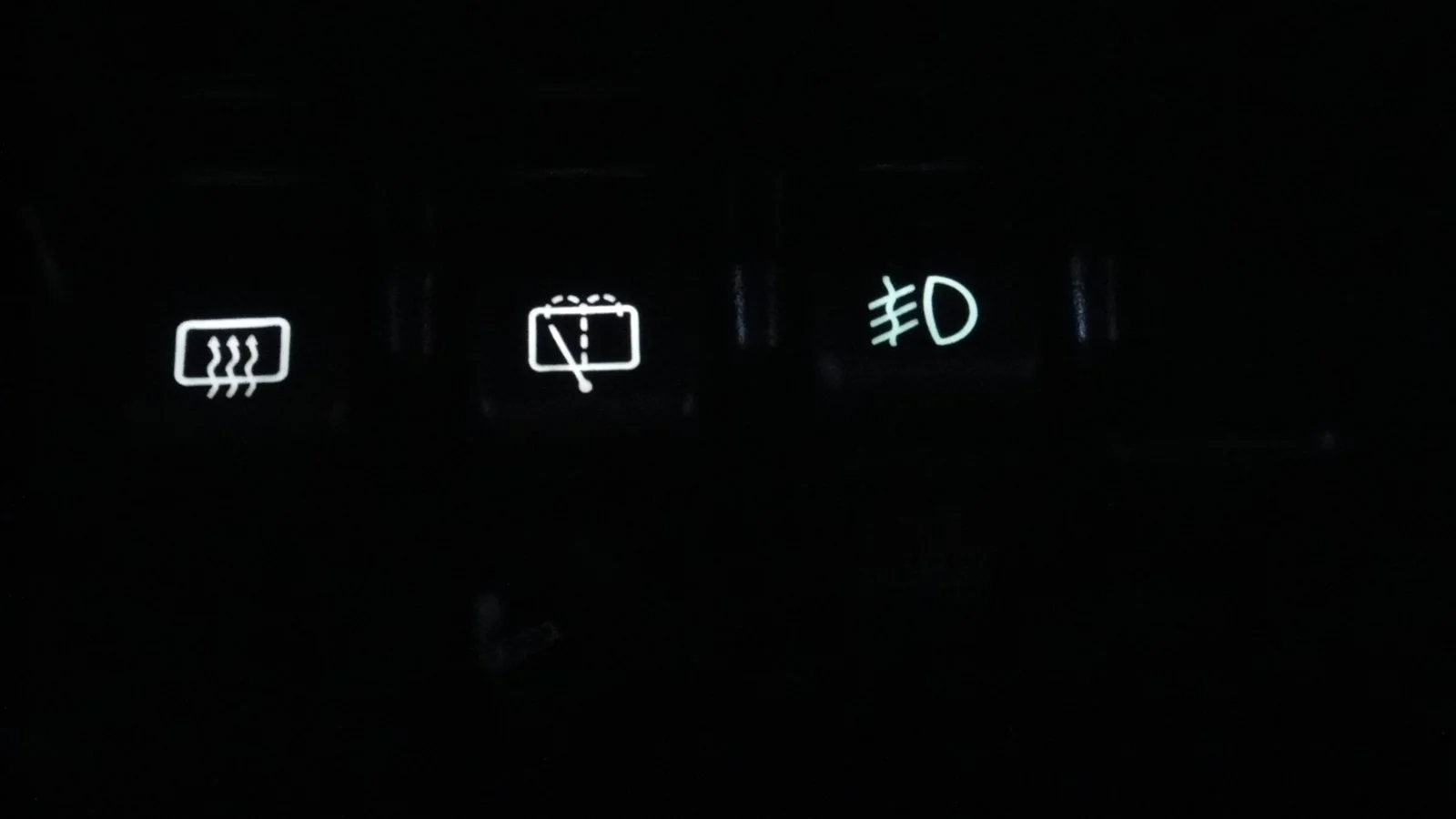

Also bought a pair for the 5.9 to be mounted on my Waag front brush guard but that's another story. The HIDs came with a wiring harness and relays. Easy install. Also purchases an OEM fog light switch from a Cherokee so that the dash would look factory. I first used an Autozone switch but couldn't find the damn thing in the dark because the switch only lit up when the lights were on. now I have a lit switch that's connected to the dimmer circuit and easy to find. It's all wired to behave like the factory installed fogs.
That looks very clean with the factory foglight switch (good idea!). You'll have to take some photos at night so we can see how well it lights up the road at night.
Wow, those are cheap! Cool that the ballasts are mounted inside the light assembly. That makes for a much cleaner installation.
