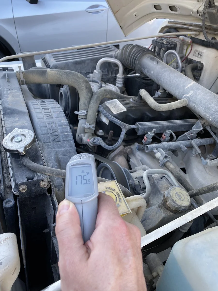

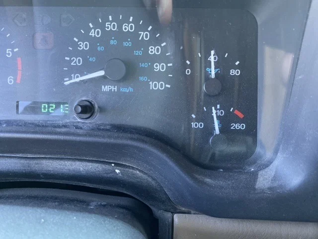

View attachment 122551View attachment 122552
With 175 at the housing, you should be getting hot fluid into the heater core. Are you sure your diverter door is working properly? Are both core lines hot? Plug?
I echo the recommendations of replacing the tstat. Mine is just ever-so-slightly left of the 210 mark since I overhauled my cooling system.
what did you find?
Yeah, heater hoses are hot. I flushed the core when I redid the cooling system earlier this spring and replaced all the hoses. When I say it's not great I don't mean it's lukewarm, it's just not would I would expect a normally functioning heater to be. At full blast from a warmed engine while driving I'd think it should be uncomfortably hot even if its 15 deg F outside and instead it's just enough to keep the interior warm. Maybe there's still some junk in there though, can't specifically recall that I flushed it both ways.

I'm resurrecting this thread because after installing a 3rd Stant 195 t-stat, replacing the heater core, radiator & doing some other engine work my temp is still in the same place. I'm not really concerned about it, but from what I understand on the 4.0s they're supposed to run at 210 so I don't want to run the engine long-term under its optimal temperature.
The temp gauge always stays about 2 needle widths to the left of center, and after driving around for a few days recording live data the highest reading I get from the ECT sensor is 196. I'm not sure I should really give that much of a shit about it, but it annoys me.
