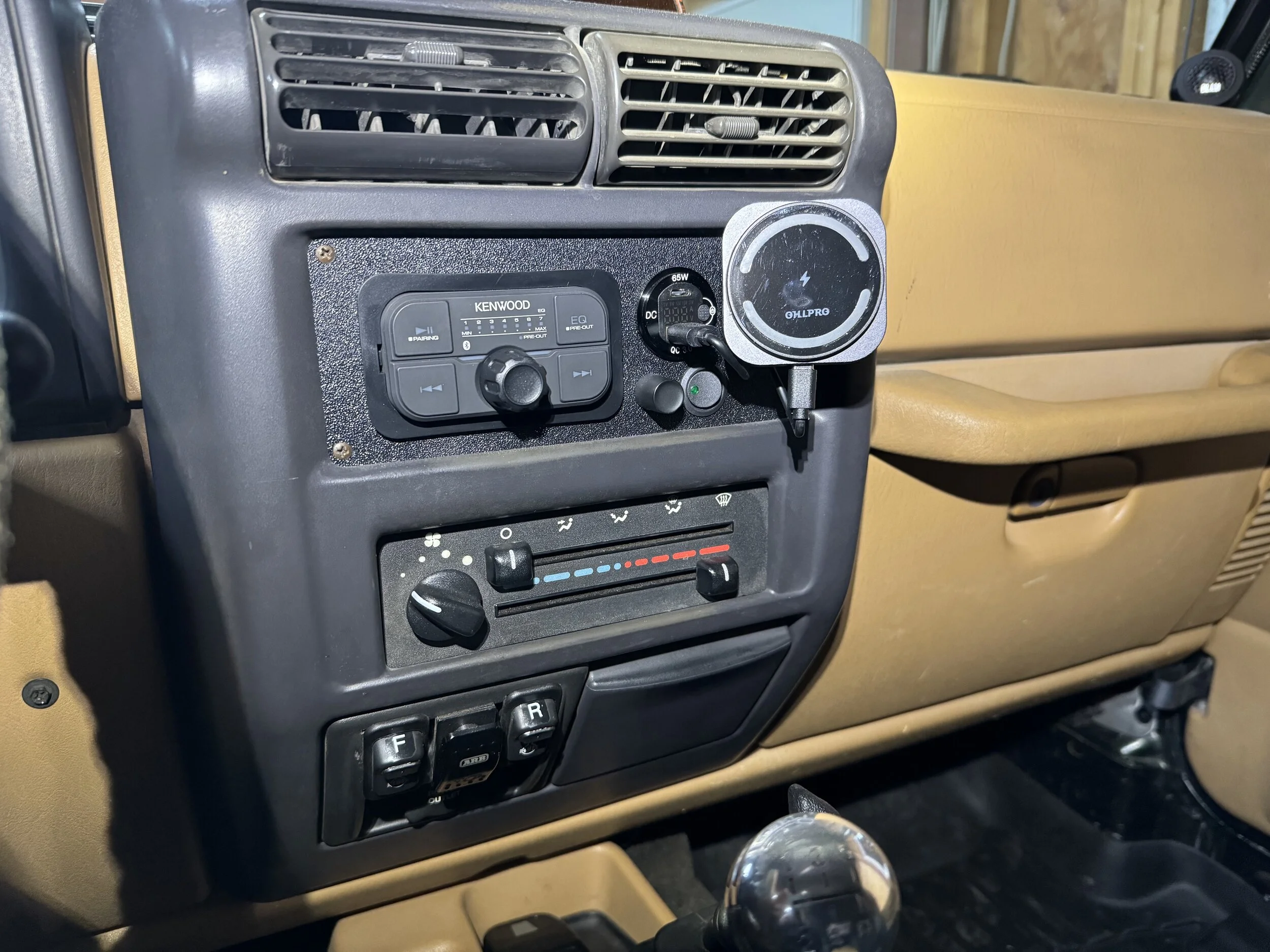

https://ssvworks.com/products/universal-bluetooth-rocker-switch-audio-system-with-200-watt-amplifier

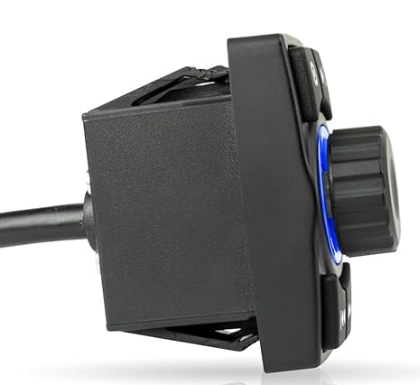

This is essentially a simple bluetooth interface connected to a small amp that still puts out more than enough power to drive the factory Rubicon speaker setup. The beauty of this setup is the size and the usability of it. Think of the size that a Carling switch - like the one ARB uses for their lockers - would take on the dash. In that space, they have somehow managed to integrate 6 controls (volume knob that also push on/off, a mode switch for AUX vs Bluetooth choice, play/pause button and fwd/reverse controls). That is STUPID good use of space.
This is how it looks.
The amp it is connected to is small, has a metal case, seems adequately finned and can be fit in the space of the OEM radio. This thing is advertised to put out RMS 25Wx4 (4 ohms) or 50Wx4 (2 ohms). Has 1 low level ore-out (4 V). More than plenty to drive a factory style speaker setup, I think.

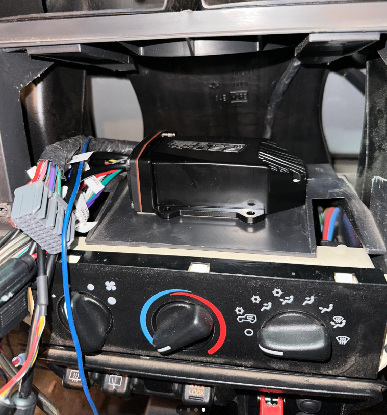

Size reference inside a TJ dash -
The BT interface is housed behind the front controls.
Once I saw this thing I realized it would suit my needs perfectly. Hop into the jeep, set it up to connect via BT, mount the phone for maps (or whatever audio one desires, Youtube/Spotify/Audiobooks/whatever) and off you go. The front controls are backlit white . The volume knob is pushed to turn the thing on and off. The volume adjustment has detents and all the buttons have a good feel. The ring glows solid blue when connected to Bluetooth and green for Aux in and the ONLY thing I wish were reversed were these two colors. But can't fault them for using blue for Bluetooth. I can live with that!

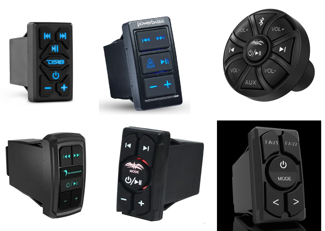

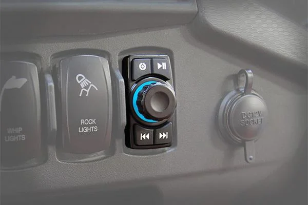

This idea isn't new; in the Marine and SxS world, there are many companies that make just the front wireless interface that connects with any amp of your choice. Few examples below but you will notice most don't fit the design language of the TJ.

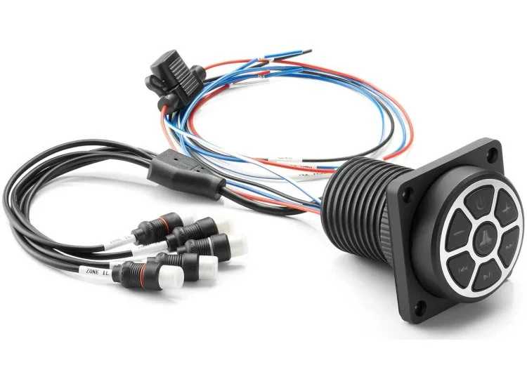

Companies like JL Audio that have good reputation make some stuff for the Marine world, along with amp and whatever. But also simply does not belong inside a TJ.

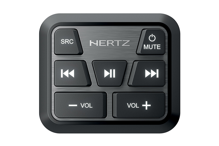

There was only one other interface that looked good OEM-like looks (made by Hertz) but it was too large for this Jeep build.
https://hertz-audio.com/product/hmr-bt/
It should be obvious now why I chose the SSV works item. It was very important for both Blaine and me to NOT have something that looks like a misfit in the interior. And not only that, it solved two problems at once - small sized controller + also came with the amp which meant we can just focus energy and time on the other things that needed to be done.

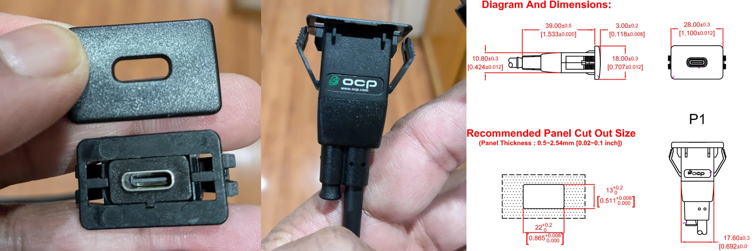

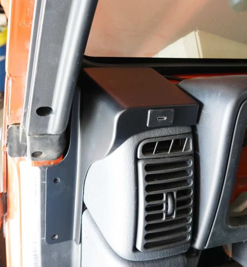

Actually USB-C ports, Blaine is always forward thinking.
GMRS antenna in that location is not a bad idea.
Maybe, we do have the consideration of retaining a semblance of a stock appearing vehicle and the antenna is part of that. If they make a GMRS antenna that looks like the stock antenna, then sure. Or if the stock antenna can be converted to GMRS, then sure.
No credit to me. I wouldn't know the diffence in any of the USB stuff. I know folks use it, I use it to charge a phone and upload pics out of a card reader. I have a box full of cables and I just keep trying to plug something in until I find one that fits. If it doesn't, I take the whole mess, drop it on Kat's desk and have her do it.
Sri patiently explains the difference, what all the little letters mean, the history of them from the time they were invented to where we are now in excruciating detail and it is about the same as a beer snob explaining which corner of the hops field they used to craft a particular brew and how that affects the taste when compared to a brew using hops from the other corner of the field. Since I care as much about beer as I do electronics, I retain exactly zero of the info. But bless his heart, he still tries.
I just explain the parameters and turn him loose. Hey Sri, you see that little space right there? I need a snap in panel mount port for whatever you need to charge that piece of shit smart phone you carry around. Fetch one up please and give me something to stick one end into that will give your phone what it needs. Then it shows up and I make a hole for it. Done.

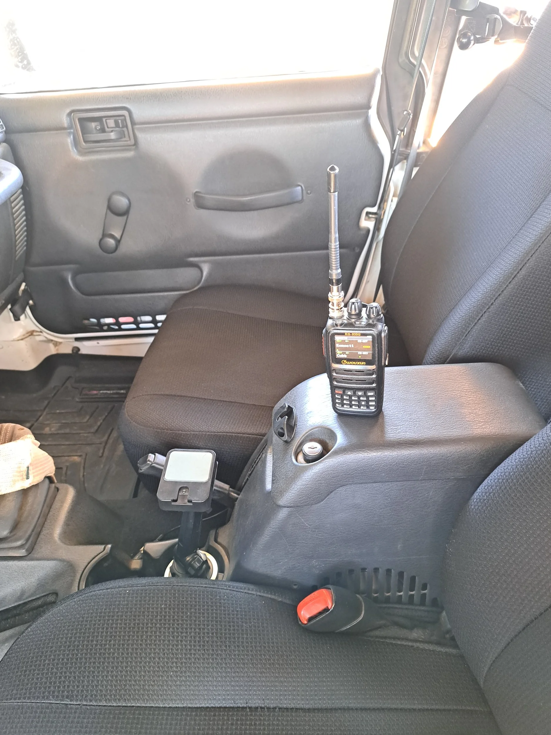

Good choice of radio Sri. I have the 1st gen of the 935G. I got one of those cup holder mounts for it. Probably overkill for your use case, but a solid radio. If you are just looking to talk to your buddies on a jeep run, those radios will do just fine without an external antenna.

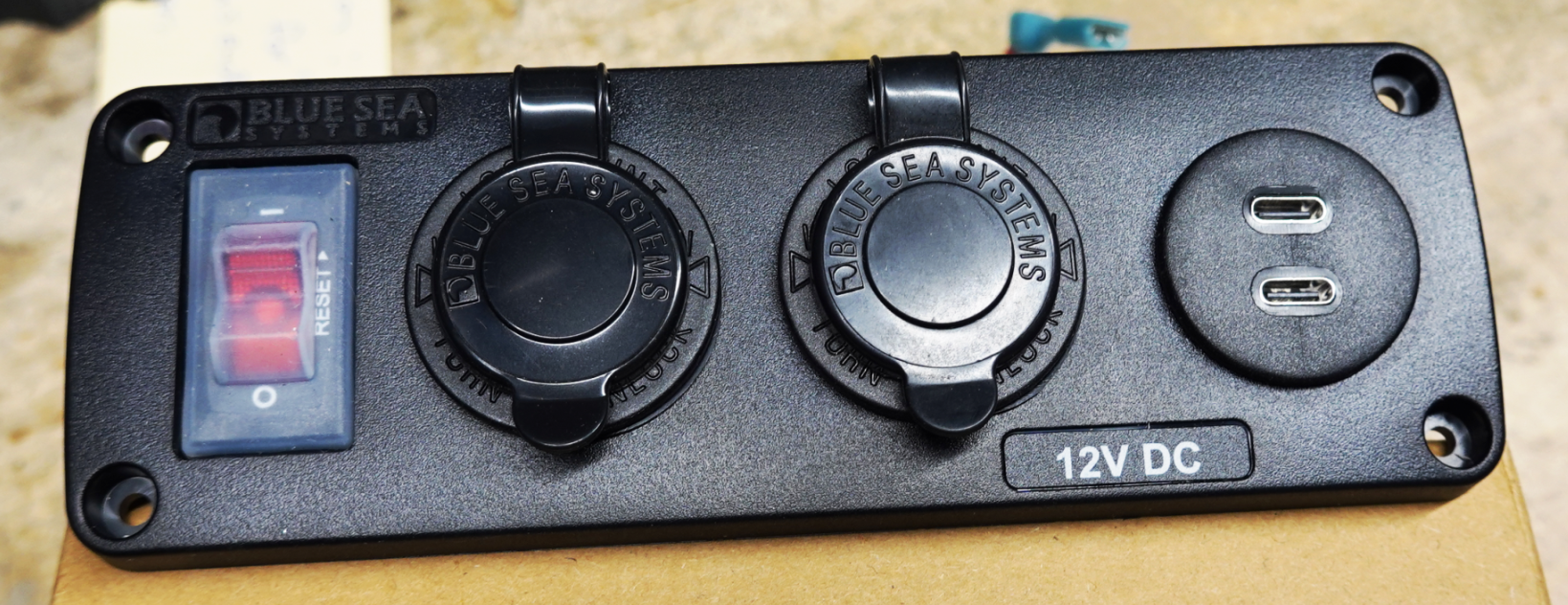

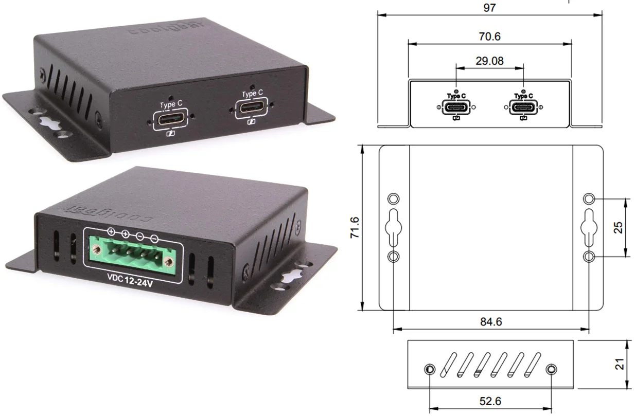

Part of the joy is the research and then finding USA companies with great customer support and excellent products. It's awesome being able to call and talk to someone that actually understands your technical questions and gives the exact information you were looking to get. The place I ordered the USB snap-ins for the front "control center" is HQ'd in San Diego. Excellent product.
(Click for larger pics)

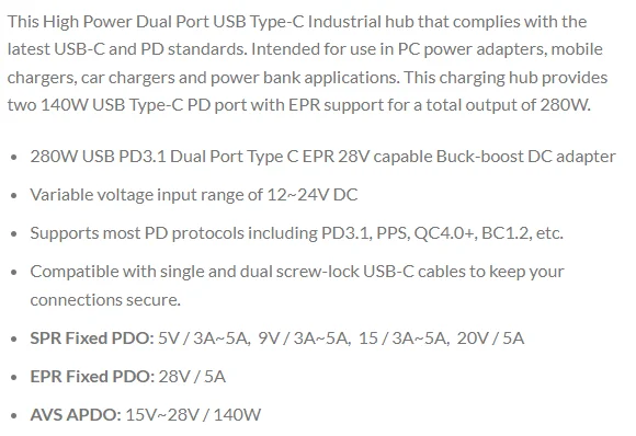

The company for the USB power supplies is HQ'd in Florida. I was very happy with finding thing below. This small thing can deliver 100W on each port with 12V DC input (and upto 140W with more voltage in). Built with vehicle use in mind, and more than sufficient for charging anything I would need to inside the vehicle. Supports all the modern USB power delivery protocols. This will go next to the SSV works amplifier in the OEM radio cavity and power the two USB ports. I ordered one more of the same thing for the rear panel that I posted above. I wanted to get an even smaller one (65W each port) but they were not going to be restocking for months and this one was still small enough for the space. The two port panel plug in the blue sea panel I posted earlier is also from these same folks.
If anyone cares for the specifics of what items I got, let me know and I can share the information.

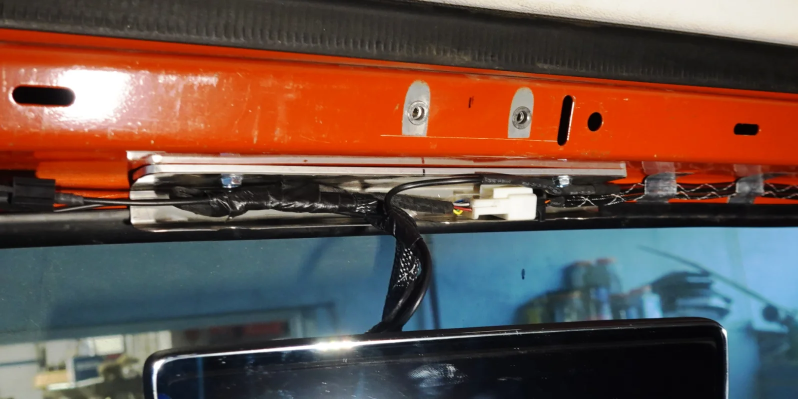

I wanted to share this photo that Blaine sent of the wiring magic for the camera mirror and the 5" backup monitor. That channel you see is obviously not stock. Because of the way the plastic trim needed to be cut, the bottom of the trim won't lay flat and Blaine fabricated that metal piece to stop it from curving and looking wavy. And seeing the opportunity, he made it a channel to help with the super clean wire routing. @mrblaine I hope I said this correctly, please correct if I am being a dumbo.
I love that no one will ever see or peek at all this behind the trim but irrespective, Blaine made it look super clean and OEM.

I looked at looked and I could not find a setup I liked for a smartphone mount. Primary use for me would be GPS navigation. There was one compromise or another, and usually more than one (location, design, cabling , mounting, stability...). I told Blaine about this and said that I liked the A-pillar location since your eyes scan that area automatically while driving. Blaine took all my needs into consideration and designed a mount by hand .. whipped it up in a matter of days. It is made of metal, and will be used with a magnetic RAM mount ball and socket system. The magnets are strong! Not only is super functional, but is also the best that I have seen that fits in the design language of the the TJ interior. The curves and the finish work on it is just spectacular. The USB port in that location will let us use a short USB cable to power the smartphone. No damned dangling cables!). The RAM mounts will stay in the center console till I need to use it.
I am really stoked to have this in my Jeep. Thank you for making this for me Blaine!
