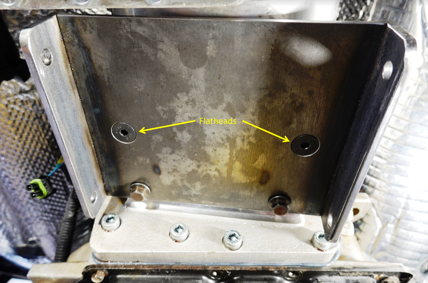

First is the transmission mount adapter base that attaches to the rubicrawler.. the sides are 1/4” x 2” to stop any chance of failure. It bolts up to the trans mount location on the Rubicrawler, like in the photo below. Notice there are 4 holes, 2 for OEM bolts and 2 for countersunk flatheads. First, the 2 regular bolts install to locate and hold it up but not tightened down.
Then the flatheads are put in, and fully tightened ..

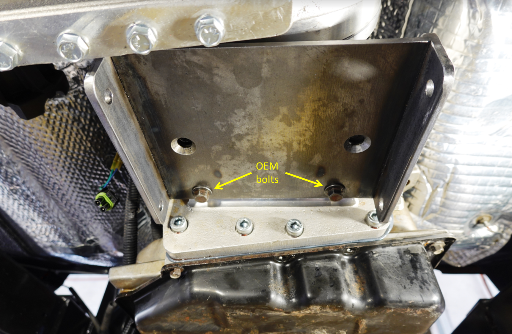

Then OEM bolts are removed.

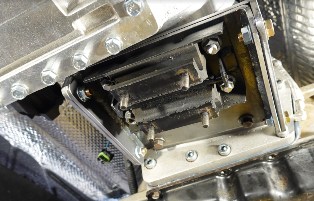

Ahead of time, Blaine had already custom designed an adapter that attaches to the base in the above photos. The adapter has studs with countersinks on the top side and flat head screws stuck in flush, and then tig welded around the edge on top so the screws cannot spin. The OEM transmission mount will mate to this adapter, and once the nuts on the studs are tightened, they will pull studs down into the countersink (so the welds only have to prevent spinning until the nuts are tight).
Below photo shows how the adapter attaches to the base. The connection between the base plate and adapter plate is made very strong, with 4 bolts through the sides (pink arrows) and the two OEM bolts that were removed earlier after installing the base.
Notice the fitment of everything .. and there is a very nice element of long range thinking here that will become clear shortly if you cannot spot it yet. I certainly did not till Blaine told me .. I will wait for @sab or @Mike_H to perhaps spot and comment before revealing it :)
With all that White Magic™ done ... the transmission mount bolts up to the adapter just like OEM.
Now ... ask yourself this question - How was this design process done? From adapter mount down, or from transmission mount up? :)

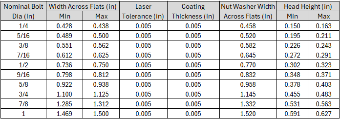

Oddly coincidental to what I'm doing right now. In fact, I was in Machinery's Handbook a short time ago getting tolerances for hex bolts in order to have some laser nut washers made. Since I don't like to do research every time I do something, I made a spreadsheet for future reference (notice the fifth column):

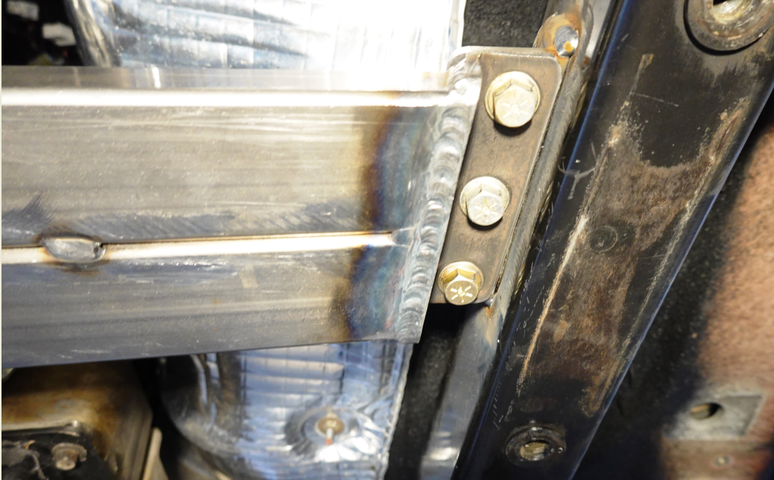

He then made the matching frame side flange that is nicely welded to the frame .. and 3 bolts connect them together on each side. This pic below shows the final installation showing how everything looks at the finish, but of course, getting everything situated exactly where they needed was not trivial.
