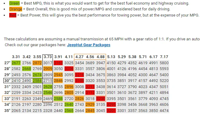

if you're cruising too low in the rpm, you're not in optimal power band and lugging the engine. There's a sweet spot at cruise load and rpm where the engine is producing optimal power at cruise and load...and your gearing + tires + overdrive is below that.
Ok, so according to this chart, I'm less than ideal with 3.73 and 33s. To get back to stock (LJ came with 30s originally) I would need to be at 4.11 gears, but that's hardly worth doing for the cost and effort involved. "Best mix" would be 4.27 gears, but that also seems like only a small gain.
Someone suggested 4.88 gears "where I should be"... I would appreciate the 30% improvement in final gear ratio at low speed on the trail, but that would also increase my highway rpms into like 4cyl range (70mph in 6th gear on 4.88s would be 2924rpm)... would the 4.0 be ok with that? If so, then I'm all for it. I'll start with regearing and see how much lower I want to go on the trail after that.
Does that chart include your transmission's .84 OD? You should gear for the final drive gear.
The chart is for 1:1 (5th gear in my case). Right now in 6th gear (0.84 overdrive) I can do 70 at 2235 rpm. That would go up to 2924 with 4.88 gears. What's a safe max rpm for continuous highway usage? I don't drive it a ton on the highway, but I don't want to lose the ability to do so.
Your torque peak is in that 2800-3200 range, which makes it a nice speed to cruise at. With a 6 speed and 33s I'd go with 4.56.
I've had the following combos in TJs:
6speed/30/3.73
6speed/33/3.73 - tolerable in Oklahoma, not so great in Colorado
6speed/32/4.88 - too low
6speed/35/4.88 - perfect
5speed/31/3.73
5speed/32/3.73 - miserable
5speed/32/4.56 - perfect
5speed/32/4.88 - crawled better, higher rpm on the highway than 4.56 but still ok. It was great in Colorado. Wouldn't have wanted it in OK with our new 80mph speed limits and not enough mountains to need the extra torque.
