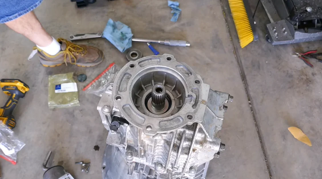

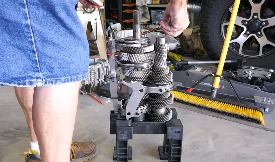

if you haven't mounted the transfer case to the back of the transmission, would you mind taking a couple of measurements for me?
1. How far the output shaft protrudes beyond the mounting face on the back of the NSG370
2. How far up the output shaft could an input gear go, either from the end of the shaft or from the t-case mounting flange.
Even if 241's were all short-input, it's not immediately apparent to me (based on these screenshots from your last build video) that a long-input 231 wouldn't work. The AX15 output has a consistent diameter with the splines machined into it, whereas the NSG370 looks like it has a reduction in diameter that the splines seem to just disappear into. It seems like if the input gear went past the splines it shouldn't thrust load the shaft unless maybe it got all the way to that machined journal area.
Looks like the nsg370 output shaft seals the output shaft seal. Other transmissions rely on the transfer case input to seal the output shaft seal. Those are the instances where short vs long input are critical. The nsg very well might bolt up to either input after seeing that picture.
