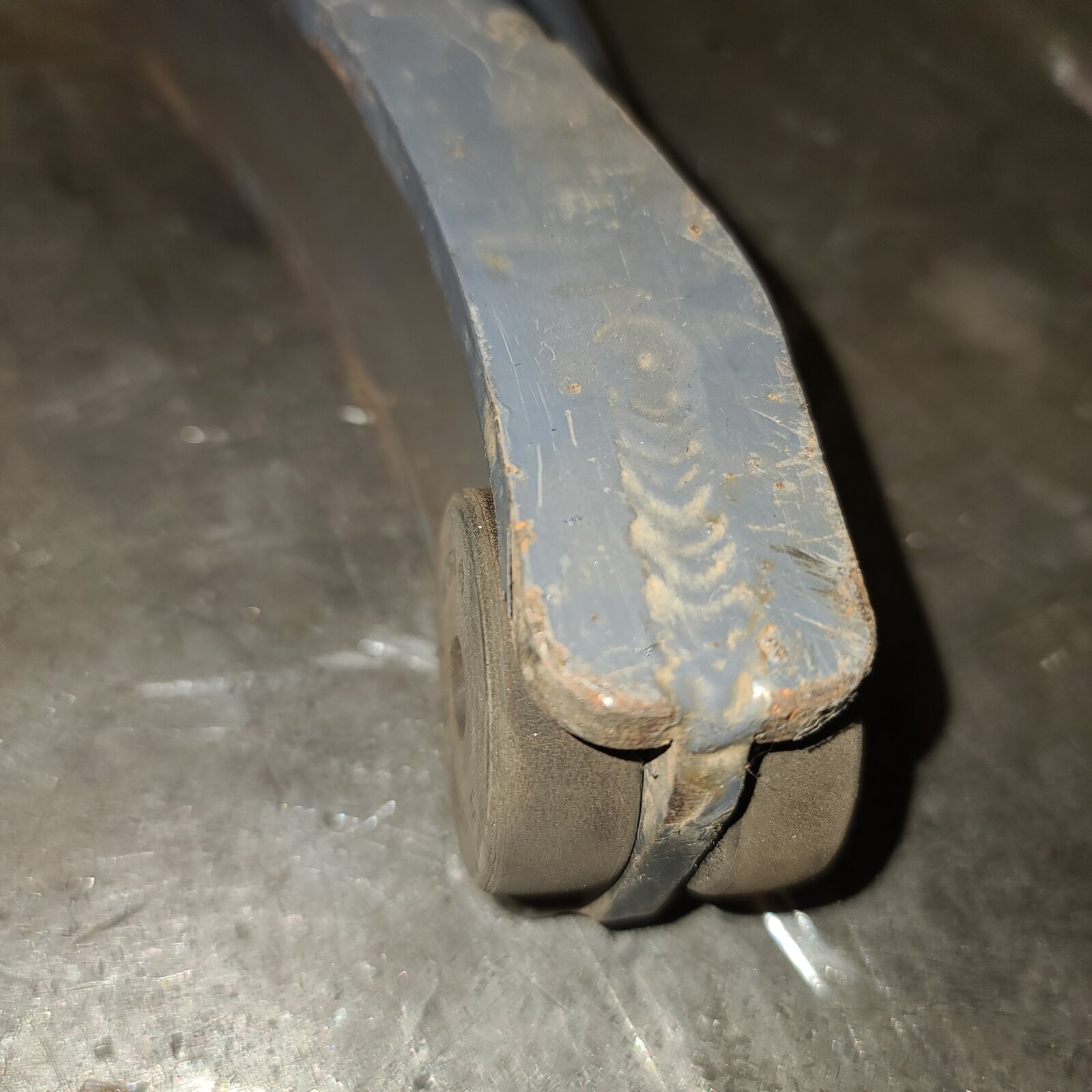

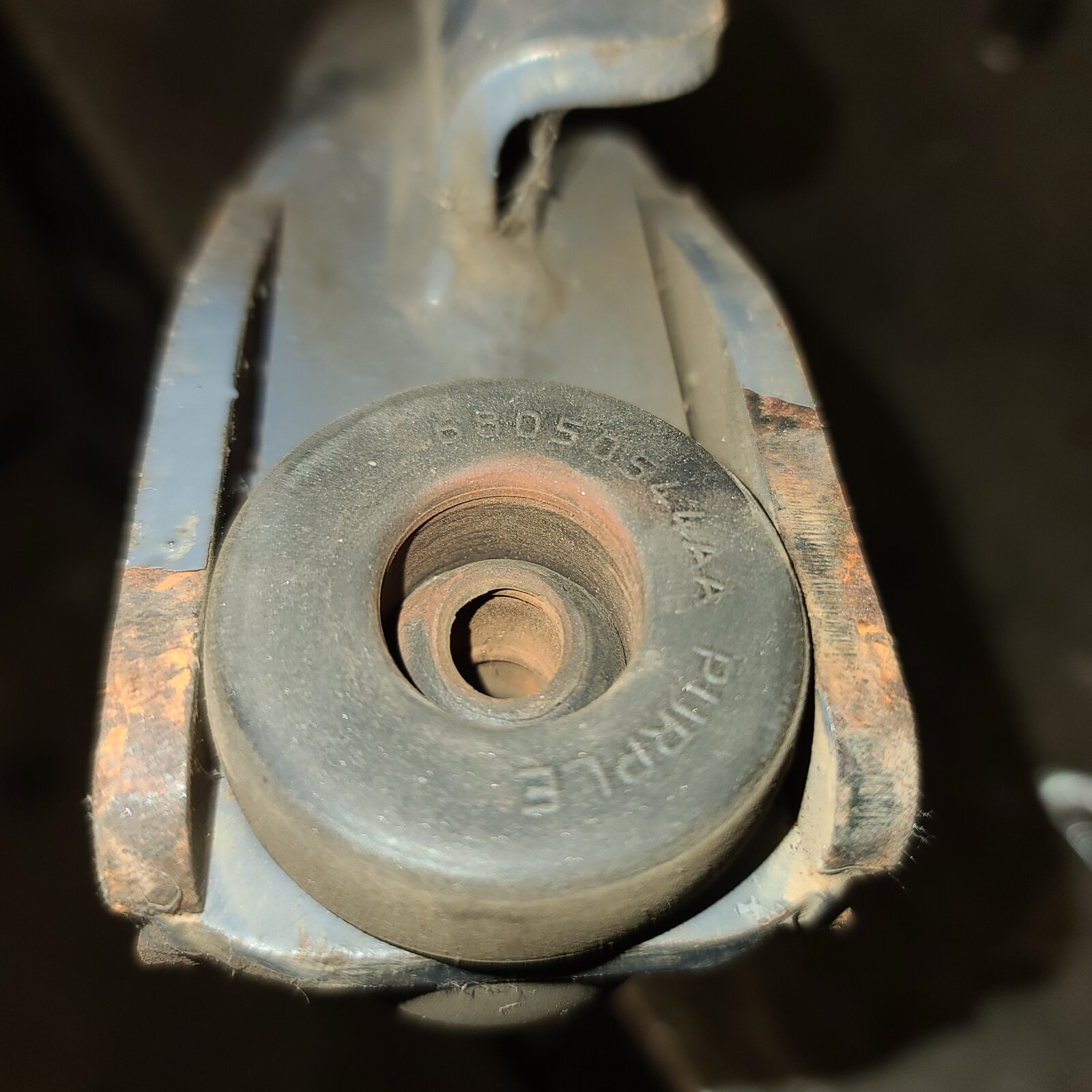

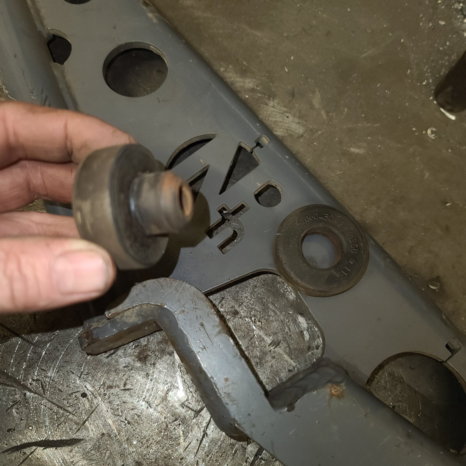

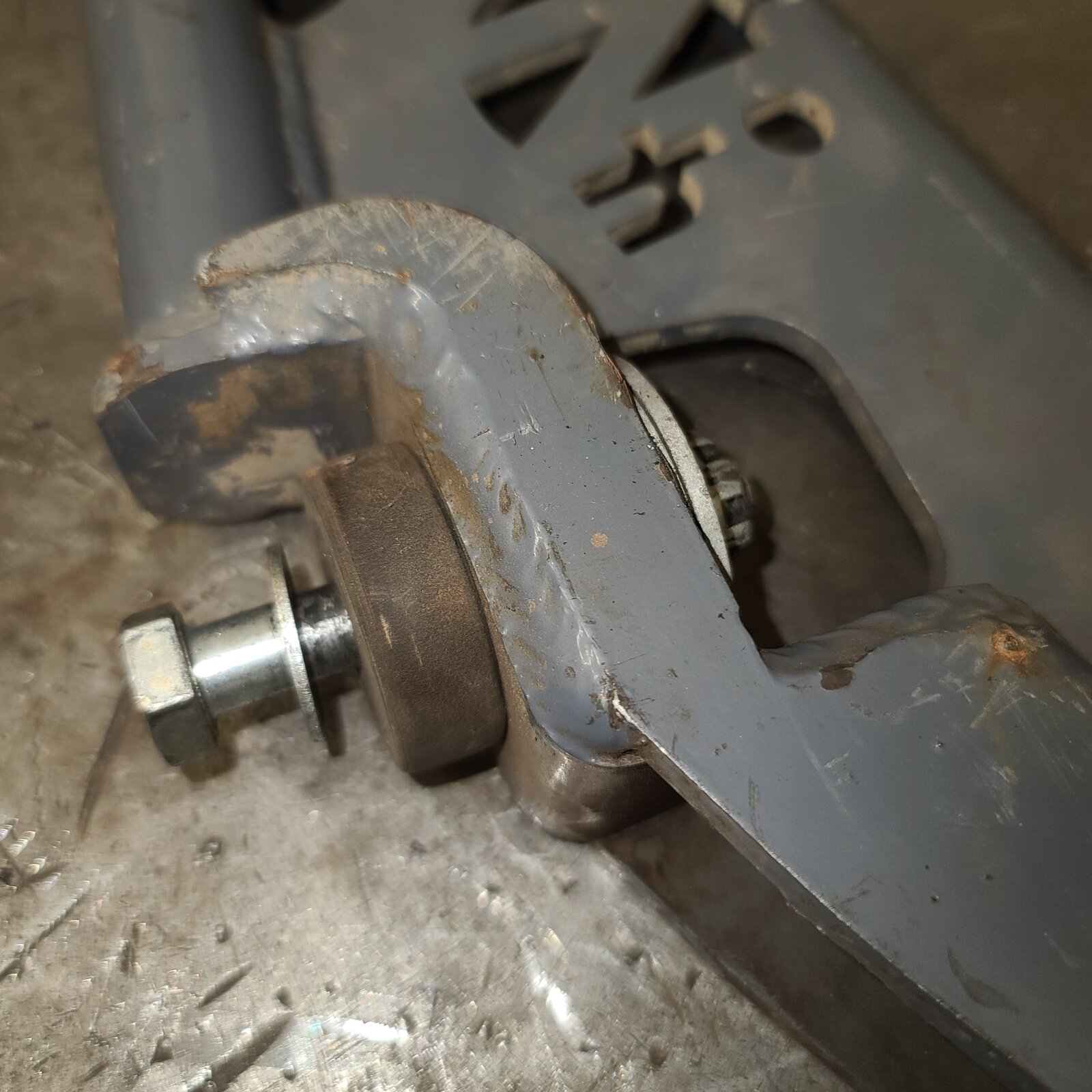

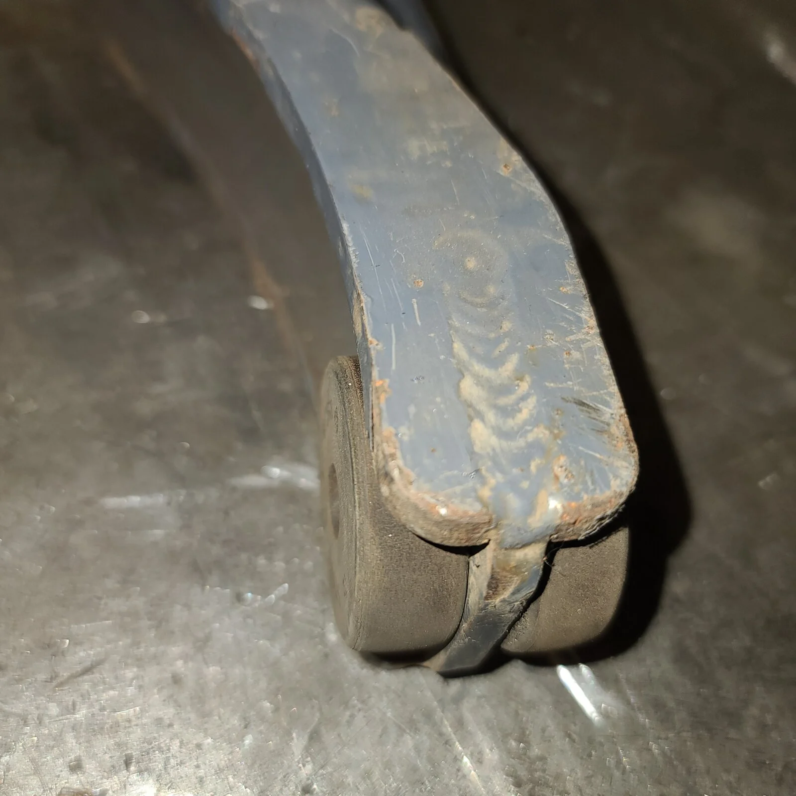

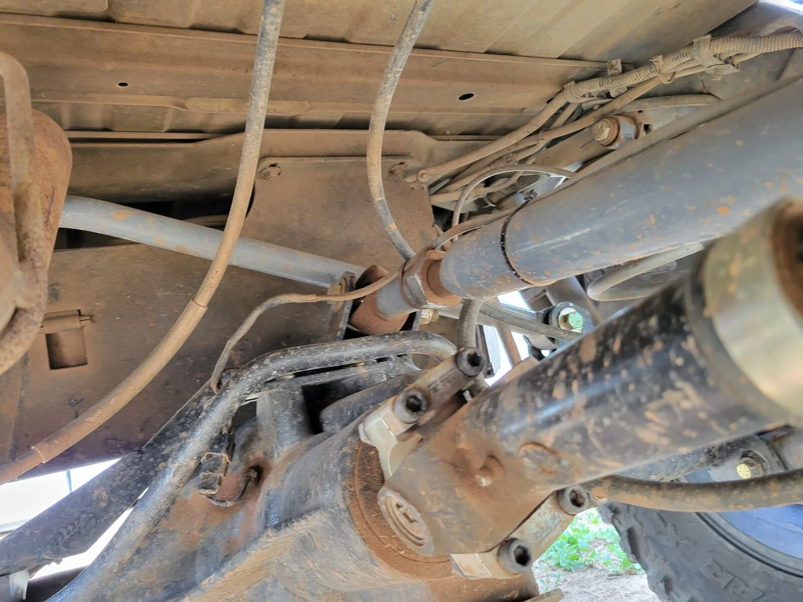

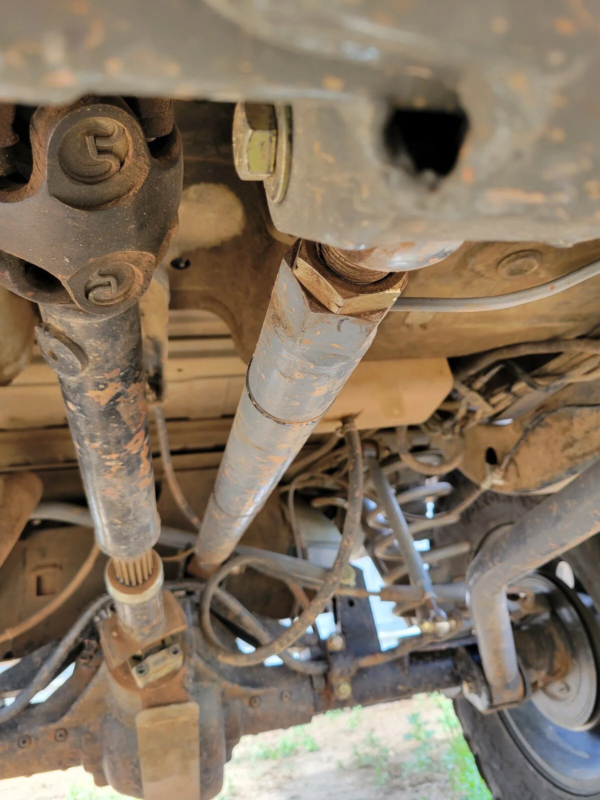

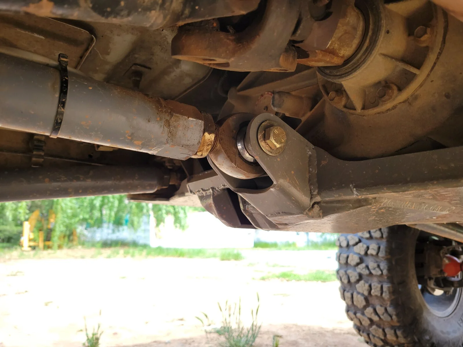

Does anyone know where to find the bushings for the rear Dana 44 stinger? Seems like a fiber-embedded rubber.
Which bushing are you looking for? Can you post a picture of it? That would help us to try and help you out.
David Kishpaugh
TJ Guru
Lifetime Supporting Member
Jan 20, 2016
259
Estacada, OR
07-18 jk wrangler factory front upper shock bushings work. They are a tad soft but our other options are getting slim short of making derlin bushings in the lathe.
It'll take a stack of washers to keep the rear from rubbing metal to metal.
