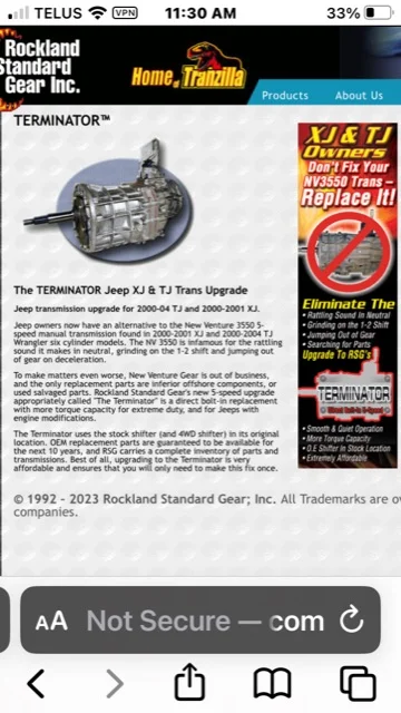

To fully understand NV ( new venture ) transmissions go to Wikipedia. It was a joint venture project by GMC and Chrysler. There are no original nv3550 transmissions only remans, theses remans use cheap rebuild parts usually from China, Vietnam, Thailand etc. you get the idea. They have an inherent sloppiness and any decent shop technician will tell you this. Do not get ripped off be informed!!!. Put a AX15 back in. Check out Transzilla. Jeep dropped the ball and they rub their hands together with greed when they see you coming. Don’t believe me ask someone who owns a 3.6 aka ticking time bomb. Shame on Jeep. NOTE …… If you’re buying a new Jeep order it without a motor and tranny have a professional builder put a proper drive train in. Cheers Cobble Hill Bill. P.S. when these issues came up ( early 2003 ish ) a service memo was issued to all Chrysler shops. 😁😁

What year, engine size, type of transmission, is this a reman transmission?. I CAN’T stress this enough OEM does not mean original equipment manufacturer……. It means made to OEM specifications usually in China, Vietnam, etc. Major parts suppliers ALL !! buy from the same supplier then are reboxed with their label on it. I’m sure there are better manufacturers out there BUT NO true original replacement parts. Bottom line ……. These are old vehicles that for the most part are driven hard and when it comes time to find 20-25 year parts they will be of poorer quality and they new Jeeps have there issues 3.4/3.6 aka ticking time bomb, never ending code trips, you have to be a master technician with access to proprietary Jeep computer to analyze issues. BUY AN OLDER JEEP take out nv3550 replace it with Terminator AX15 , pick your choice of stroked crate motors and save $$$$$$don’t get sucked into the must have new and shiny philosophy.
You seem to be exceptionally angry at the 3.6L motor. If these first 3 posts are any indication, we're all in for a wild ride.
