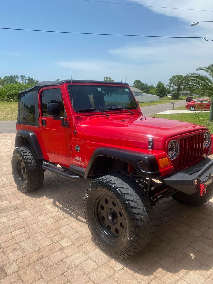

Hey guys. We member here. Have a question. 2005 Jeep Wrangler 4.0. I’m getting a P0031, 37,51,57. All hit at once. It’s 02 sensor heat Circut’s or something. Jeep only has 50,000 original miles. Runs great. But this is really irritating me. I checked the wiring. Seen no issues. But I know all 4 02 sensors didn’t go bad at the same time. Anyone have this issue and a fix? Thanks in advance!

First off, that's a damn nice TJ! Absolutely love the red, and it looks clean as hell.
