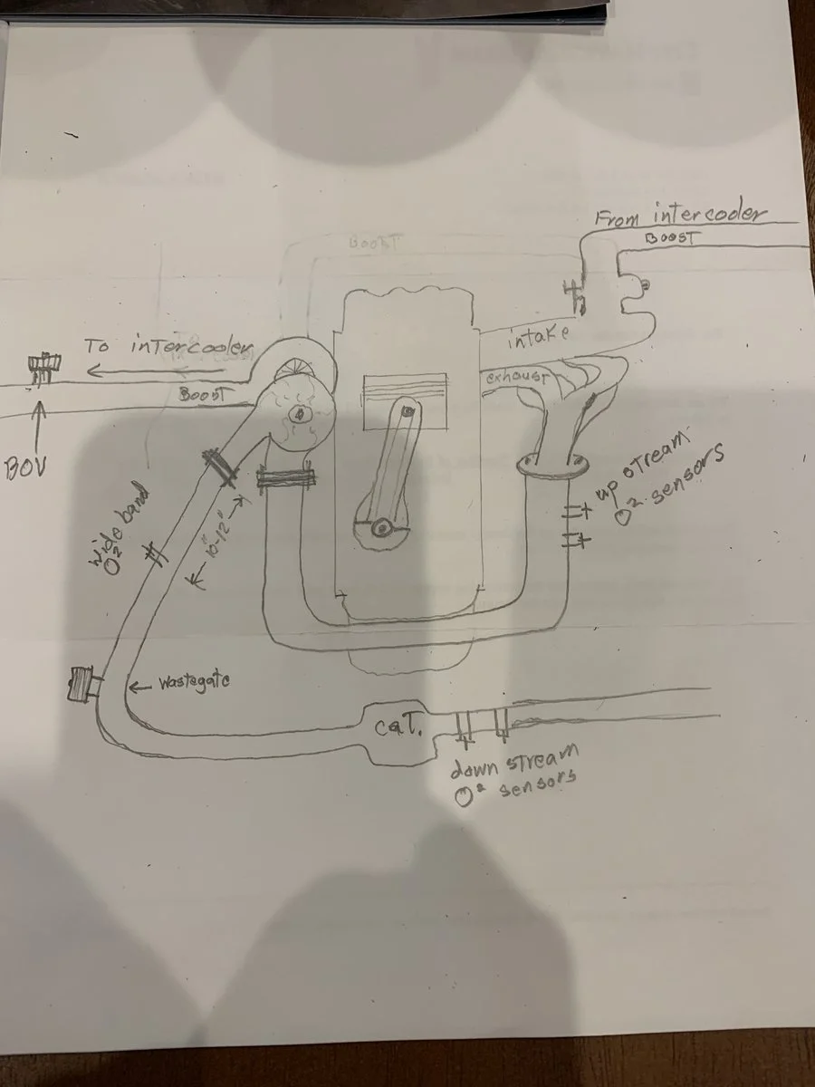

Here are the old parts and the new parts. Notice anything missing? Of course the O2 sensors and the cats. This cheap eBay kit doesn’t care if I live in Ca.
Questions are: do I need to add threaded bungs(I have welding capabilities) ?
Or Install as is and the tuner will take care of the computer? Or option C. Keep the OG exhaust and fab the connections to and from my turbo so I can keep cats and OG sensors?

The top 2 (pre mini-cat) which are on your OEM header are required. The engine WILL run without them but won't ever run right leaving performance and MPG on the table. Assuming you're retaining some of the stock tuning such as when you're not in boost it'll make a difference.
The lower 2 (post mini-cat) are for emissions monitoring only. I'm not sure if they will perform as the computer expects if you move them past the exhaust pipe cat since that cat won't fire as hot or quickly. I had them disabled on my ECU so I don't get a CEL for them since I'm monitoring my AFR separately and I figure that the environment is better off if I can actually read the AFR instead of letting my 7th injector run rich.

So it is possible to disable them in the ECU great news. I also understand better why it’s important for them to be close to the engine as well. now for the upstream O2 question. Do I have to reinstall two since it goes into a single pipe now? Or could I combine the wires and just have one upstream sensor?

Yeah, simply connecting all the wires together isn’t a good idea, an independent AFR sensor is likely the best solution.
You should probably discuss the issue with the individual that will be doing the tuning.

This is where I’m putting the upstream bungs. Probably 12” or so from OE position. Just can’t bring myself to take the header and intake off again. It took me a whole day to get the damn thing on with the intake manifold 🥴

Yeah, removing and replacing that thing is no party. You may run into some issues using both sensors on the same exhaust stream though.

That’s what I’m worried about but I want to have everything in place when the tuner is ready. If he says he can tune one out or he gets a good reading from bother then great. If not I can always plug one up and go from there. That’s my plan at this point. I’m sure it’ll all change 🤡
