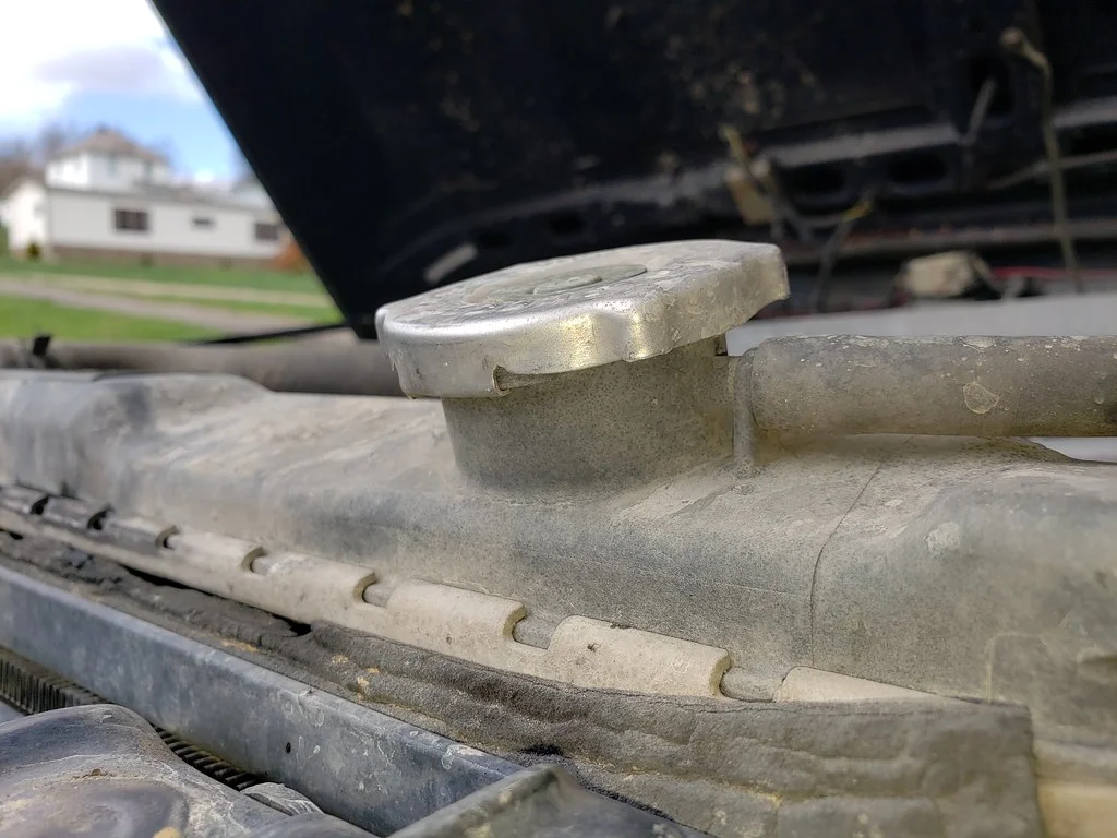

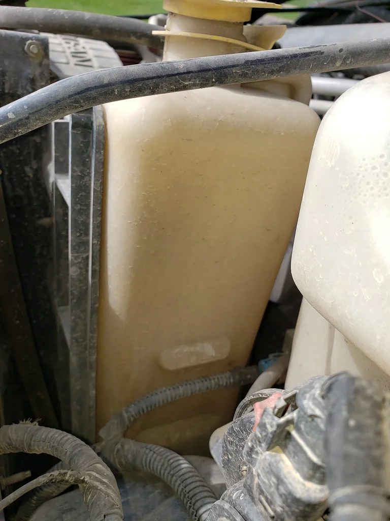

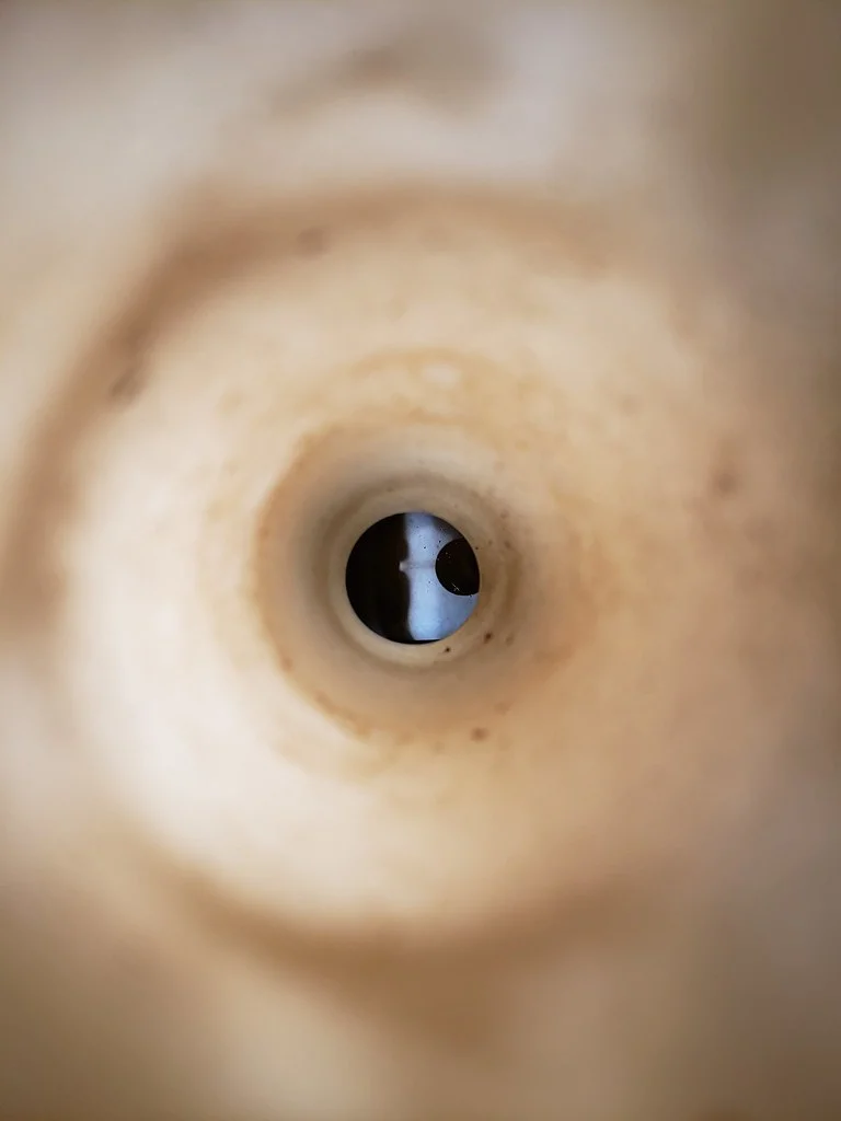

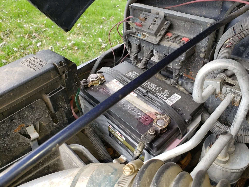

So, I went out and took a look and some pics for ya.
The coolant level looks fine in the overflow reservoir. The radiator cap was on nice and tight (though I think I'll get a replacement just in case).
Battery terminals had a bit of corrosion on them. The battery is practically new (less than 6mos old) and the guy at Advance put it in for me. Put the anti-corrosion stuff on the terminals and all.
