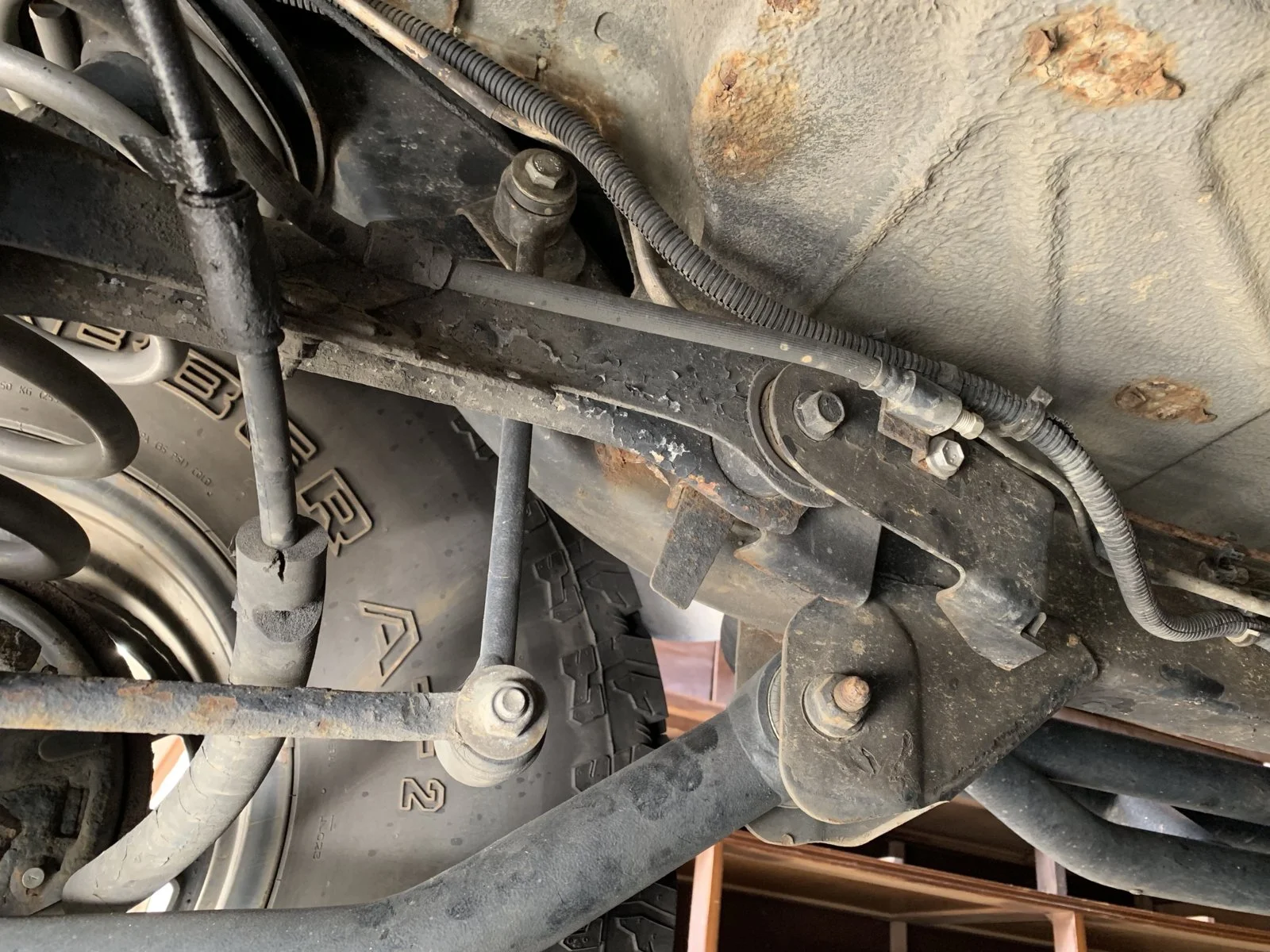

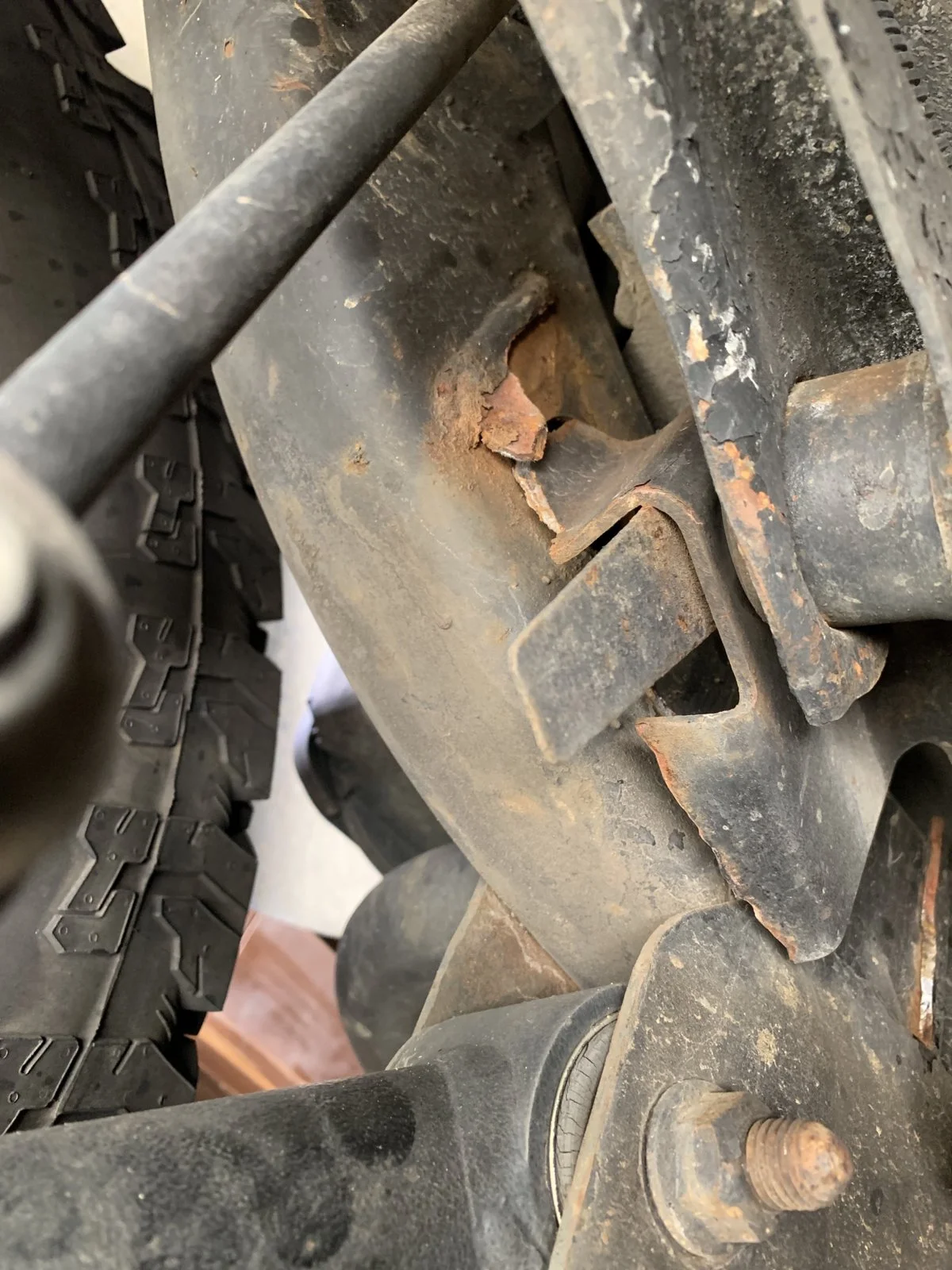

i have a similar issue. mine is making the sound only when i hit the accelerator. when i left off it stops. got under it thinking maybe a u joint but no signs of that. upon further inspection i found my rear left upper control has ripped off the frame. the guy before me didn't put adjustable control arms on it. i was hoping to them on my own time. i think this is a separate issue and not the cause of my knocking sound seeing as how it only happens when throttle is applied. i attached pictures of the control arm.

Jon Wildes - nice broken bracket. it looks to have shifted quite a bit....
