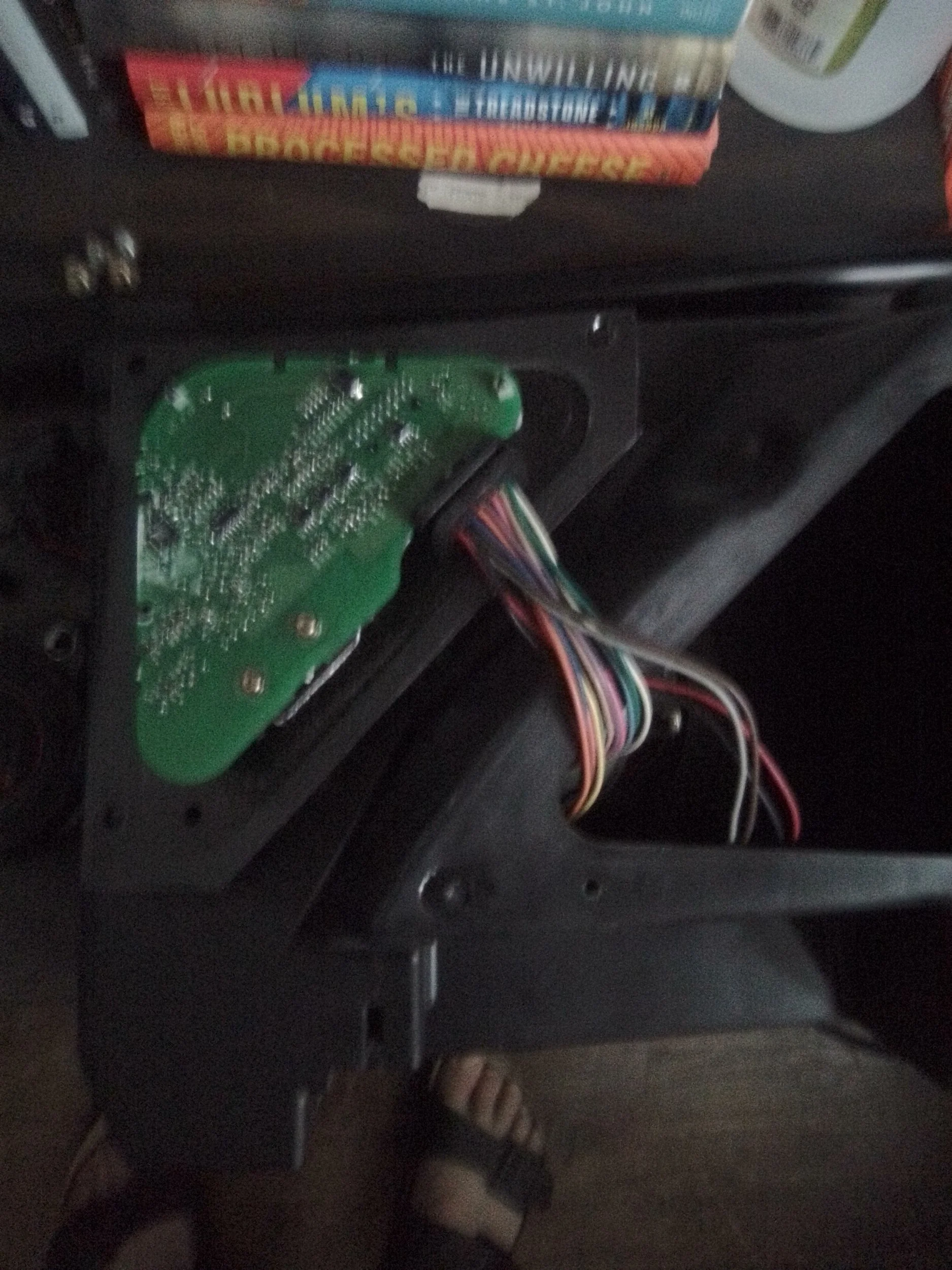

I've a OEM center console with the sub enclosure and a standard center console with the plastic basket I've seen vids of people modifying to accommodate a subwoofer. The end goal is to fit the subwoofer into a Tuffy center console with the sub option. Lastly, is the OEM amp that came with the sub worth reusing? Input be greatly appreciated.
Anyone know how many watts this OEM subwoofer amp is?
The OEM amp is just powerful enough for a 6" sub woofer. Quadratec sells an OEM quality replacement sub, but Kicker makes one that size that is a little better at a similar price.

More, clean power from the HU, and that sub (and I assume stock speakers) sound great - or at least I haven't blown anything yet after a year of using it. I think the OEM amp amplifies the incoming, so in that case, it was worth it to keep it in place - otherwise I'd put a small class D in its place.
