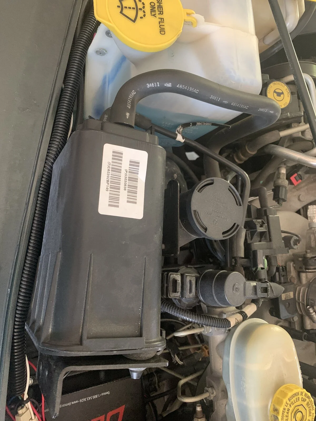

New to the forum and excited about my "new to me" 2002 TJ Sport.
I'd like to add an OEM cruise control with used parts and am confused abut the placement of the servo. My Jeep has a rather large emissions canister and several vacuum lines in the location where I believe the servo should be mounted (in front of the brake master cylinder).
I searched the forum and other sources and couldn't find a picture of a mounted servo other than in the location where my emissions canister is.
Would one of you please describe it's placement in my model, or better yet, post a picture?
Thanks for your help with this.
2002 TJ Sport
Here's a picture of the emissions canister where the cruise control servo typically goes.
Where's the alternate location if not there?

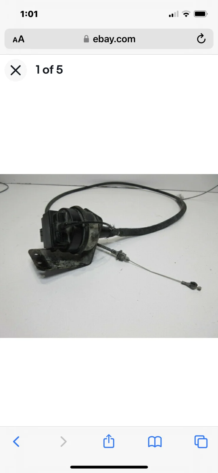

It mounts to the canister,You can use a clockspring from an xj(just have to open up the middle)I have a set of switches for a 2002 when I did mine,if you want them,this is a good deal on eBay
