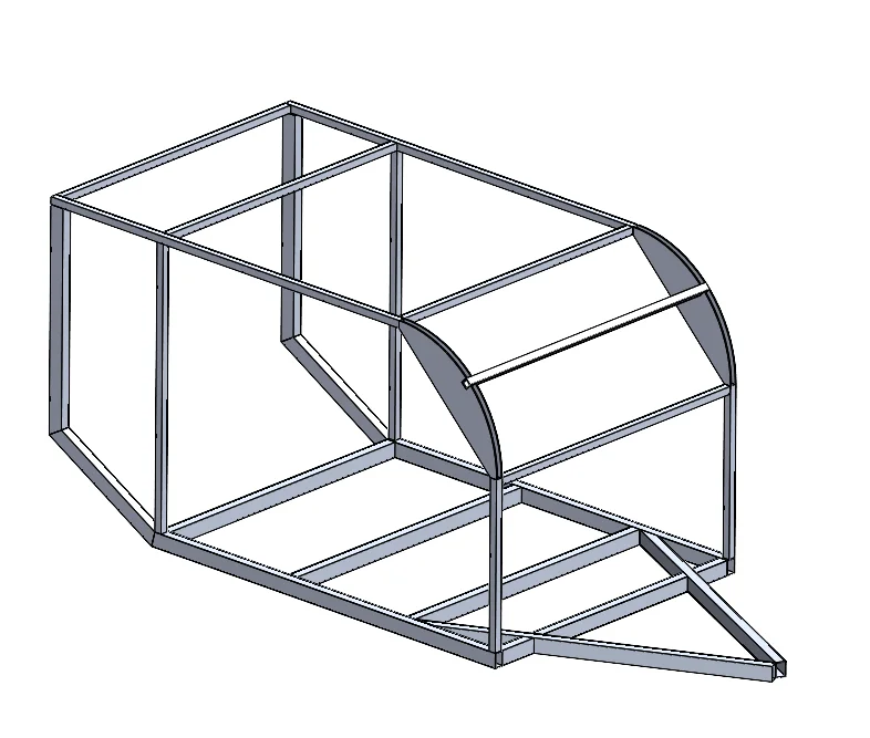

Just starting to put some ideas into CAD. I can model this entire project in not too much time and have a perfect cut list.

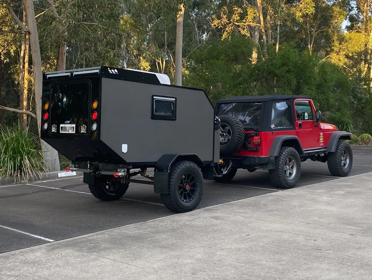

My camper is around 1800lb's and the jeep tows it fine. My camper has all of the bells and whistles (will be getting hot water and shower) but double bed, reverse cycle air con, induction cooktop, 300amps lithium battery, 600w solar, Redarc Redvision etc etc. Everything to do with camping is stored in the camper. We can go away for a week with nothing apart from us in the Jeep.
I had 33's with 4.56 ratios and since I live in a nanny state have gone back to 32's. Frankly it made not a lot of difference without the camper, with the camper the side benefit is that large climbs are nicer with the lower gearing.
I tend to drive with the camper on, around 55-65mph.

Absolutely understand not over building. Actually will be building two of these and will be building as light as possible (likely no heat and ac for now) and do not intend to hit that 2500lb number. That would be an absolutely full unit. I plan to be sub 1,000 empty.
I have began looking how commercial manufacturers are building theirs.

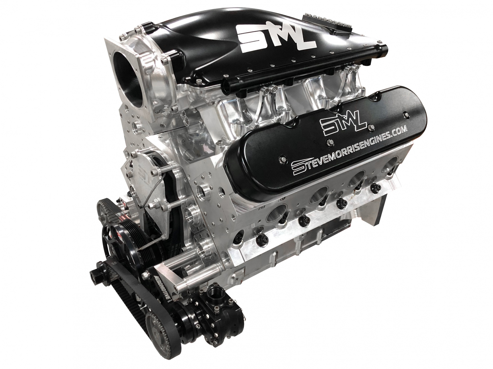

I have a 5.3 sitting on an engine stand in front of my LJ. I have torn into it, need to check bore and bearings, refresh, etc. it’s the eventual plan. Maybe (hopefully) run a TR4050. This will be after my first season with this trailer I am sure.

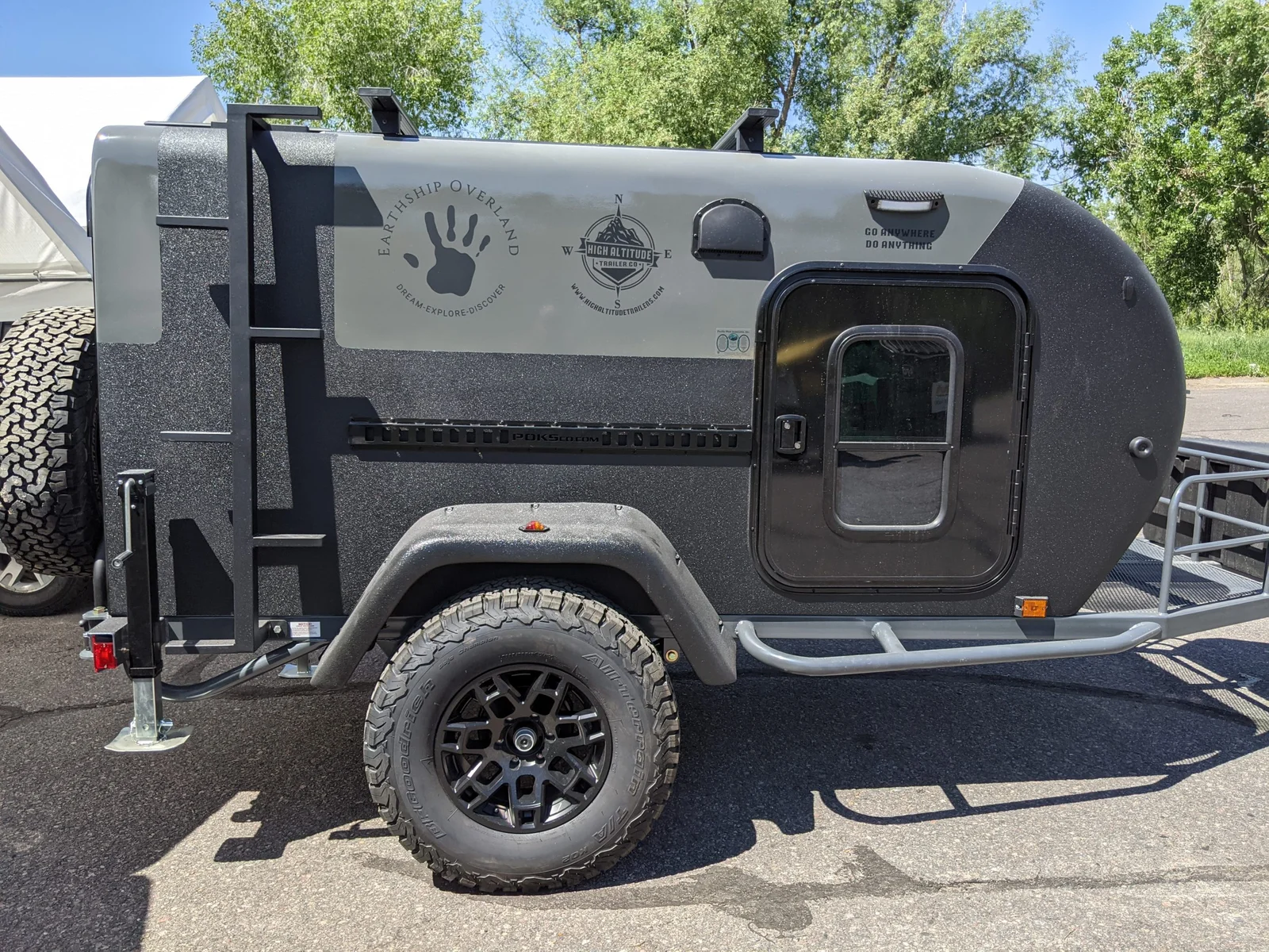

My brother's Off Road camper will be delivered this week. He's running a 2 door JL Rubicon with a 2.5" lift and 35's. As long as July goes well for the arrival of a baby Shank I will be ordering one in Sept/Oct.
The logical plan financially for me is to use the 4Runner for our trip summer '25 (plan to do 3 weeks out west). The reality is the 4Runner is better in every way for travel - at least until I do some significant work to the LJ.

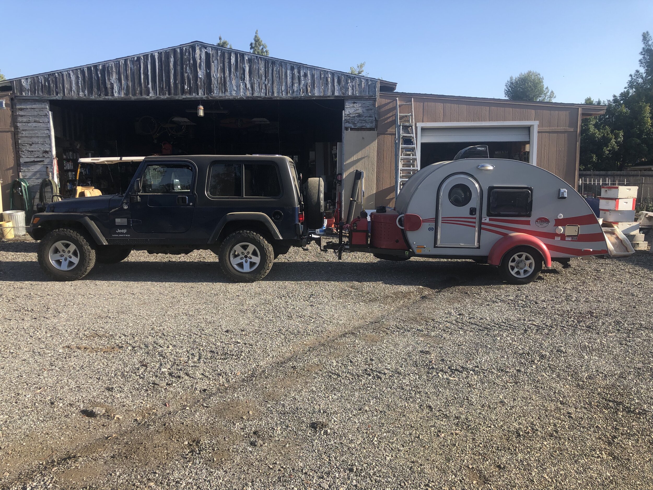

Mine is around 1000# loaded. I have an 05 LJR 6sp 4:10 2,5”lift and 32s. Pulls the grades here with no issues. I will be adding a 2.5” lift to the trailer. Taking it on a 4 day trip to the Mojave Thurs for it’s first trip. I went with a used factory manufactured teardrop because it would take me too long to build one myself. It has composite walls which adds some insulation. Mine has no brakes.
Little Guy. How do you like it and how is the build quality? I haven't much looked at one but doing as you plan could be an option for me - however it seems quite tall. I would think adding brakes to that will be appreciated, especially if you have stock LJ brakes - mine completely sucked.

I have not camped in it yet. I bought it in Fl and towed it back to Ca. I got better milage coming back than the trip there. I took it on a test run with the LJ and went up and down my local grades with no issues. The manual is great for the down grades. Did some stops with no issues but I’ll see this weekend when its fully loaded and I pull some bigger grades. I figure fully loaded I’ll be 400# heavier. Build quality is excellent. I went with a 2015 model because the newer ones have a window in the front which I did not like and new ones cost way more. It’s the same height as the LJ but will be slightly higher when I lift it 2.5”. Drove to the Grand Canyon this last weekend and passed some TJs pulling trailers that were pulling way more than they should and were sagging so much it looked like they had no weight on the front tires.
I am surprised at you mpg findings for sure. I may well have to check one of those out in person. Let us know how your trip goes!
