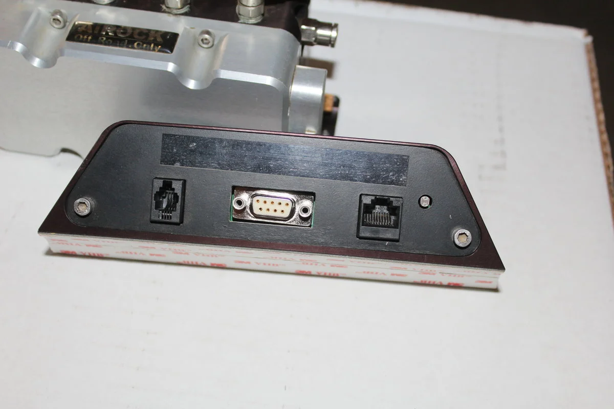

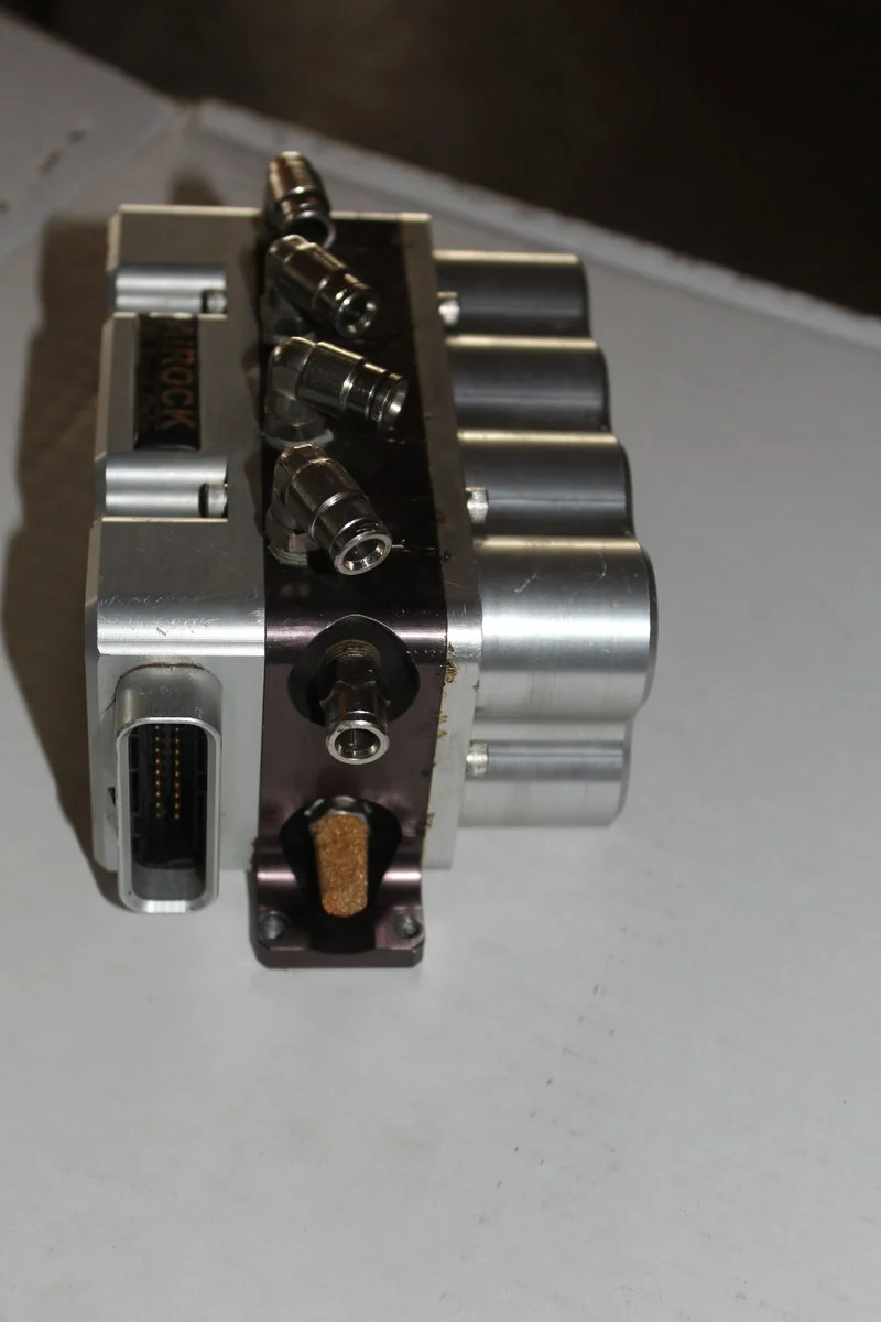

They system is a self leveling kit that is controled by a computer and a dash controller. Under 25 MPH you can be in manual mode and adjust your ride height or tilt the Jeep side to side, front to back & corner to corner. When you go above 35 MPH it goes into highway mode and lowers the suspension down to a preset height and then self adjusts no matter how much weight you have in the Jeep or if you are towing a trailer. It also self levels as you go around corners.

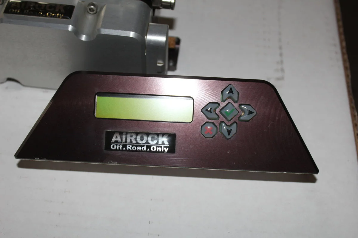

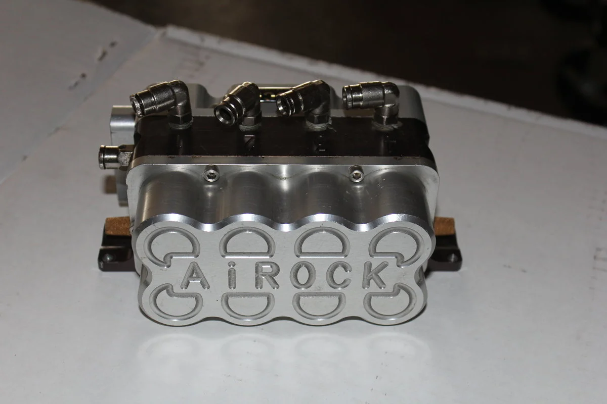

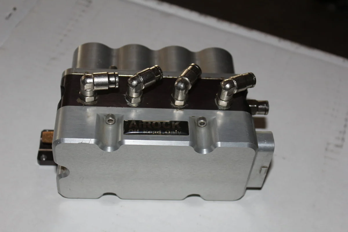

Here are pictures of the computer and air manifold

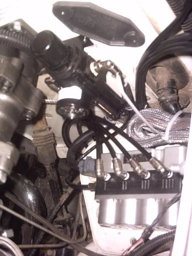

Here is what it looks like hooked up.
Then this is the controller for the dash

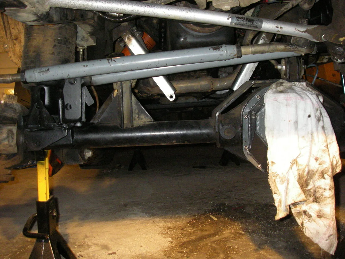

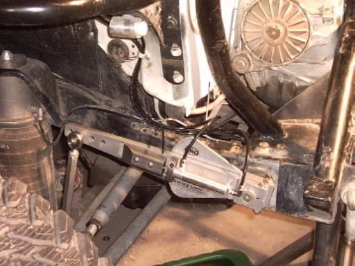

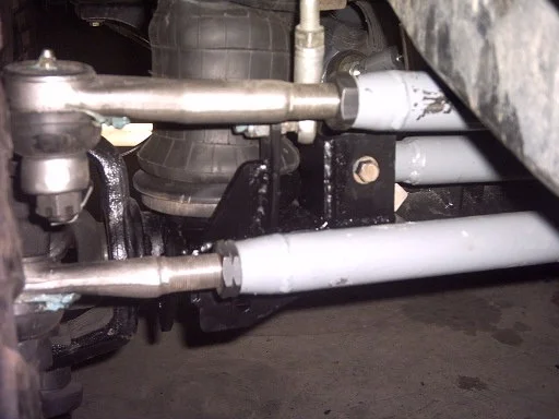

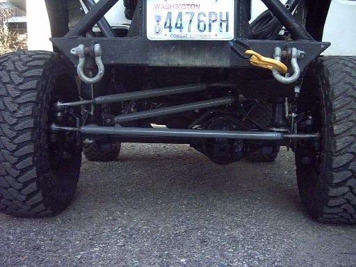

The system uses height sensors to determine how much air to put into each air bag. The sensors are connected to the lower arms of your suspension.

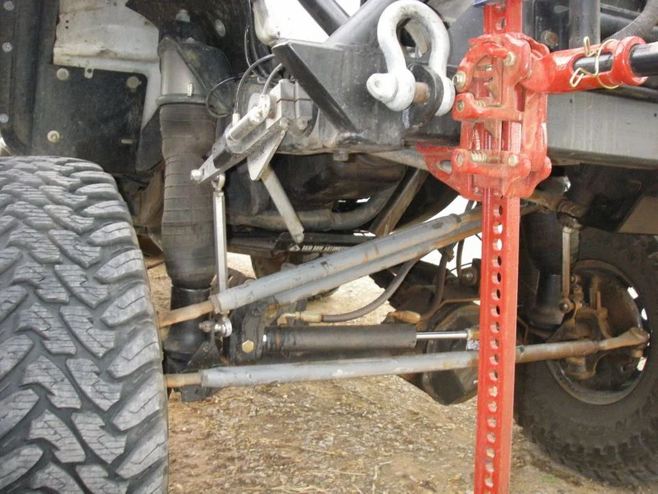

Here is the SwayLoc Dual Rate front swaybar. You can lock and unlock it with the dash controller.

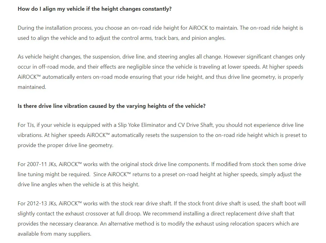

How does the raising and lowering work with the rear driveline and pinion angles? I would think the change would create driveline vibrations.
It is possible to design a suspension that keeps the pinion correct as it raises and lowers. I’m not sure it that’s how they are designed.
Does anyone know the extended and collapsed length of the shocks used? I was considering this kit but I want to make sure I don’t overextend the current suspension or rub the tires excessively. (I found measurements for the old Edelbrock shocks but not the new Radflo shocks)
I made a thread this past spring asking this question is a way. I was trying to figure out how to make the BEST suspension for a variable height suspension. But it was decided that since it rides at about 4" of lift off-road and at 3" of lift on road it wasn't a huge deal. I've never noticed any driveline vibrations with it but I do have a HP TeraLow CRD 60 rear axle.

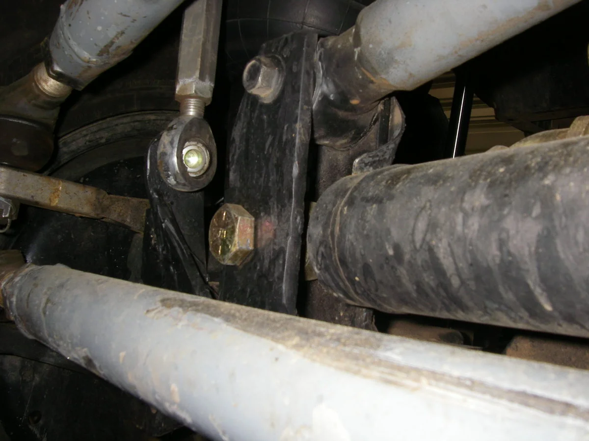

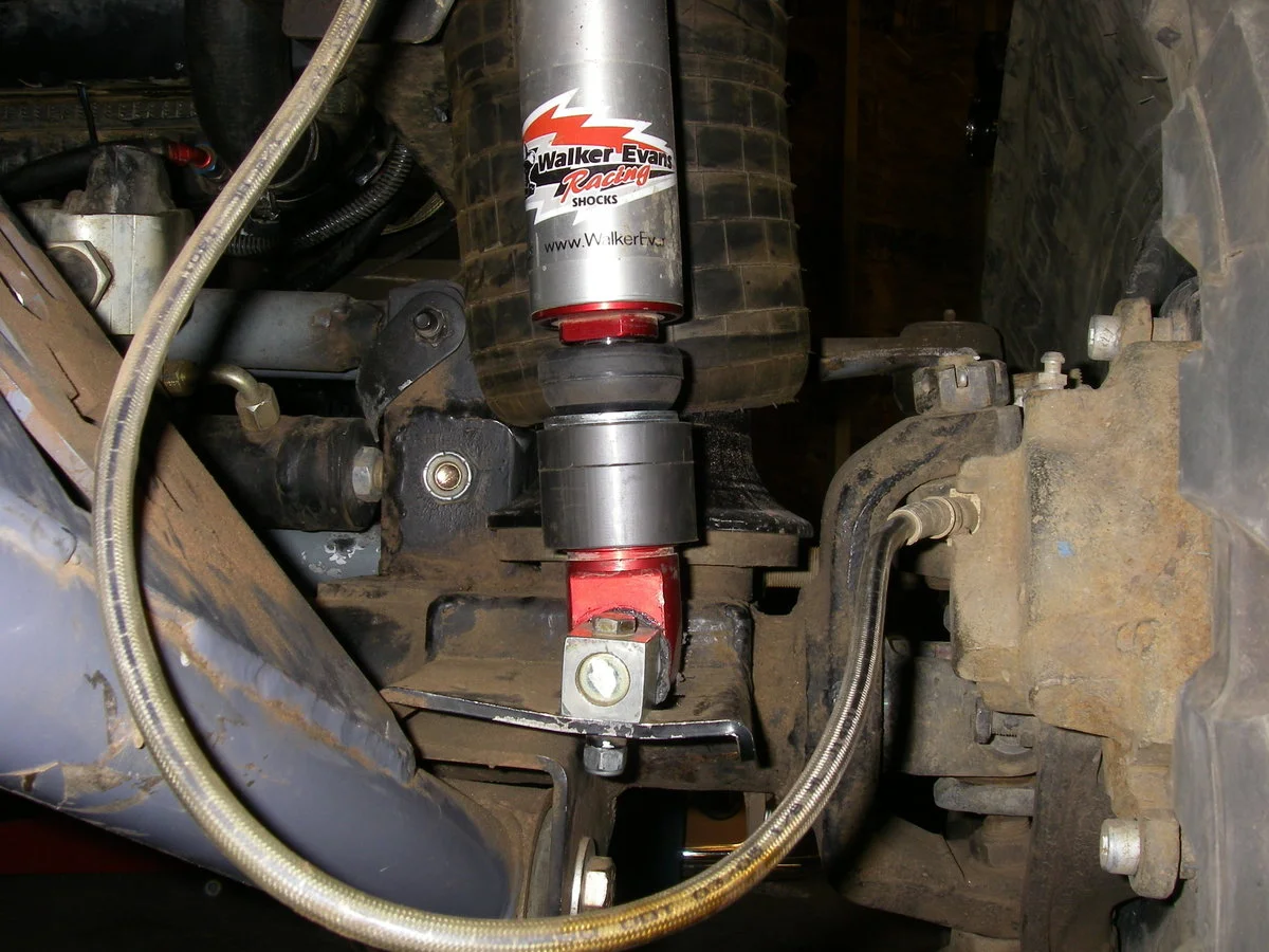

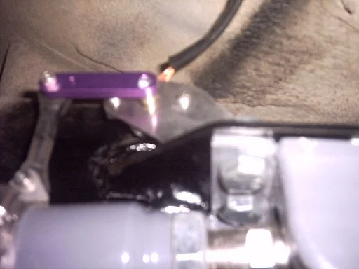

B) You have to make sure you have clearance of the air bags since if they rub on something they can rip or a hole worn into them. You also have to make sure no sharp edges or parts come into contact with them.
I've unfortunately had to replace TWO air bags.

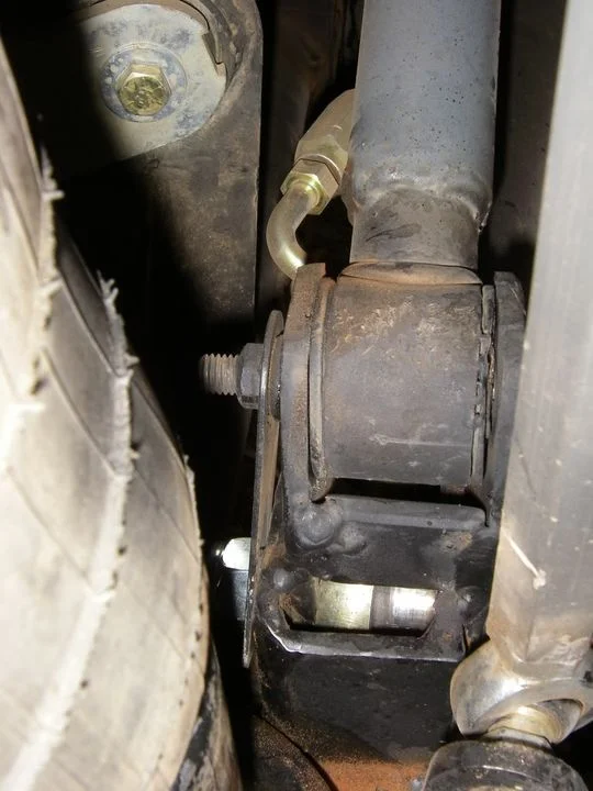

The first one I rub a hole in it when I had moved my track bar above the axle and didn't radius the bracket so it had a sharp edge on it.
So here is the damage it did to the bag. It doesn't leak but I fixed the mount and then put a new bag in place and kept this one as a spare.

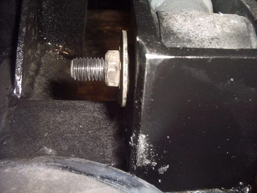

The second time was EVEN more of a FUBA. I had used one of this winged nuts that come with the stock suspension and didn't turn it so it couldn't rotate. And I was in Moab out on a trail when I cut it so had to limp back into my camp ground and then overnight a new air bag becasue I had left my spare at home. Steve (owner of ORO) took great care of me and even put me in contact with another Jeeper who was in Moab to help me out.
The suspension cycling up and down made it rotate and sliced right thru the side of the air bag. Dumb mistake but live and learn.
So I bent the wing over so it can't move again. I don't think I took any pictures of the sliced air bag.
Changing out the air bag in the campground in Moab.
If you look at the other pictures you can see how it rotated and cut the bag.

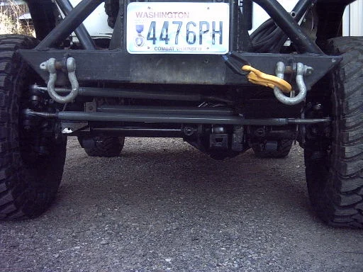

To give you an idea of how much it will raise and low here is some shots from the front.
Fully up
Fully down

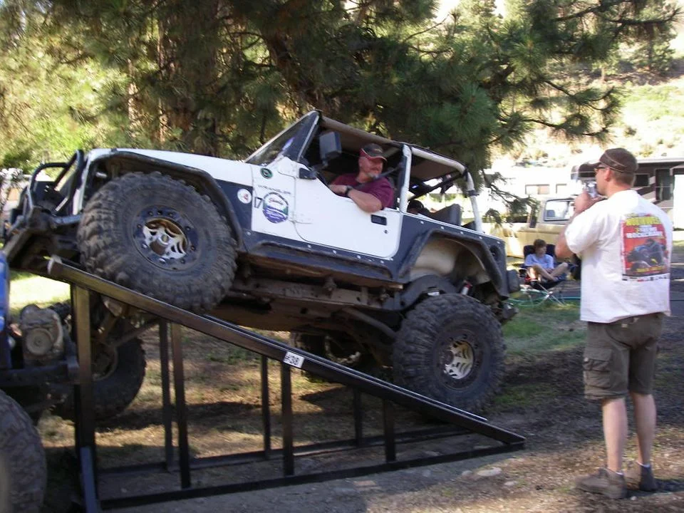

I went from 35" Toyo MT tires to 38" TSL Super Swamper SX tires and here is picture of me flexing out on a 30* ramp. Scored a 1100 on it.

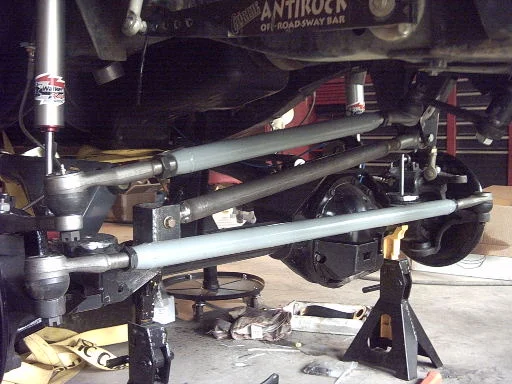

On stock Y-link steering, toe will also change along with the changing ride height. It seems like "highway mode" would be the height where toe, caster, etc would be at their optimal settings. All other ride heights would be compromised.
Correct. And that’s also why I believe their kit gets rid of the Y link.
If it was my DD then yes I would agree with you but this is a 75% trail rig and 25% on road rig. I've never noticed any issues with steering BUT I do have hyd assist also.
The U-Turn is still crossover steering that disrupts the track bar/drag link relationship unless the track bar also gets moved.
