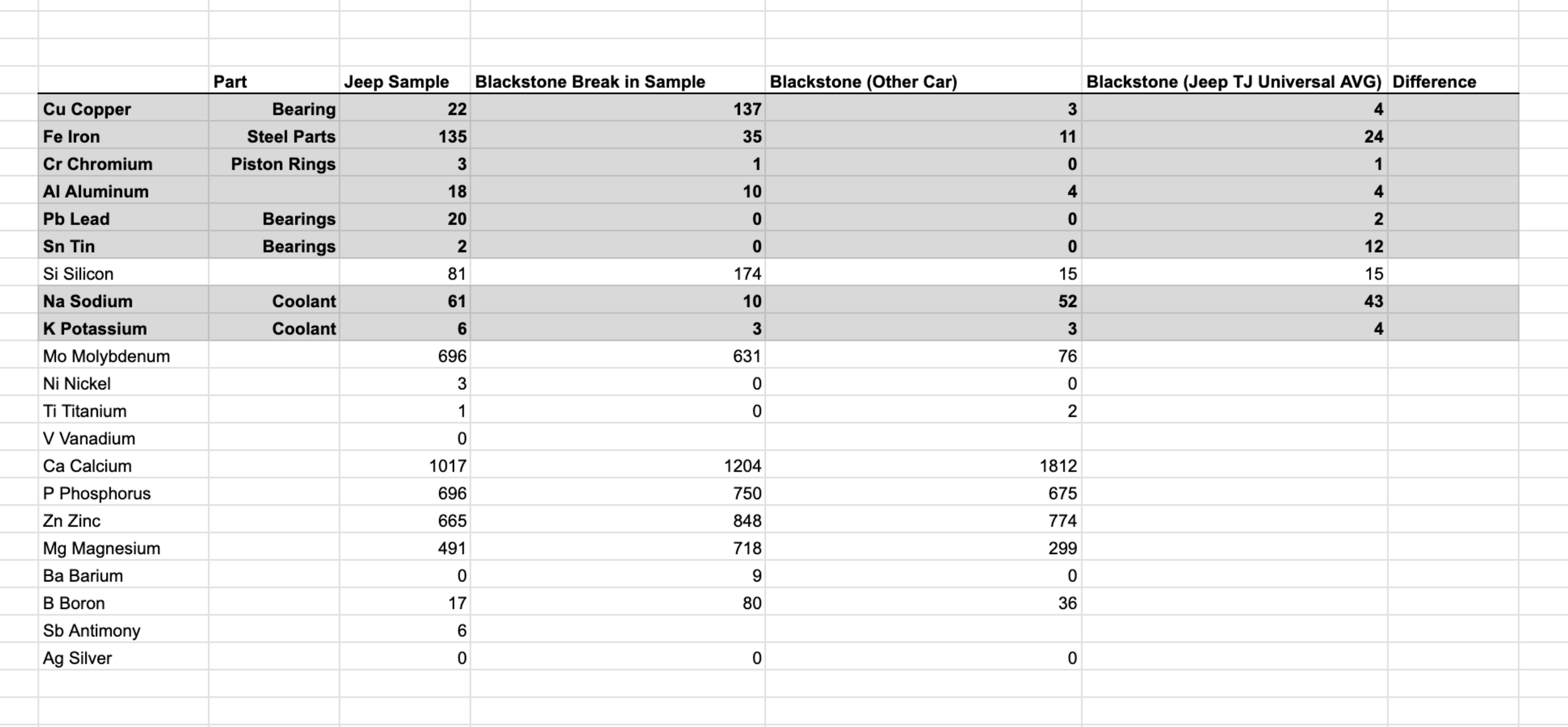

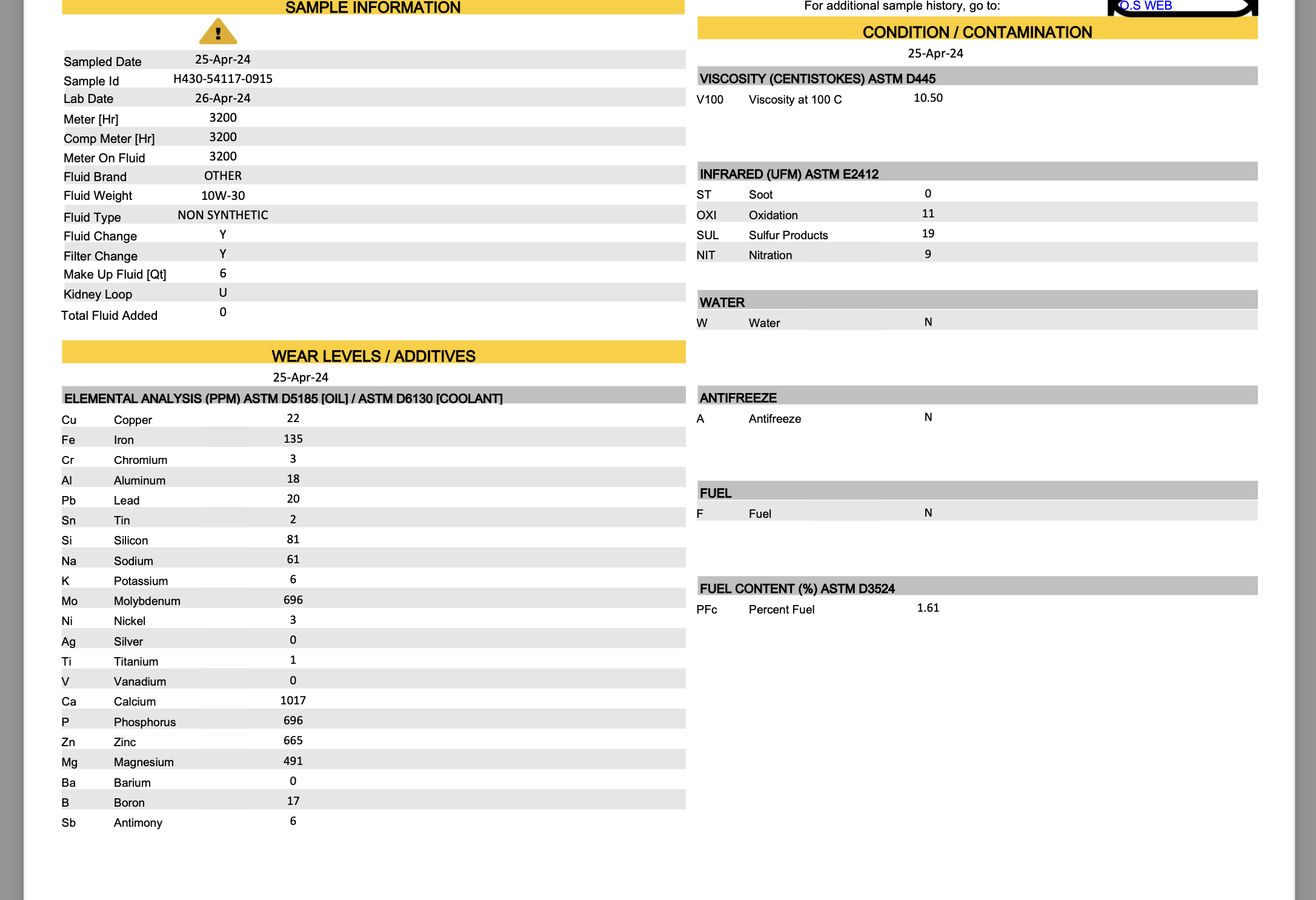

This is on my second oil change at 3k miles. My first oil change was at 500miles.
Engine started ticking after like 10miles. Gets louder when accelerating and doesn’t go away ever.
I gathered some data from blackstone to compare. I also sent my sample to blackstone but they got a 3-4week turn around time vs CAT’s 2-3days
I’ll post black stone when they get back to me and update this thread. Or maybe I won’t and just move on
