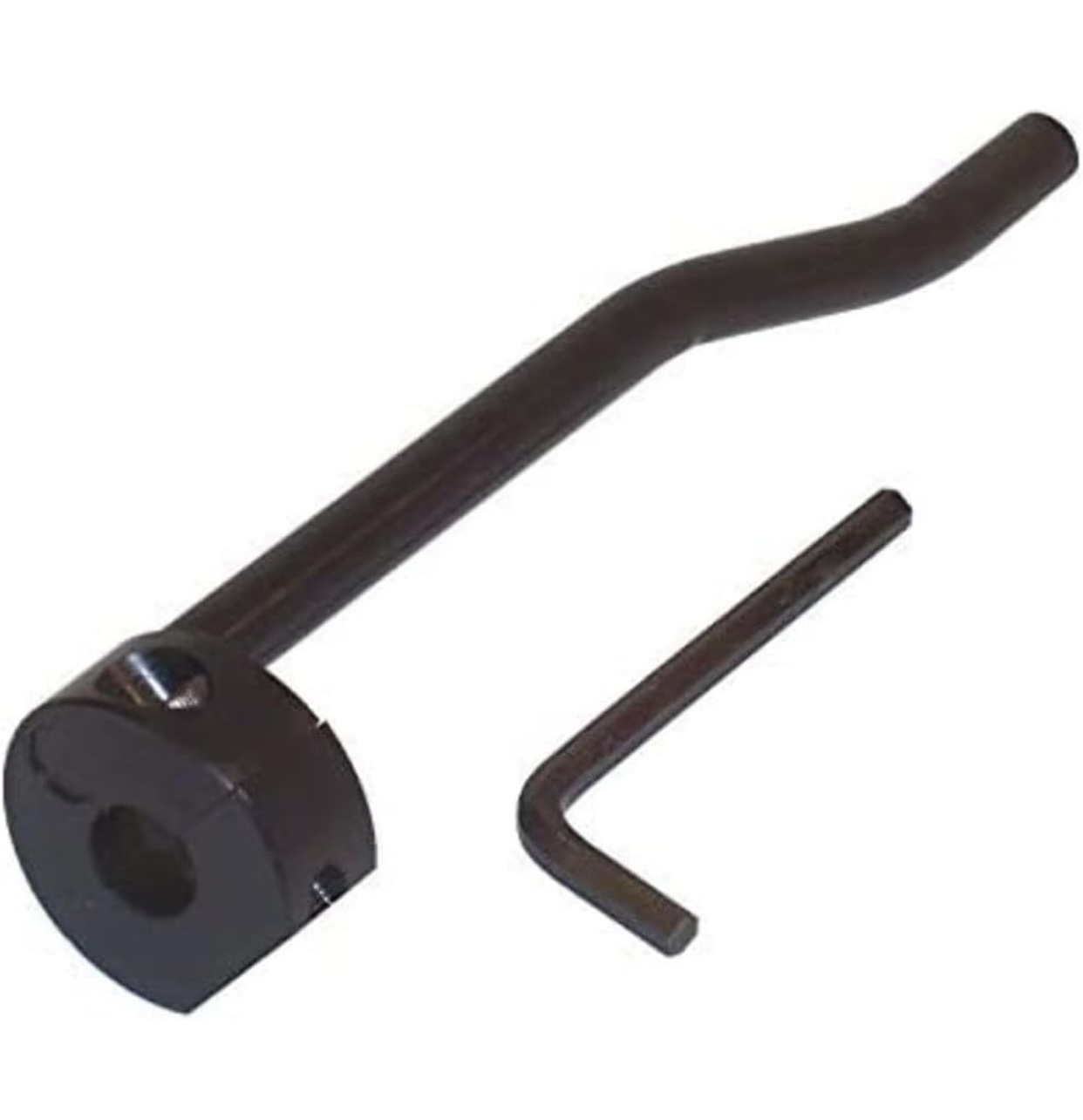

I think because of the shape of the tube, there’s a tool made to install it easier. I’ve seen this on Amazon. Kind of expensive but looks like it could be DIY’d if you have the means.
Melling MCAT-62 Oil Pump Screen Installation Tool https://www.amazon.com/dp/B004A69QI2/?tag=wranglerorg-20

Thanks Tom, so a special tool is required, thanks for confirming, for the price of the tool I can replace the whole pump.
I’ve never done the job, but I don’t know that it’s required. Probably just helps keep things lined up and straight when you’re tapping it in.
