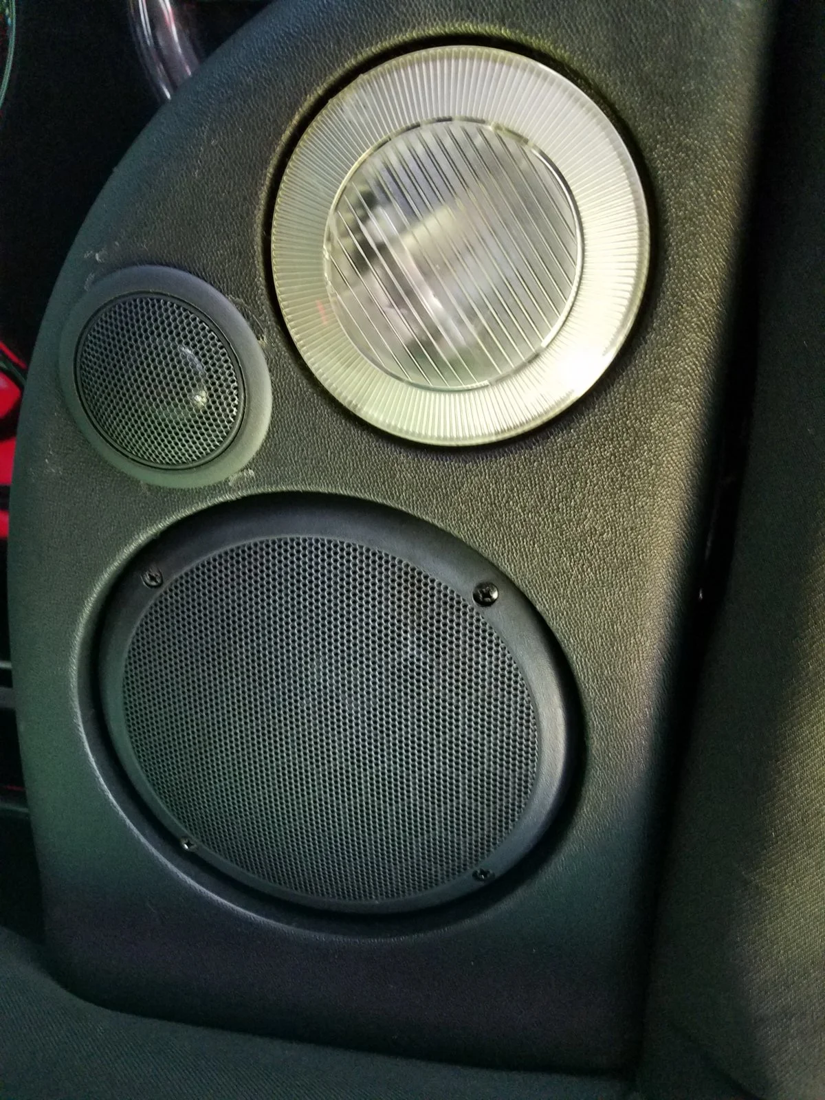

OK, I got the Kicker amp installed last night. What a freaking pain in the ass. Installing it was easy, but I kept getting an error when trying to run the calibration. It was an error for the ambient noise being too high. I tried running it at least 25 times. The only thing that finally worked was running the pink noise needed for it to tune, through my phone connected directly to the amp. I have no idea why. I had already requested a return from Amazon because it seemed defective, before I finally tried that.
Well, anyway it finally ran and sounds good. The amp is pretty powerful as the system is pretty loud. I wasn't sure if 45w x4 would be.
I posted a video on youtube. Audio quality isn't outstanding, but decent. It does sound cleaner and less "thick" in the bass than the video, but just to give an idea of how well those Tang Band modules and Dayton woofers work, I recorded this. The power sub is on as well.

Most people don't even think about it, but not all speakers work in every application, just because they fit. I chose the Dayton's for the dash because the QTS was high and they work well in large enclosures, or infinite baffle setups, more along the lines of my sealed front baffle dash setup which is kind of infinite baffle. They wouldn't work well at all in the smallish sealed enclosures of the sound bar, but the Peerless woofers should as they are designed for small sealed or ported enclosures, but the Peerless would not be good in the dash.
Most car speakers are designed for large leaky enclosures like doors or a trunk. They work fine in the dash (if the baffle is sealed), but not too well in the sound bar because the airspace is limited. That's why I don't recommend people get those tiny sealed pods for the dash. Most speakers put in them, don't want to be in there, and perform poorly.

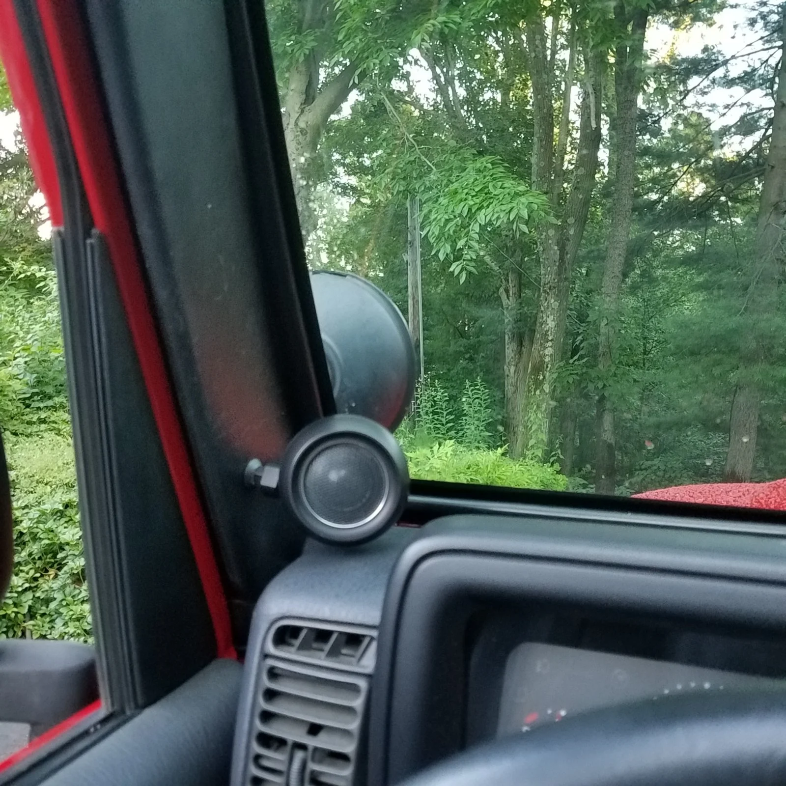

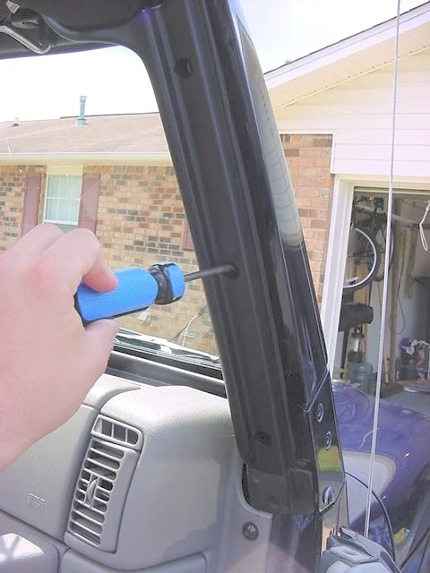

How do they attach? Are the a-pillars different on the 03+ to be able to attach them?
Have these in my '05, and I'm actually interested in swapping to the older style. Pretty sure it is a direct swap on the sides, but these newer panels run up and across the top of the windshield as well. I don't know if my newer windshield frame has additional holes for clips across the top. You may need to do some drilling, but I'd consider swapping if you're serious.
