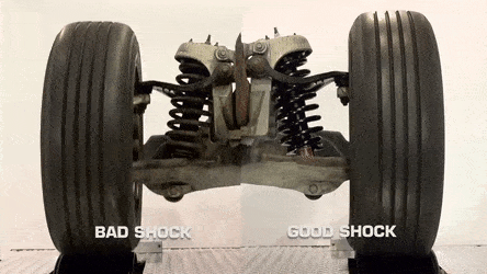

That's the springs' fault. The "female" spring is on the left, making all sorts of noise and never shutting up. The male spring (on the right ) is simply being quiet, tolerating her, until he finds a less noisy, better riding version with much less miles on her.....uh.. it. Sorry honey, if you hacked my account here. ;)
